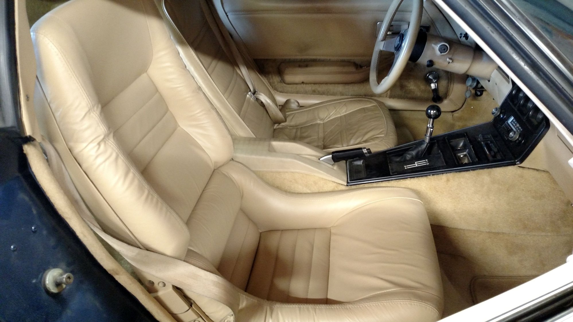

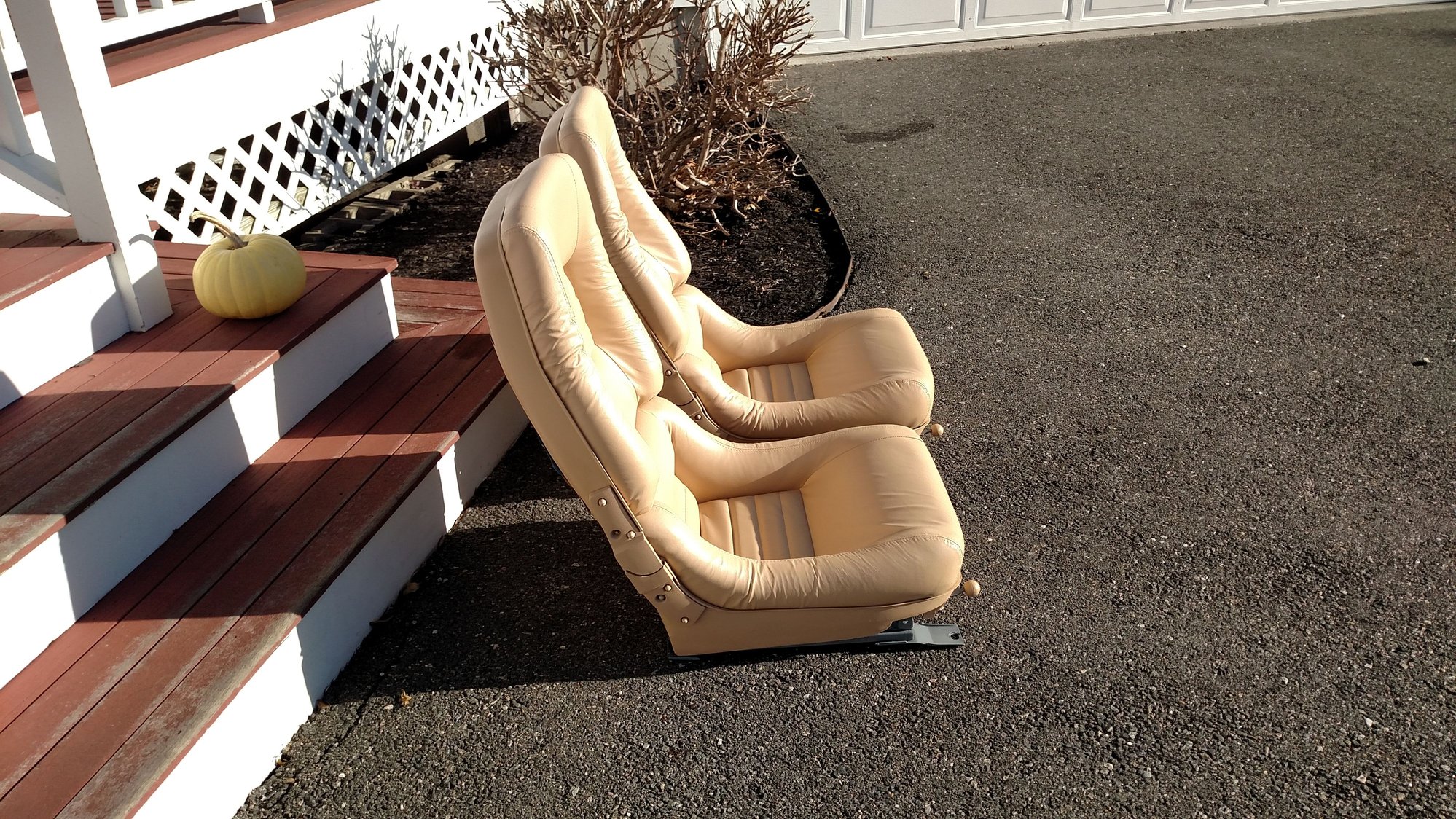

That's was the ticket for me. I bought mounted seat covers from Willcox about five years ago and installed them myself into the clamshell buckets. Removing the old seat covers wasn't too much trouble, just a little wrestling with them. However, I simply could not install the new seat covers into the clamshells until I cut a notch into the middle of a flathead screwdriver, like that described above by Gunfighter13.
I used a Dremel to cut the notch out, which easily cuts into the solid steel of a screwdriver tip. Once I had that special tool fashioned, installing the first mounted seat cover became remarkably easy and straightforward. I then moved to the other one and, again, virtually no trouble at all. Just some pulling and tugging, as mentioned above.
Originally Posted by jb78L-82
I got mine from Willcox as well a couple of years ago..bought 80 clamshell seats to replace the 78 seats for $200 used complete, locally, deal of a lifetime on these seats!. New Cushions and what a difference..
Beautiful work! That is exactly what mine look like now.
