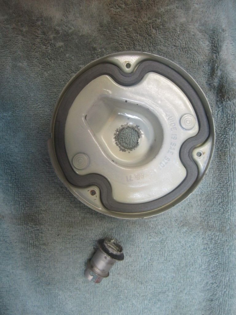

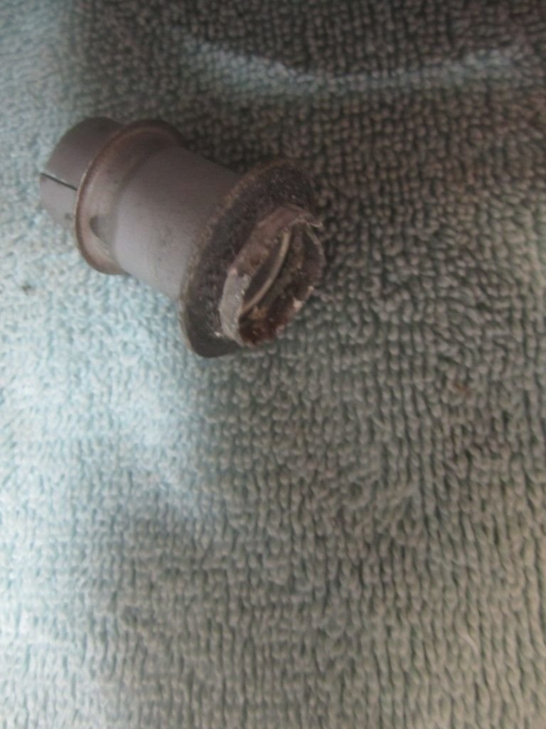

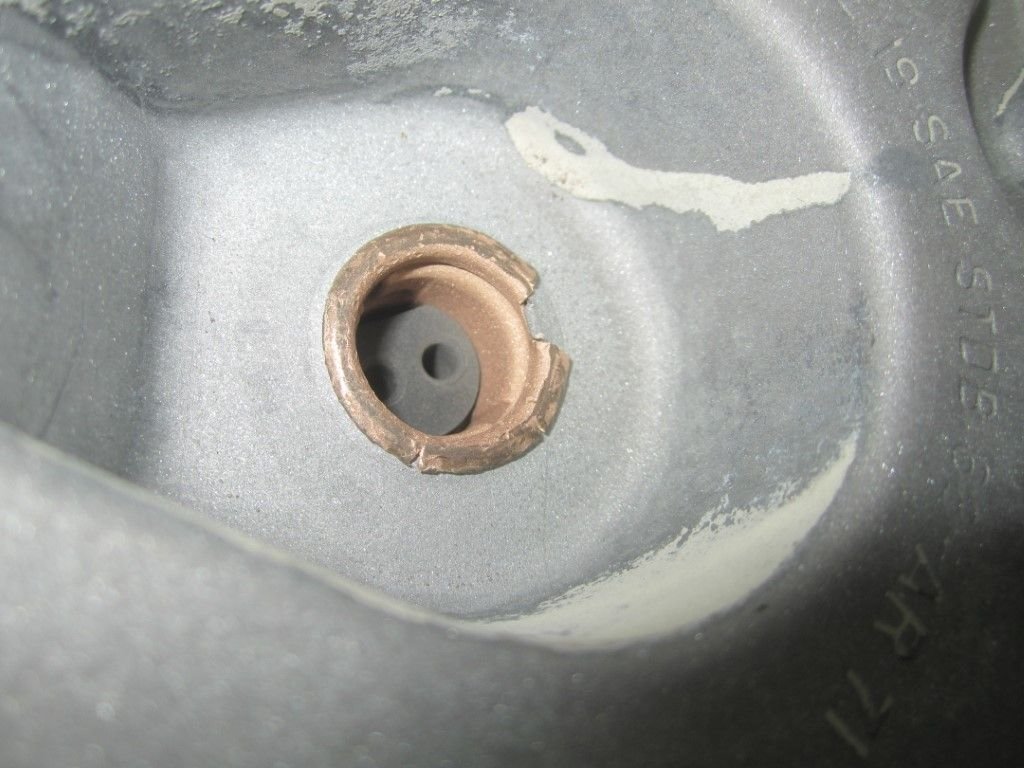

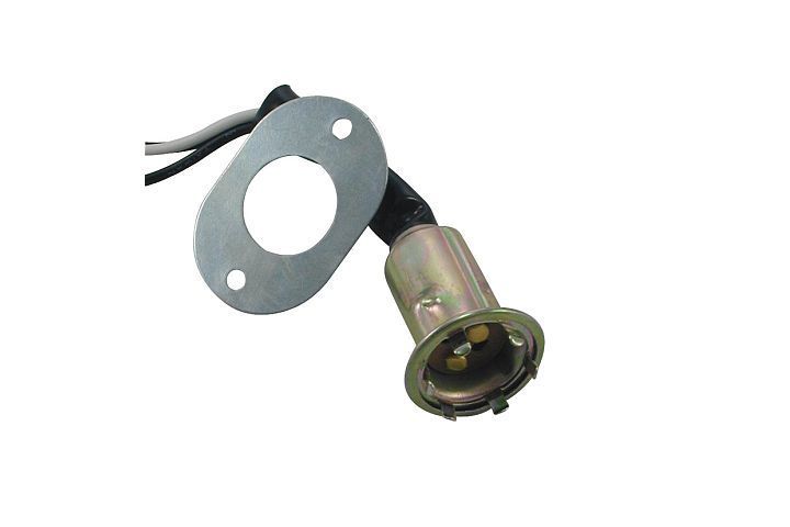

When I did the 4-light conversion with rings, I used my stock pots rather than looking for a second set of brake / turn ones
The holder is staked into the housing but it's soft and you can use a flat screw driver and work your way around the inside to un-stake the holder a little at a time until it comes out, most are split somewhere around and that edge is the best place to start lifting the rolled over bit
The replacement 2-contact socket I used was from a box of salvaged parts gathered over the years so I'm not sure what it was actually off of, maybe a pickup or ???, check NAPA for a repair one that clips in or hit the wrecking yard / flea market for ones that are staked into metal housings that weren't accessible from the back side rather than clipped into plastic ones that were changed from the trunk
Installed the new one and re-staked (ready for re-painting, stripped paint to make sure it had a good ground on the socket)
and re-wired, (need the extra blue and white wires for the LED ring parking lamp)
So anyway, not much help but changing the bulb holders is fairly straight forward

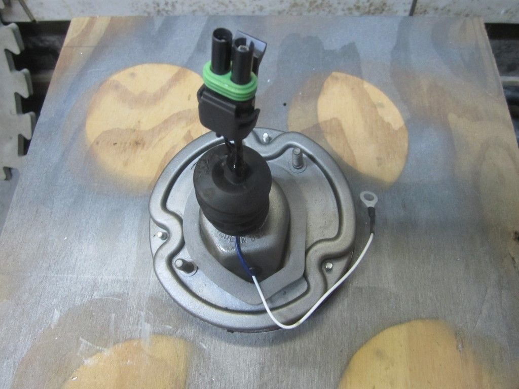

Hey Big Eddie! Why swap sockets? I posted on this a while ago. all 4 lights are bright LED brake lights, and directionals are two at a time. Backup lights are under the license plate.
Copied from my previous post:
I decided to mod my the taillights and reverse lights on my 69 to four red lenses and a relocated assembly under the license plate . Have a look.
This wasn’t as easy as I thought it would be. My rear harness has the 1157 filaments swapped, side-to-side. I do not know if all 69’s are like that, kind of hard to tell. It wasn’t very noticeable with incandescent bulbs, but converting to LED’s, the brightness difference bothered me. Being moderately OCD I needed to fix it somehow without digging into my rear harness as I have a fuel pump in the way on the dim side that I didn’t want to touch. Solution was to reorient the LED by filing off one of the bumps and inserting the bulb 180 out. It’s worked out OK even though it’s not fully inserted.
I left all the original receptacles in place, so the 1156 and 1157 sockets remain. I jumpered into the outer lights to control the inner lights. All four brake lights light up when the brakes are applied. The directionals are two at a time on either side. I don't normally drive at night so that circuit is still the same, the two outer lights.
The 1156 and 57 replacements are equally bright and I figured the photons might as well be red like the lenses. Color artifacts from the camera don’t do the picture justice so I’ll leave that picture out. But they really are bright and more importantly all four are really noticeable.
The reverse lights are an acrylic piece that I cut and polished to hold two SuperBright multi-mode five LED light bars. They have about 20 different flash modes and can be synchronized. I picked a simple mode and left them unsynchronized. You can see a reflection artifact briefly in the video.
The surround is some aluminum bar stock that I bent and polished. The flag is a modern variety that fits very nicely after cutting off the engine logo that it came with. Got it off eBay.
I took some pains with the wiring, that took most of the time. Have a couple of WeatherTech connectors so if the LED’s fail I don’t have to cut any wires to swap the assembly out.
