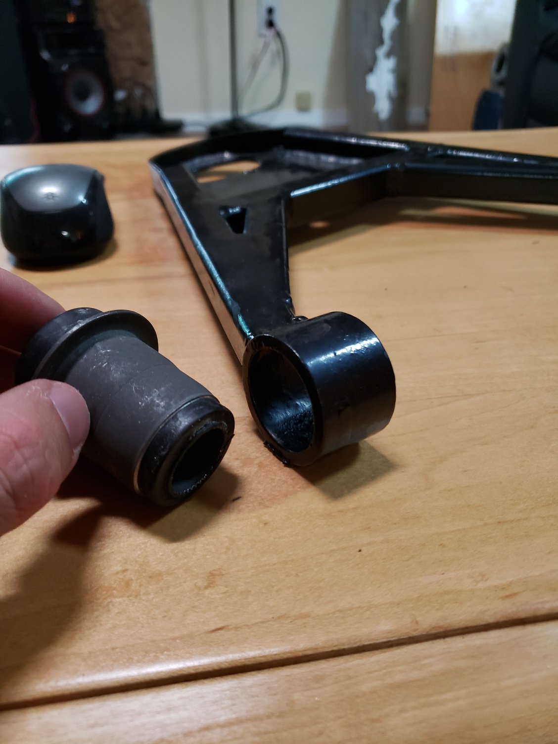

Heres the control arm and a new bushing, the old ones got thrown away before I realized this would be an issue. As you can see, the sleeve cant even be started. I am 100% sure the old bushings did not have an outer sleeve.

Those does not look like the original control arms.
Original are stamped steel, see below.
/Johan

Not to long ago someone was looking for VB&P replacement control arm bushing, there were NO sources IIRC. Those look like VP&P arms...sorry.

Talk to Vansteel as they might be able to provide some guidance.

Also, a handy fellow with a small lathe could turn some Delrin bushings.

You should measure the ID of the control arms and then do some online research for control arm bushings that meet the same dimensions, width wise as well.
Obviously you have some non factory arms so using factory parts isn't always going to work. Time to fabricate or find another source for bushings.

Subsequent googling agrees, they don't exist any more. Thanks for the help guys, now im off on a custom bushings adventure

I'm very happy with my SPC upper control arms ($200- per pair, all day every day on eBay, I have the greasable "race" versions). You will need to rebuild one to be the mirror image of the other one, but you can then adjust camber and caster without using shims.
Something to think about, if you can't find bushings.
