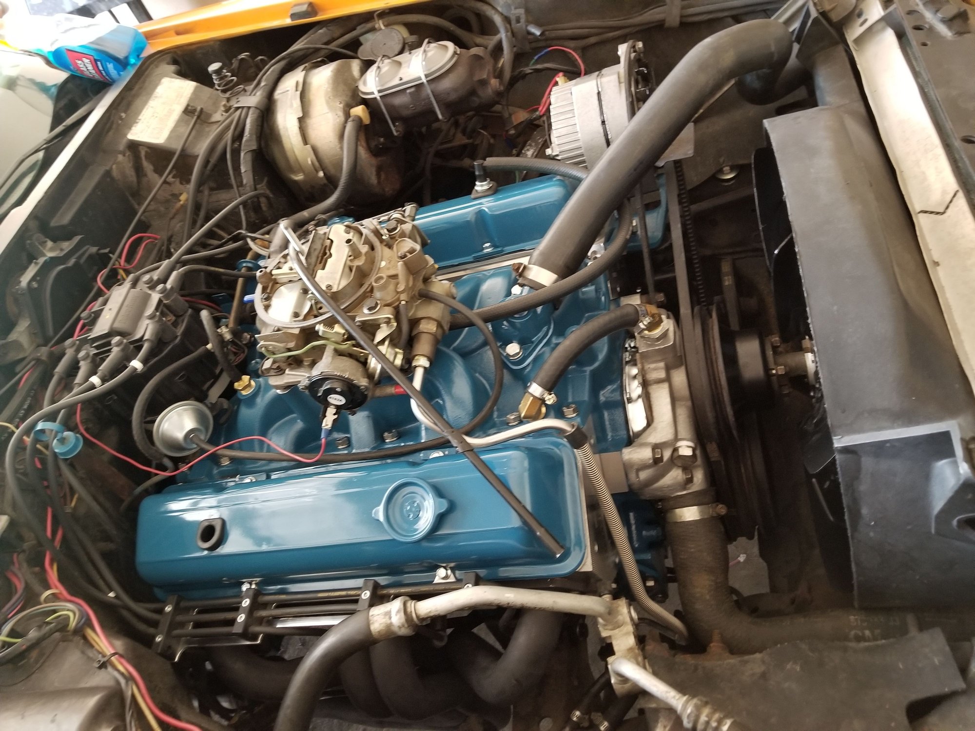

Hi All,
I wanted to document my experience with a crate motor company called BluePrint Engines. (I have no affixation with BluePrint nor do I have any financial interest with the company.) I live in NYC and had engines rebuilt by local machine shops. The problem with the local shops is they tell you more of what they are not going to do than what they will do.
My 1975 350 motor developed a blown gasket. The choice was to rebuild or crate motor. I opted for a crate motor with a little more hp and in the future rebuild the numbers matching motor. Manufactures came down to GM Performance or BluepPrint Engines. All others I contacted were more the sales pitch or warranty definition than anything else. Felt like they were protecting themselves and I hadn’t purchased anything. GM Performance has the history and prestige but I could not get in touch with anyone. All my calls were answered by a machine, and to be honest I was not looking forward to dealing with the stealer ship mentality.
Read a lot of negative complaints and warnings about BluePrint so naturally I was very nervous. I contacted BluePrint and was amazed that there was no sales pitch. They answered every question no matter how simple or complex without that old your not buying, and your wasting my time attitude. (I asked an average of 4-5 questions per call per day for 7 days straight.) I got better customer service in one phone call than all the local machine shops and other companies combined. (Think about it, I hadn’t purchased anything yet nor gave any hints that I was going to.) The nail in the coffin was the warranty. Finally I bit the bullet and worked with Ken to create a motor that was perfect for my needs.
The motor arrived, and immediately I was annoyed, not at the motor but the delivery company. Delivery man was leaving the motor in front of my gate and not in the drive way. He told me it was a sidewalk delivery. I had to get firm to have the motor put in the driveway.
The motor came in a sturdy wooden box concealed in a thick plastic bag. After opening, the motor was absolutely perfect. Not a scratch, ding, mark, not even dust. I was amazed at the attention to detail, no paint overspray, all spark plug wires were labeled, all bolts torqued correctly. The exhaust ports were even covered with paper seals labeled BluePrint. A graph even came detailing the engine performance on the dyno complete with technician name. (Unbelievable). I did have a complaint. The motor comes with a flywheel but not installed. I have a manual trans and a manual flywheel is not included nor is a pilot bearing. (Just my opinion but I think it would be a better experience if it was.)
Installed the motor and performed the pre-lube process using BluePrint break-in oil without any issues. And yes the oil color was blue! Started the motor for the first time and saw the oil pressure drop from normal to 0. Naturally I pacniced and immediately shut the motor off. I thought the oil pump was bad or the engine itself. After looking around I saw a small drip of blue oil on the floor. I thought what kind of crap is this. Upon close investigation the oil pleasure switch (transferred from my original engine) was bad. The wire came off and it was leaking. After replacing it everything was perfect. (Sorry BluePrint) I completed the brake in process with no issues at all. I can honestly say the motor is absolutely perfect, no ticking, knocking, oil pressure or vacuum fluctuations etc.
I have to complete the next step in the installation guide which is timing, but I have a few questions before. (I’m not risking the warranty.)
I must say it’s so refreshing to work with a company that stands behind their product and most of all the customer. Now they will not honor things that are your doing like not following the instructions or guidelines. (No one will). My advice is study the install guide, warranty, and web site before you do anything.
I remember reading in forums where someone was complaining about their purchase and the company exec replied with assistance. I say really think about it, the company exec steps in on a forum to assist. (What exec has ever done that!). This company is 100% top notch, no nonsense, no bull, no double talk. Will I purchase from them in the future or recommend to others? You better believe it I will. “Without a doubt or hesitation.” I got better customer service in one phone call than all the companies and local machine shops combined. Other companies can take a lesson.
I’ll update with the next process timing shortly after I ask another round of questions.

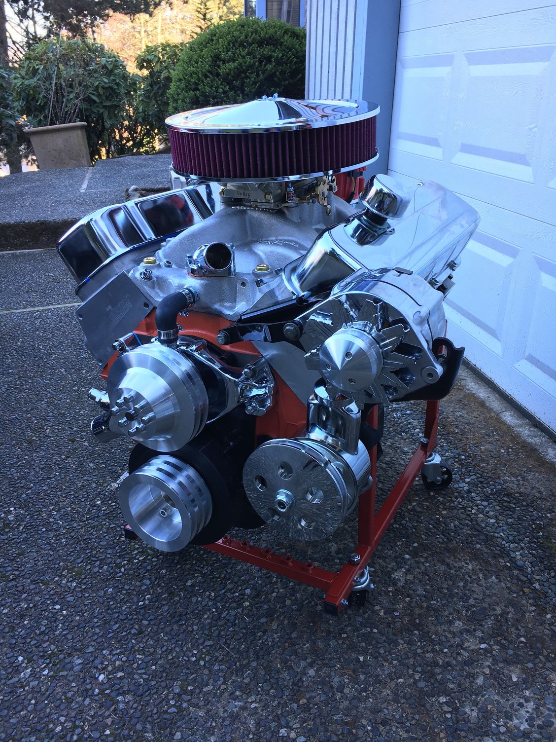

I had them switch out the intake manifold for a Performer instead to reduce the engine height and drop the max power rpm. The engine arrived and (luckily) I had called ahead and read that they would not (FedEx) bring it up my drive way which is very steep. So I made sure I had my brother over and I slipped the guy a $20 and the 3 of us easily pushed it up into the garage. No problem. The engine was beautiful and aaaaaaaaaaaaaaaaaaaaaalmost perfect.
I will suggest to anyone ordering from them to go over the specs on the web page in detail. The specs on mine were wrong in 3 places: 1) It was a 1 piece rear seal, the page said opposite (I caught that one early), 2) It did not say it was a Mark VI block (which is a better block) which caused 2 problems. It didn't have the hole for the nub for my manual clutch Z-bar and it did NOT have a hole for a mechanical fuel pump when the web page clearly said it did. So I had to go to a hydraulic clutch (which looking back was expensive but a great improvement) and an electric fuel pump which BluePrint reimbursed me for. So they at least stood by it. Just make sure to clarify all the points so you know exactly what you\re getting.
It started right up (3rd crank) and ran well. Everything checked out. Since then I have about 2500 miles on it. It runs like a bat out of hell! One change I have made is that I switched over to the Holley Sniper with all Hyperspark ignition. I did it because of vapor lock, ease of starting in all conditions, and smoother low RPM cruising. I see that you can get them with EFI now. Sweet!
