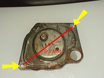

I own the clock core in the photos below -- my understanding is that it is the 1968-71 model. I no longer need the core and I wanted to sell it, so I posted it as fitting not only 1968-71 but also 1972-76.
The person who bought it owned a 1973 Corvette -- he returned it to me and said that my clock was too small. I thought perhaps he didn't know what he was doing so I offered it for sale again and it was returned again by someone else who said the same thing -- that my clock was too small to be compatible the 1973-76 model.
As you can see in the photo below, the distance between the two mounting holes is roughly 93MM. Is that the standard distance for all clocks during this period? Can you think of any reason why the clock in the photos would not fit in a cluster for a 1973-76? Is there perhaps a second version of the clock for that period of time, similar to when 1969-70 Mustangs had both Deluxe and Standard clock options for the same model year?
Any suggestions would be much appreciated.
I have plenty of both clock cores in stock.... I'm not aware of any mounting hole variance in the clocks to the dash bezel. The issue is I can't check this for over a week, I'm 2200 miles from home right now. If you send me an email reminder after the 5th of July I'll check this for you but I really don't think there is any difference.
