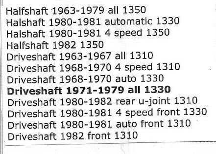

Default Does this help?
Originally Posted by Novusuhu
Hey everyone
Next week I will be in the US (Georgia, Atlanta).
I have a 77 automatic L48.
What U-joints do I need? (Will replace al ujoints...how many different ones do need... I never replaced u-joints).
The parts don't need to be 'original'.
It has to be premium quality.
(Part numbers or links please)

two on the driveshaft and 4 for the rear half shafts. The driveshaft front and rear appear to be 1330 type and the half shafts are 1350 type.
