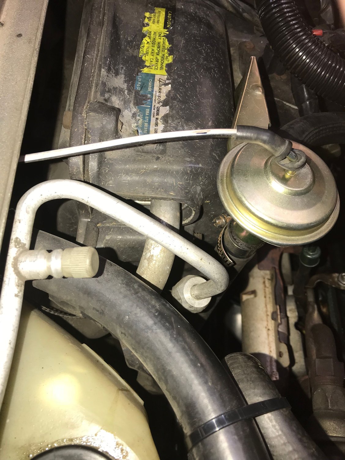

Where is the orifice tube located?

The orifice tube is inside the high pressure fitting next to the egr valve, just before the line enters the evaporator
