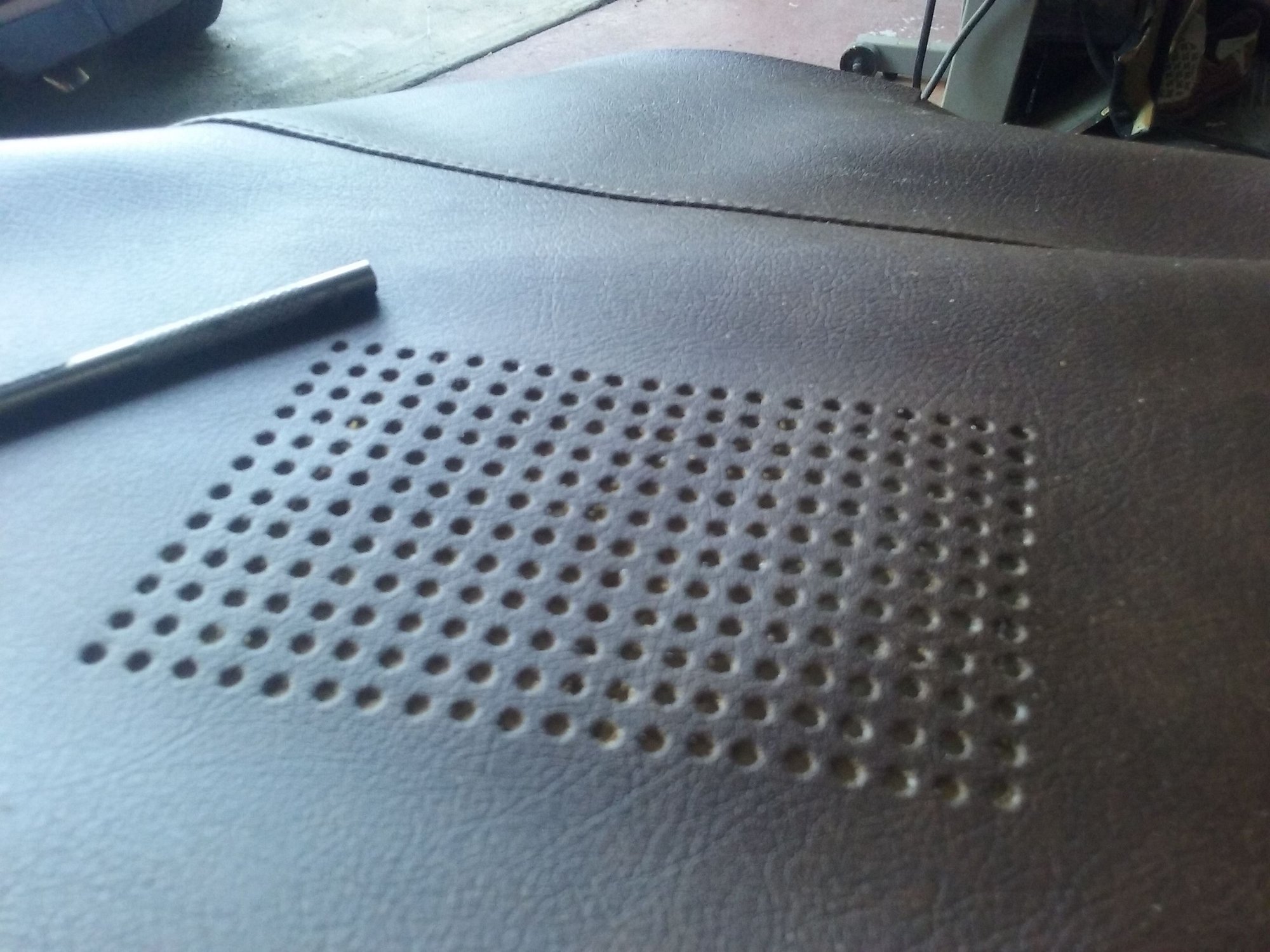

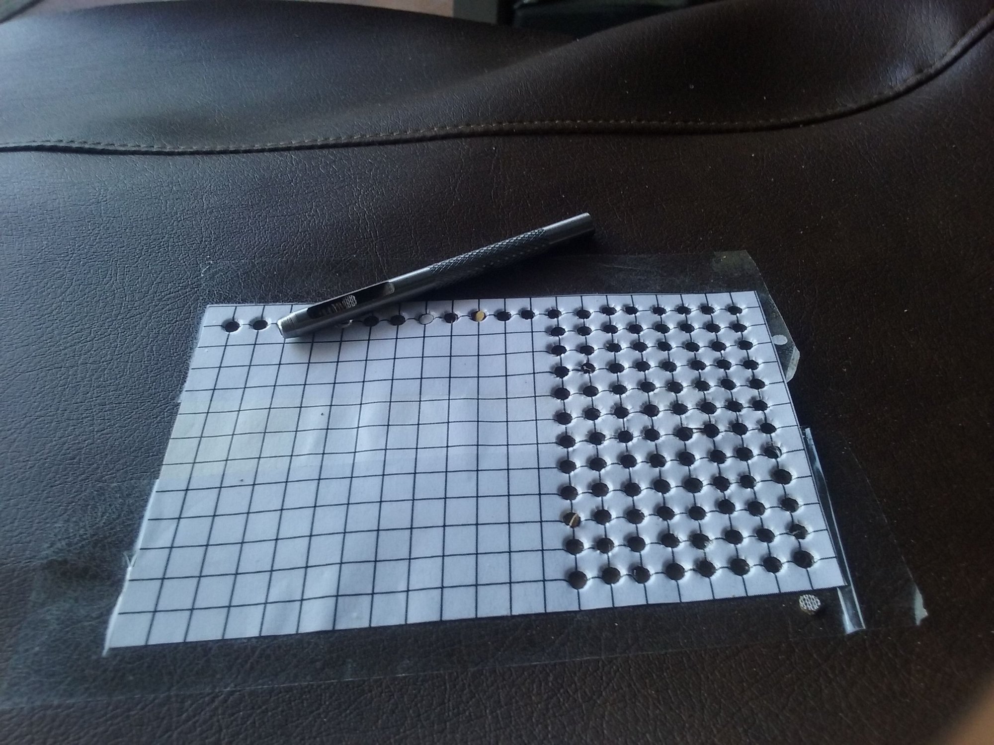

Like mentioned you can get it upholstered. THats what i did myself.
The upholster guy can make holes with a hole punch tool.
I used a 1/4 inch foam overlay then a 2 piece vinyl with stitch similar to original. I made the speaker holes simiar to original using a template and punch.

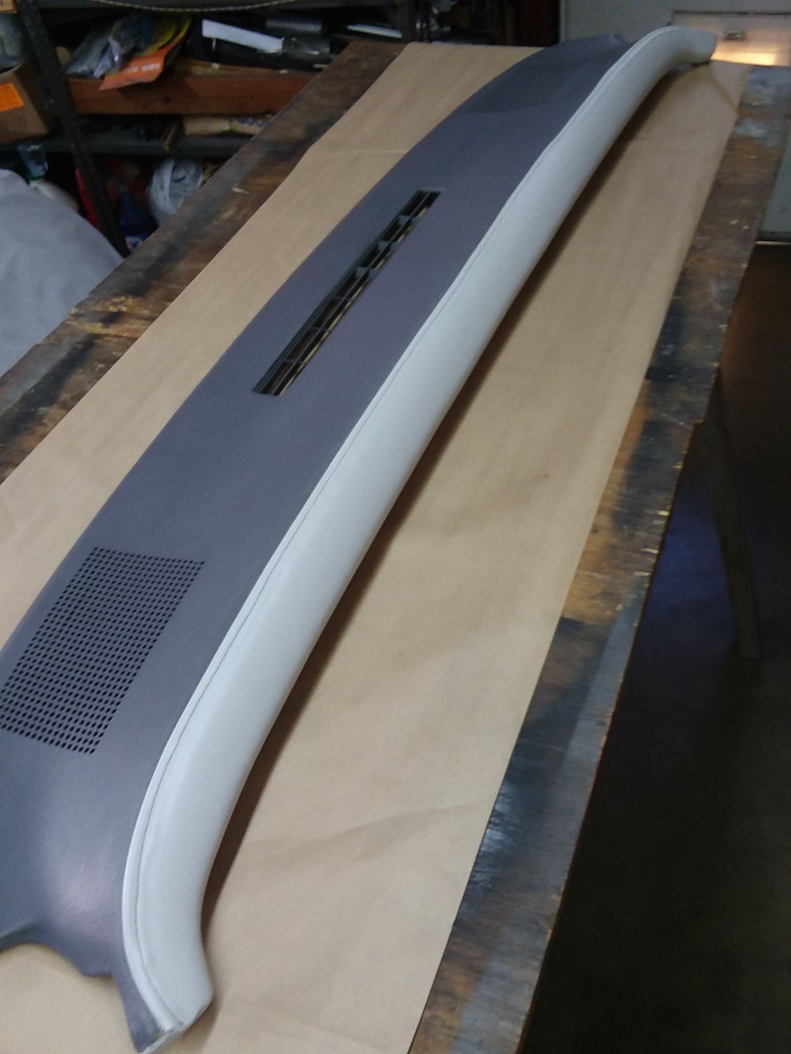

Here's my reskinned dash pad , no idea on how much it cost . Here I was adding some more dye to it , but you can see all the staples used

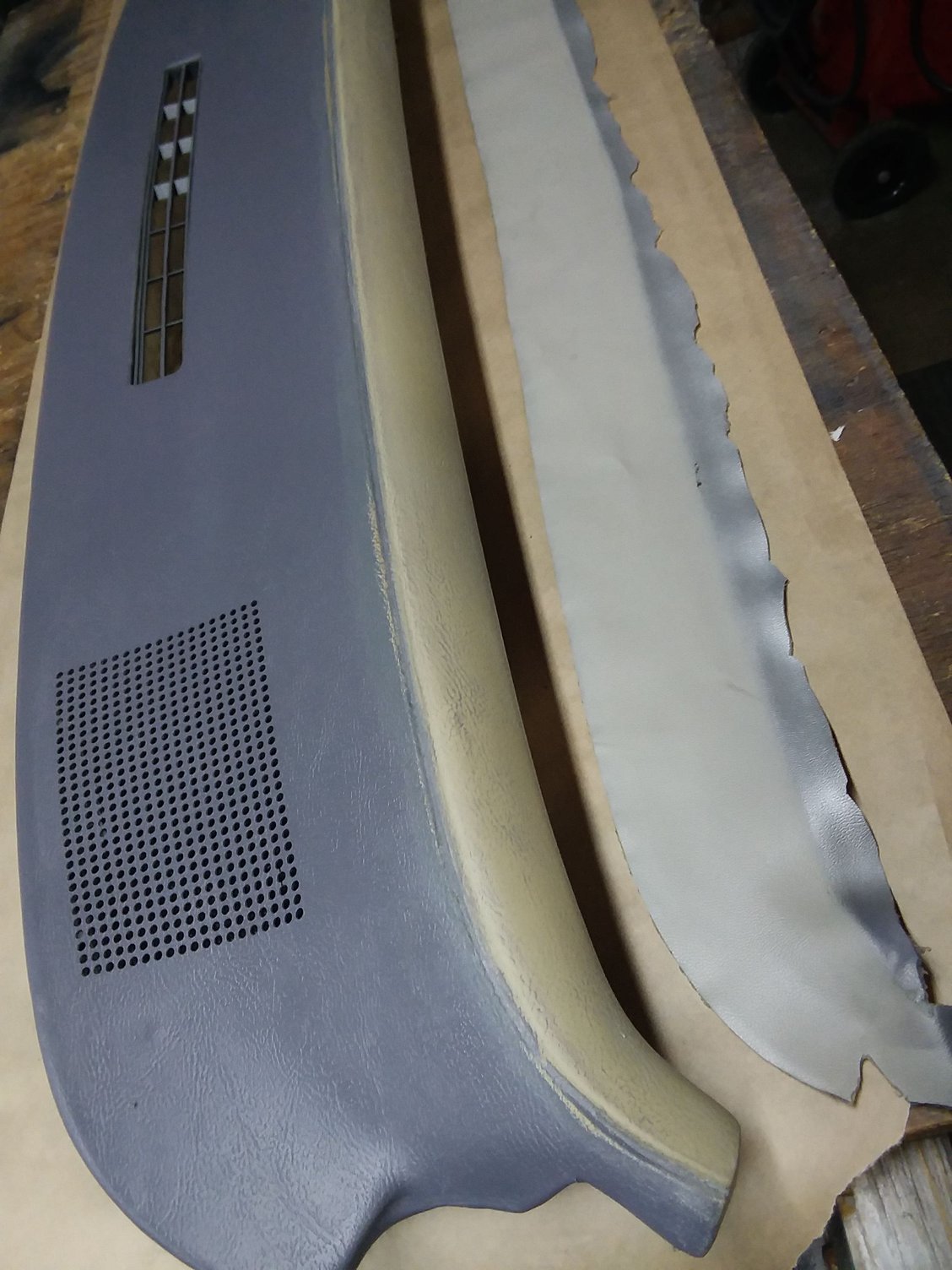

This should give you an idea of what I tried to do. I don't know if any of the other interior colors have the two toned dash top but mine (smoke) does. There is a little groove between the two colors and when I patched in the light piece it I pushed it into the groove and it looked pretty good. Unfortunately the glue did not hold up and now I know why.
The dark part has already been painted with the SEM Color Coat and some of it came off when I cleaned the glue off the light part with acetone. I'll cover the whole thing this time around.

also, your dash looks surprisingly good haha. mine had huge cracks across the center that seperated and foam showing through, with the speaker holes deteriorating.

heres some pics i found of my cover. ill try to get more of the finsihed dash. you look closly you can see the seam where the original dash had the line indent.
i cant seem to find better pics on my computer of the finished product but it looks pretty decent(may e a lil puffier than oem because of the foam i put).

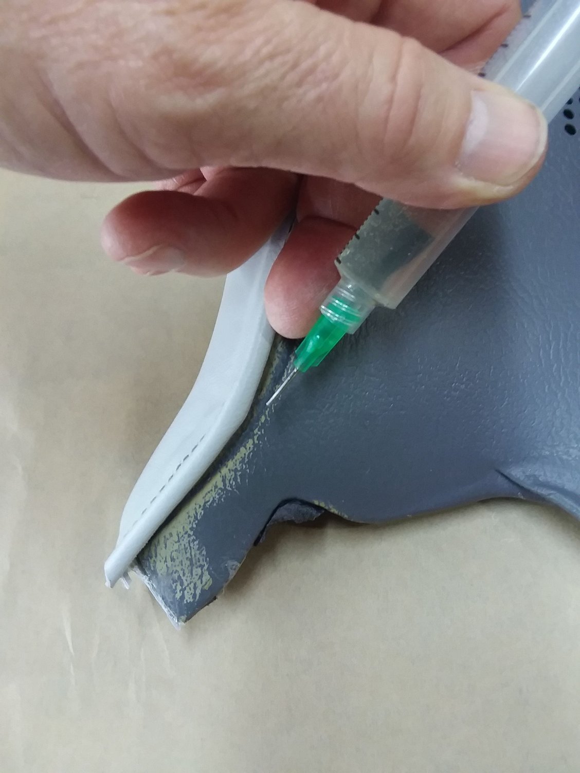

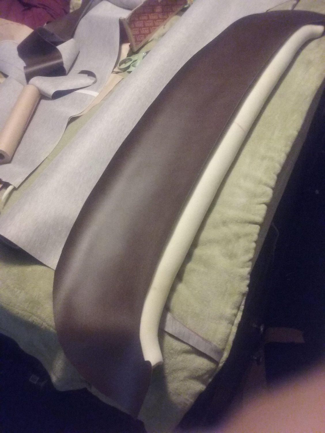

Ok so the dash top is looking good, I only recovered the rear portion from the groove backward.. What I did was have my wife, who is pretty good at sewing, stitch in some beading (aka piping) that I had from another car upholstery project. I used the 3M 90 contact adhesive to attach the vinyl to the dash but masked off the little groove on top where the bead would line up to. After that was done I used Gorilla glue to bond the bottom of the bead to the groove, the photo shows how I did that with a syrige and a large bore needle. Seems to have worked all bonding feels solid. I still need to paint both colors but that is the easy part, I thought showing the photos now will give you guys a better idea of what was done.
