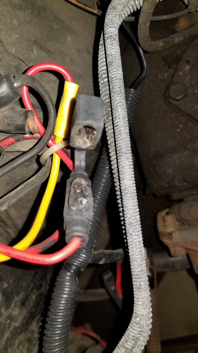

The fuse for my single Spal fan melted yesterday. Anyone know of a reason that would cause this?

You need a new fuse holder. The inside of the holder was not tight on the fuse spades, creating resistance and heat. The hotter it got, the looser the fit. .

Thank you Sir, all has been replaced, installed a 30 amp fuse. I believe that is what is supposed to be in there but not sure.

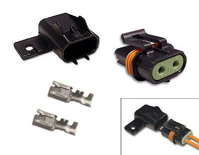

I'm not a fan ( no pun intended) of the splice /connector in-line fuse for high current applications
I like the Delphi waterproof one- half the number of connections- as the wires are crimped inside the sealed connector
https://www.waytekwire.com/item/4604...C-Fuse-Holder/

I love those, just ordered 20! Thanks

I used those weather pack connectors all over my Cobra build. They are much better. I have switched over most of the Vette to those where needed also. Little pricier but well worth it in the long run.
