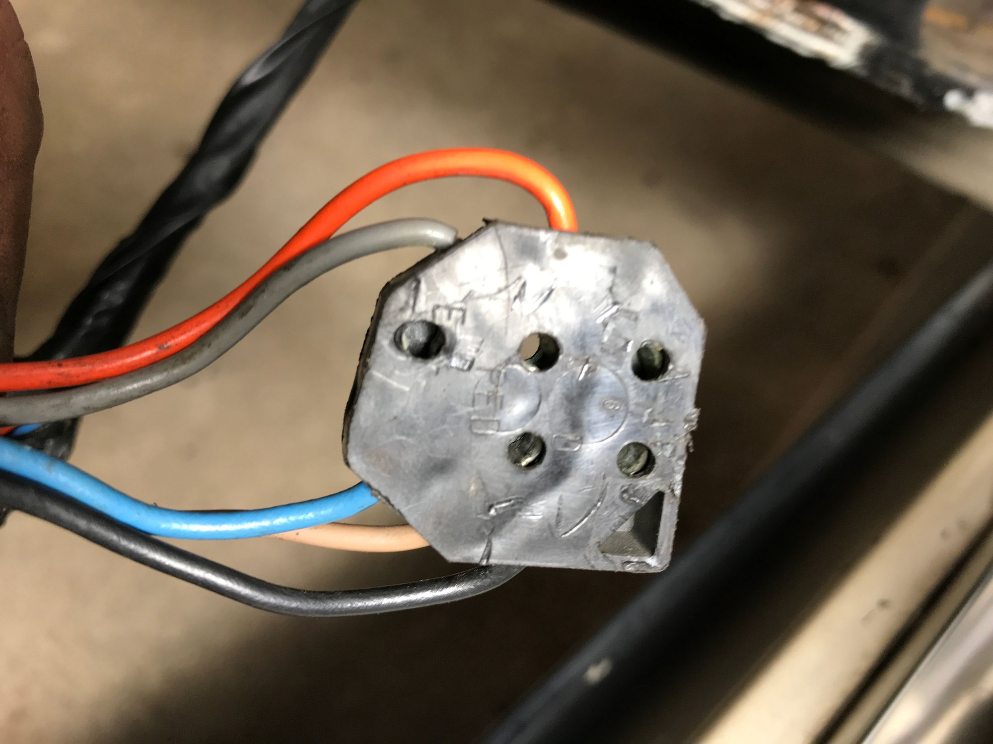

When I took mine apart, here’s what I found. If I remember correctly, the blue wire carries 12 v between both door contacts. I replaced both of my contacts. This is the config for 1982. Yours looks a bit different but I suspect a broken wire

Thanks for the info. I checked the ground and the wires on the switches are good. I saw on a diagram another component under the dash or center console related to the locks but haven’t been able to chase it down any idea where it may be? On the 78 model it has a blue and a grey wire on either side.
