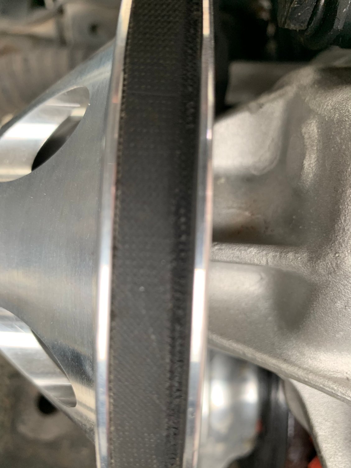

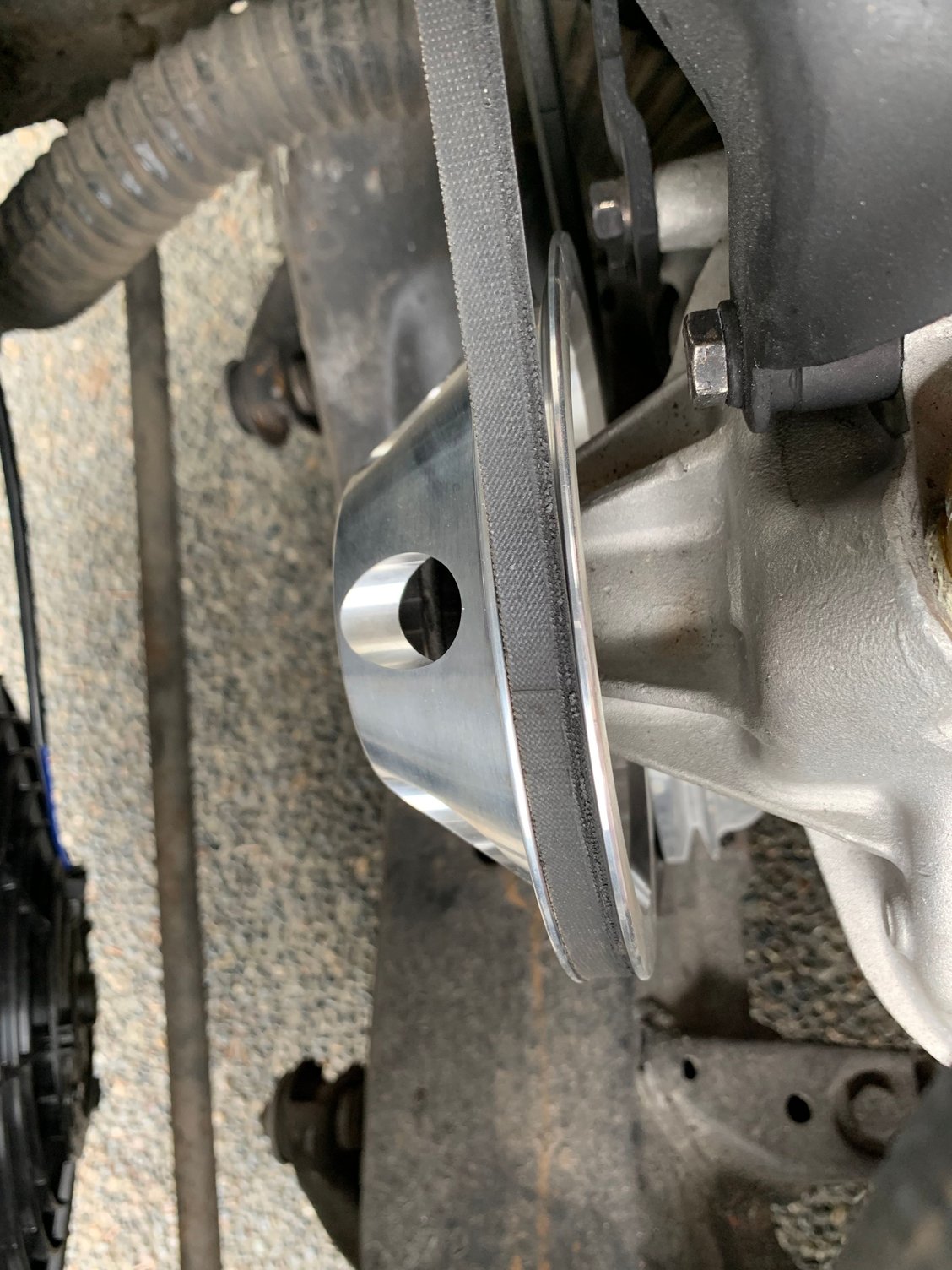

I noticed this on the belt. It looks like it’s been rubbing or something on the very inner edge.

Very good! Looks like you found where the noise was coming from.
Where is the pully rubbing? On the balancer?
