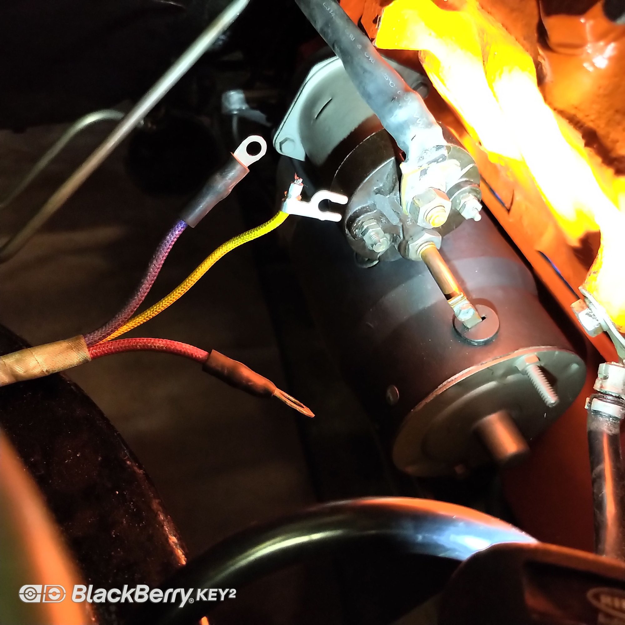

Hi Forum buddies could someone kindly confirm which wires (red, yellow purple) go to which connector on this starter motor (the previous loom had been repaired and colors did not quite match-up); photo of your car starter motor as a guide would be really appreciated.

red has a big hole. goes on big top terminal. supplies power to whole car. yellow fires starter. S terminal. purple provides hotter spark while cranking. R terminal.
No. Yellow is for the resistor bypass and attaches to outer small "R" terminal. Purple wire is the starter trigger wire and attaches to small "S" terminal, (closer to engine block).
This is correct.
