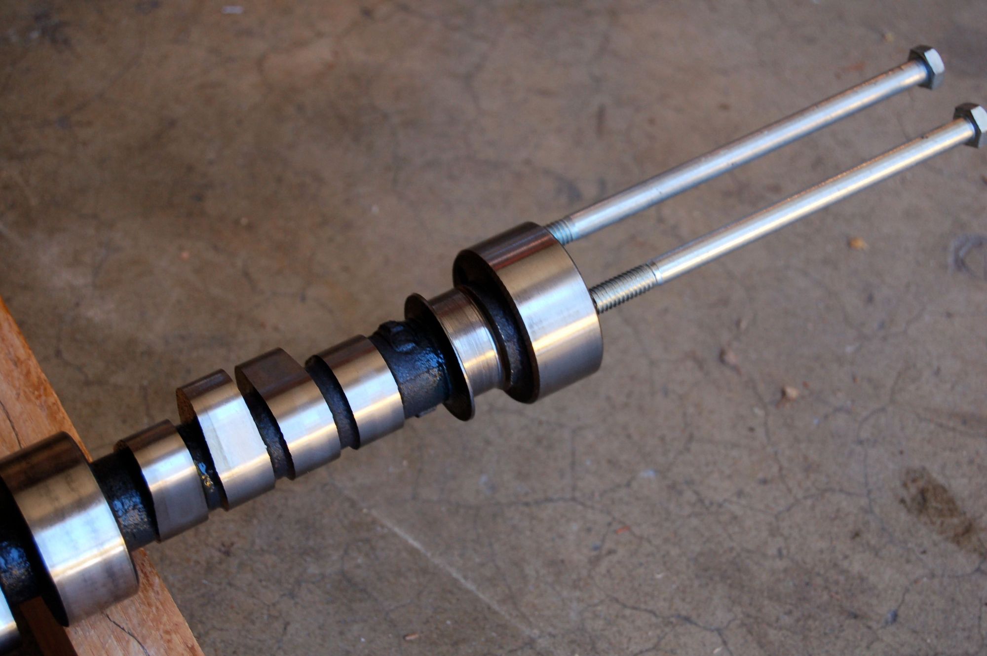

Originally Posted by B
I had an erratic fuel pressure issue in my 70. See here: https://www.corvetteforum.com/forums...-pressure.html
The previous owner installed a bronze tipped fuel pump rod which according to the builder (blueprint) is not good and may have eaten some of the cam lobe so..... electric fuel pump is cheaper than a cam swap.
That's not right, the bronze is softer than the cam and will wear first. It sounds like your cam lobe is shot but you really should check the pushrod throw as MelWFF suggests.
I have been both places, swapping out the cam on my old motor and installing an electric pump on the new motor. There are a lot of issues with and electric pump that need to be addressed. You can do it cheap and noisy or do it right.
You owe it to yourself to verify the situation as it seems you've eliminated most of the other possibilities. Based on what I know and my experience, I would swap out the cam. If you are looking for a performance gain as well, consider this an opportunity.
I thought the bronze was softer too so maybe the tech i spoke w/ misspoke. I REALLY don't want to do a cam swap to be perfectly honest. I don't need more performance and i'd rather not go into that much labor. My thought process here is to spend $200 on the electric pump and run that. If the cam flattens itself in 10k-15k i'll replace it then or maybe go LS, we'll see.
