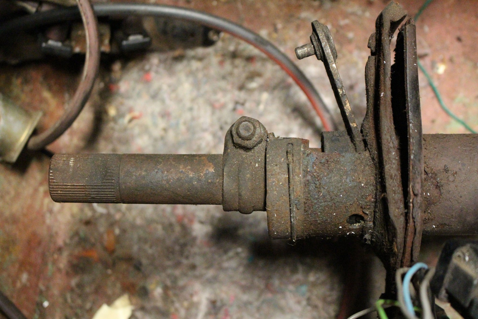

Here is a pic of the strange clamp on my 72. (My column is presently out.) It sounds like what the OP described. It does not restrict the shift lock. It looks like it would prevent the column from collapsing. It looks like a factory clamp. It looks like a tie-rod end clamp, but IIRC it is a different size and is just the right size for the column.
I thought it was "Bubba strikes again" but maybe not? Looks too factory-like. But why?

Tie rod clamp. There are diff sizes. I'd say not OEM

That's exactly the same clamp in exactly the same position as mine. I also thought tie rod clamp. I've owned my 69 from 1973 and am the second owner. The car was bone stock and unmolested when I got it. The fact that there are more cars than mine out there with it and it's not an easy thing to add leads me to believe that it is factory or dealer added. Kind of a puzzler...........Bob
It might be just the camera angle , but it sure doesn't look like the shaft is central in the outer tube. ?
I was thinking maybe it was put on by the manufacturer for protection against being dropped and shortened sccidently while in storage and transport to the assembly area , then supposed to be removed at the assembly line. Maybe the workers missed a few , like the rag joint plastic protector you see on a few cars , well pics of them anyway.
Just a thought !

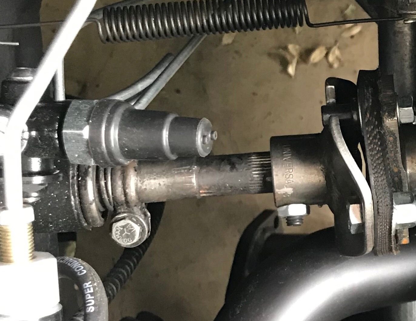

You have a ‘69 and it uses the same clamp and spring as a C2 to secure the lower bearing. It must be adjusted properly to retain the lower bearing properly. Here is a pic of my ‘64 with the clamp and spring adjusted properly. I also have a Borgeson PS conversion.

There are some differences. My shaft is the same diameter from the splines up through the bearing. The bearing spring has about 5 coils and has a spring clip to retain it. I just got my column back in today and with the shaft the correct new length the clamp is only about 1/4" from touching the rag joint. I'd post a pic if I could figure out how but no biggie. I think I've got the conversion about wrestled to the ground. Thanks...........Bob
