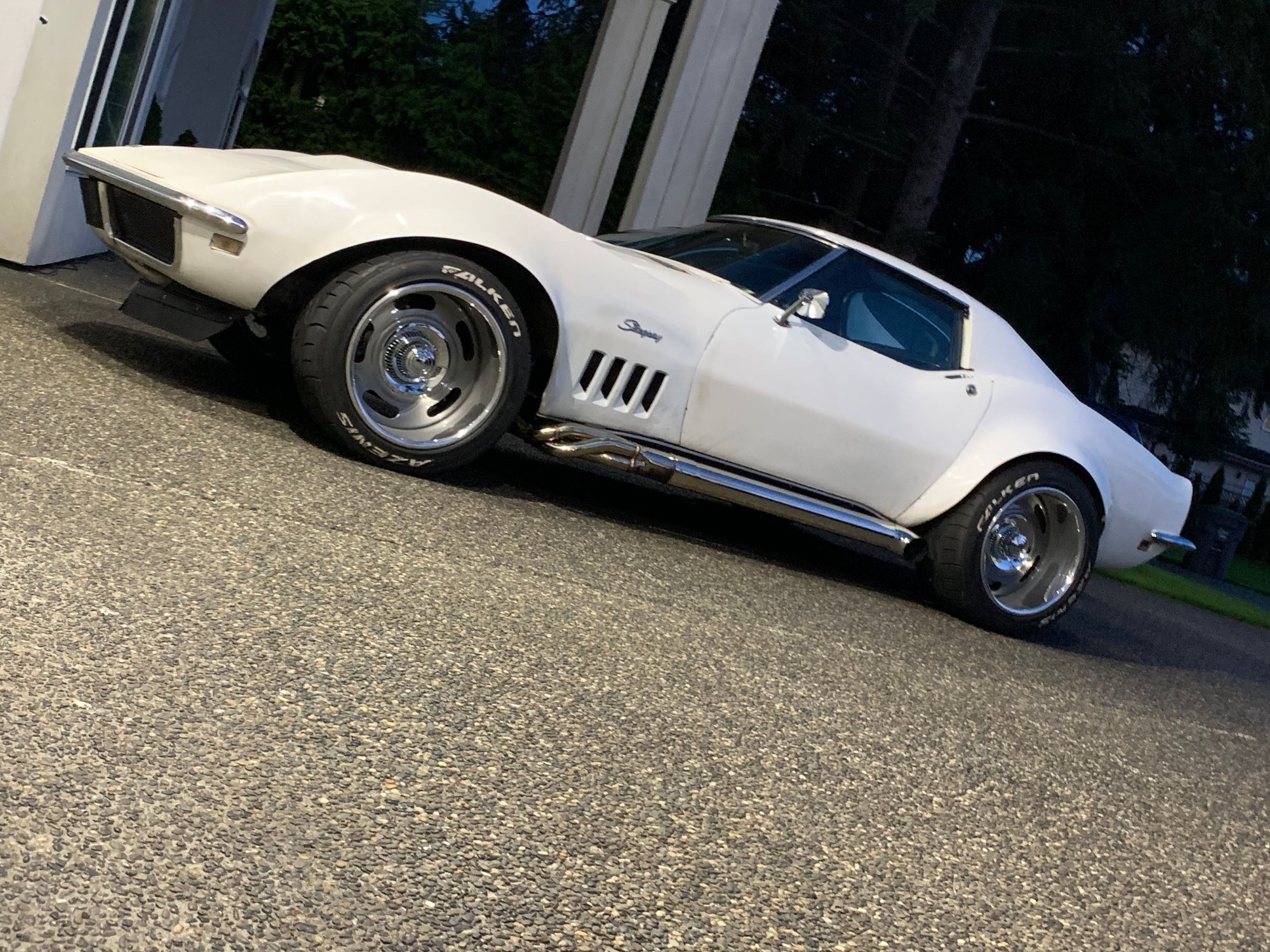

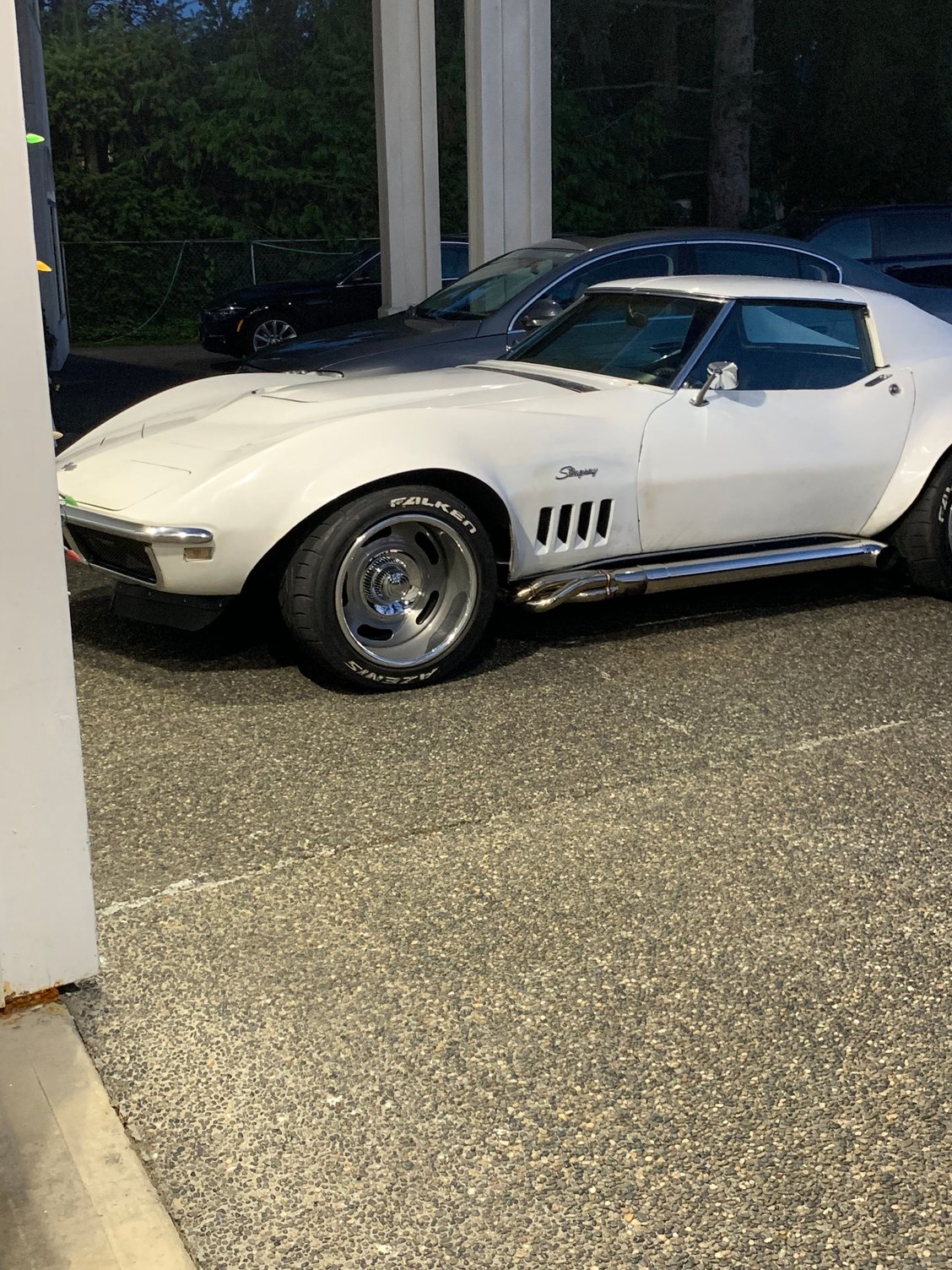

Has anyone run a 275 tire on a 11” wide wheel? I currently have 295-40-18 on the front of my 68 and at full lock the tire edge just touches the end of rocker panel moulding. I know the falken azenis do run wider than normal so I’m curious as to whether I could switch out the fronts to 275-35-18. I know there is roughly a 1.5” difference in overall height.
This is what it looks like now.

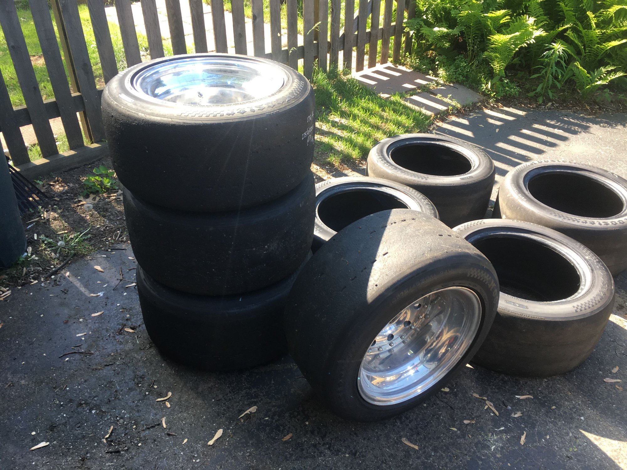

Not on the car I don't. However I have this picture of the 275's mounted on 16x11's, not sure that it's an apples-to-apples comparison though with a 275-18..
