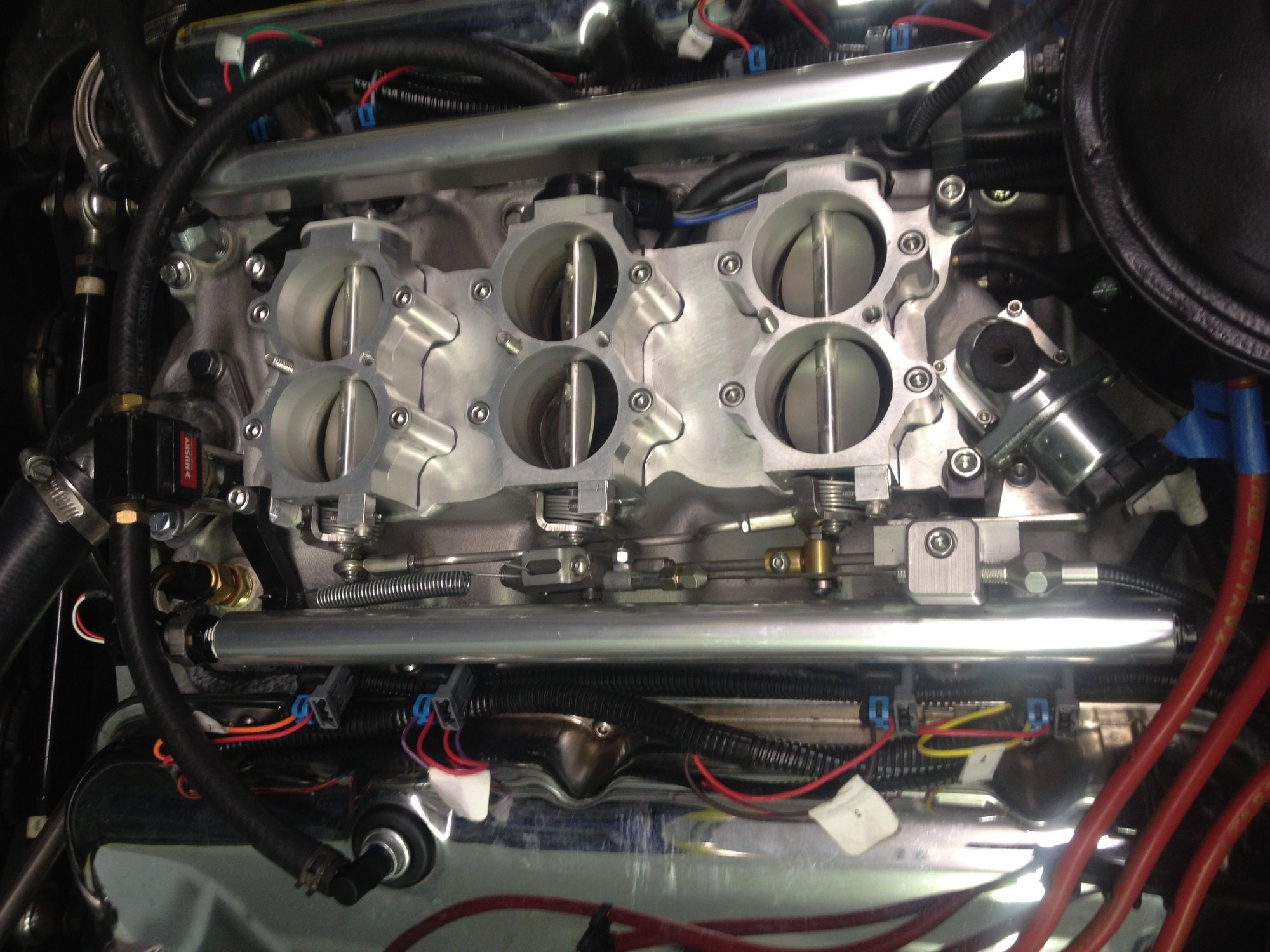

If you got the $$$, a Tri-Power setup will clear a big block hood.
Also, and EFI setup can let you run a taller manifold since most throttle bodies are about 1/2 the height of a carburetor. Saves about an inch.

Agreed. But damn, it does look good. A modern 4bbl will flow much better. The LS-6 pancake manifold is a compromise. So is the tripower due to hood height.
My EFI is flows better than the shorter stock tripower since the throttle bodies are shorter and the manifold taller. One day, I may sell it and swap to a single 4bbl EFI. Till then, I'll just enjoy it.

EFI and a TriPower! I really like it.
