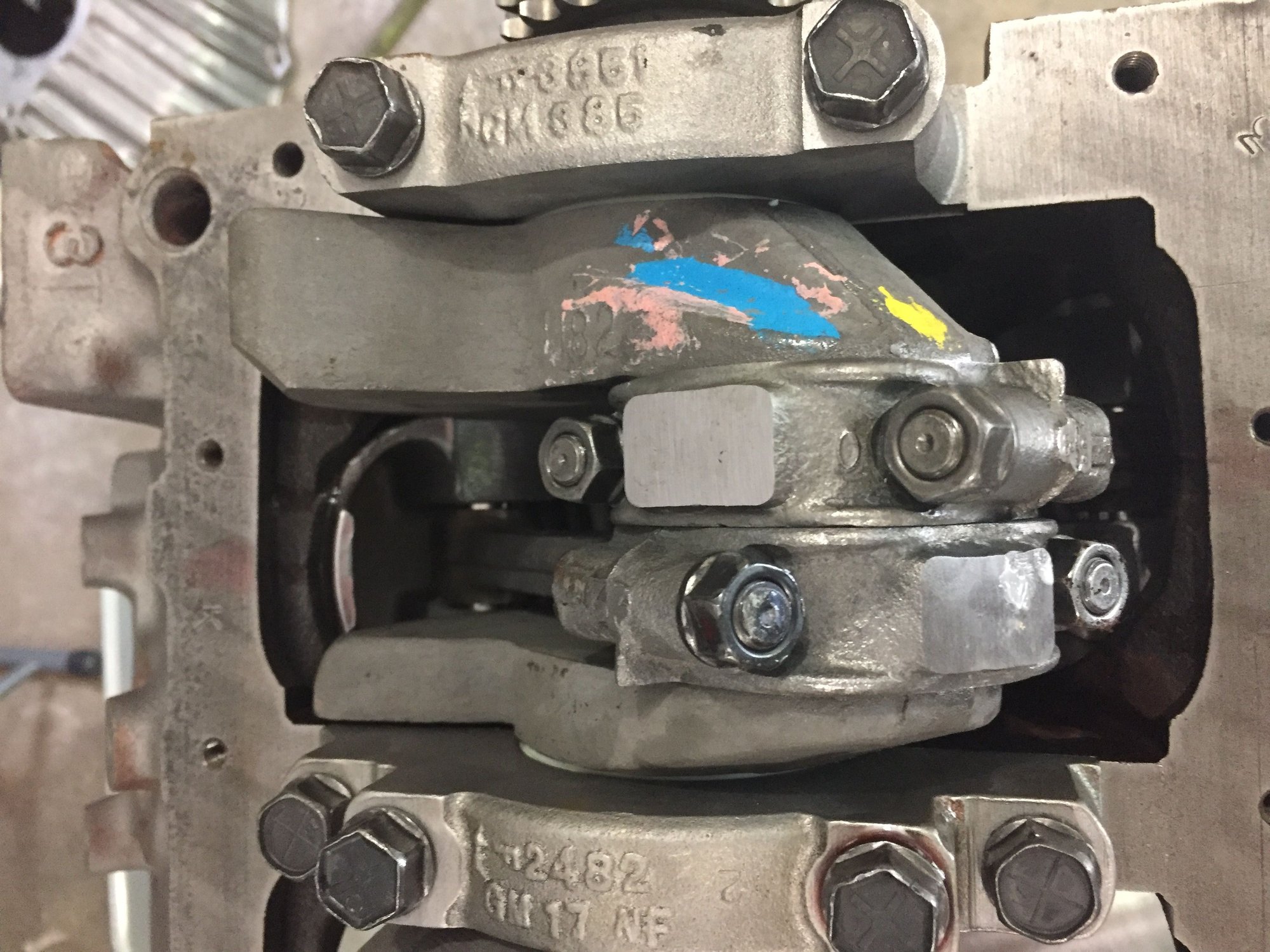

Originally Posted by L88Plus
The "holy grail" is the 4-bolt with nodular main caps, easily recognized by the numbers "2482" cast into the center 3 caps.
Standard issue on the LT-1 with O pink rods and nitrided crank
