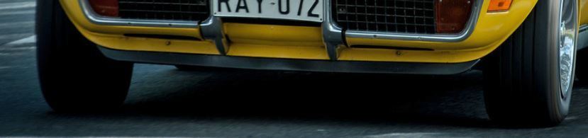

is your black plastic "air dam" installed?
along with all the seals around and on top of the radiator?

i'm sorry, but i don't know what is "air dam"
In the pic theres a black thin piece of black plastic under the yellow spoiler in the front. Most bigger air dams are called splitters in Europe. The one in the pic is about 2 inches or about 1 cm.
The air circulation vs water circulation isnt totally correct. The air is being pulled through the radiator at idle and low speeds by the fan. At higher speeds it is forced thorough the radiator by the air flowing under the front of the car, up through the 2 holes below and behind the headlights into the cavity behind the grill. The air will go around the radiator if all the seals arent there.
The water is always circulating when the thermostat is open What is correct is that the lower radiator hose will collapse and prevent water flow and circulation through the radiator at higher engine rpm which will cause high speed problems as well. And if the radiator is full of crap it will cool less as the engine heat climbs.
As suggested, squeeze the lower radiator hose and see if its feels ridgid while the engine is shut off. make sure there is no gaps around the radiator and that there is a rubber seal between the radiator and where the hood closes down on the radiator support. And check and see if there is a little splitter under the front of the car. If there is a small rubber air dam and everything else is there and working, you can make a bigger air dam out of a piece of rubber which will force more air up through the openning and cool the motor. The one I made is 4.5 inches and keeps my motor below 180*. THe temperature you are seeing would suggest a couple of the above problems are occurring. I would also suggest testing the thermostat as they can stick open or shut.
