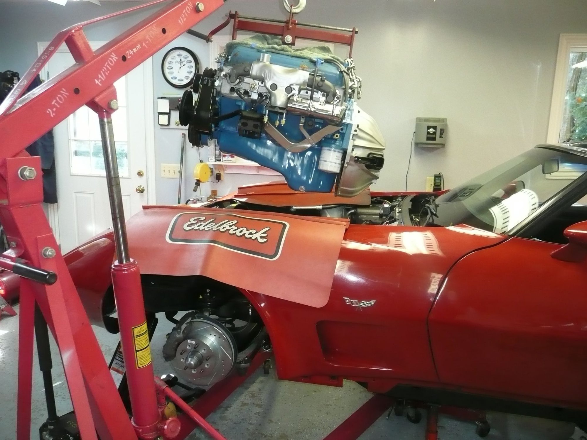

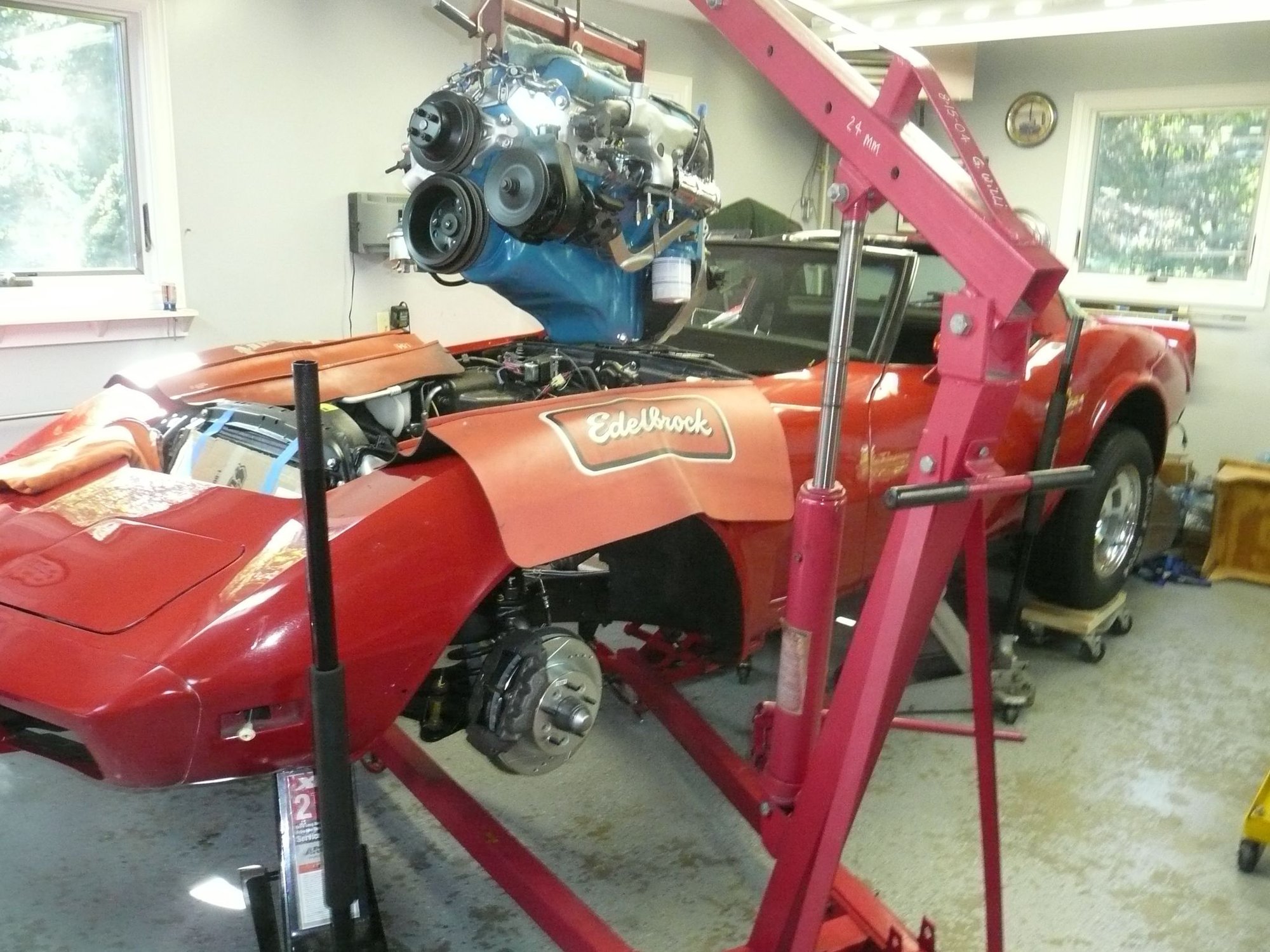

I have the same engine hoist from HF and when I put in the 427 with the Muncie attached, it was set at 1/2 ton. I did it from the driver side with the wheel removed. Setting your hoist at 1/2 ton for your SB will be fine.

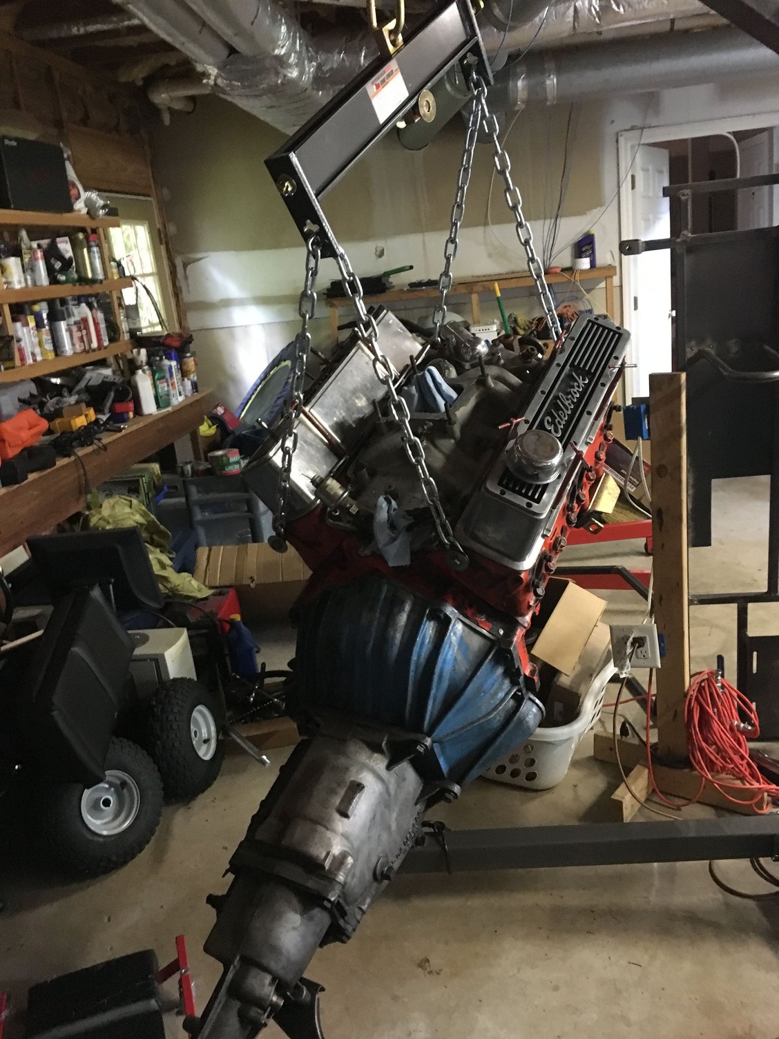

Thanks for the input! She came out easy.
