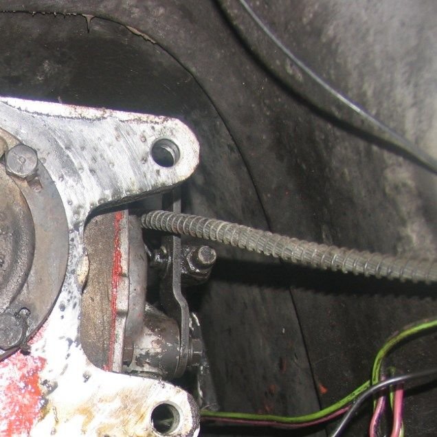

Here is a picture how the shift linkage is currently set up, it looks like that the linkage is allready at the closest mounting point towards the lever...

As for yours, yes from the photo it appears that you are already in the short shift holes.
