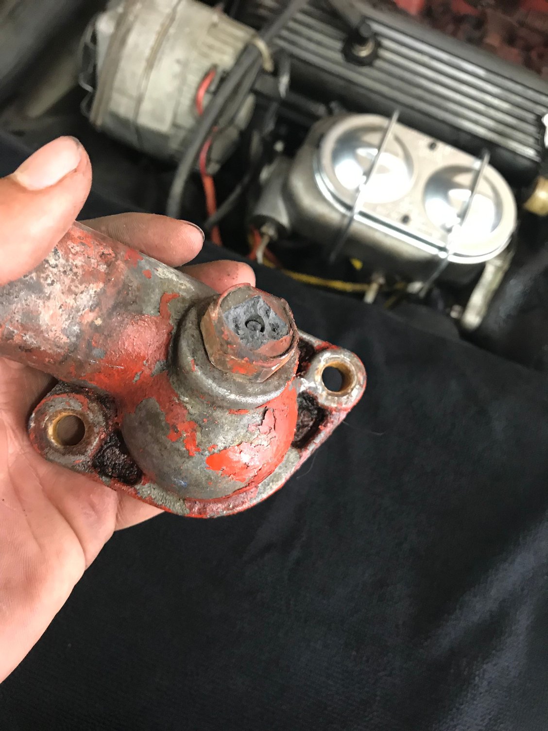

Hi all!
Doing a cooling system overhaul and when I was removing my thermostat housing, I ended up braking some type of sensor off the top and was wondering if I could get some help identifying it so I could replace it. Thanks!
(Side note The car is a 75’ L82 4-speed with ac)

That's the egr switch. Originally it was part number 3031549, then that changed to 355960, then that changed and discontinued under part number 355961.... But there is good news, Go to your local parts store and order Standard EC919. It should work just fine.
