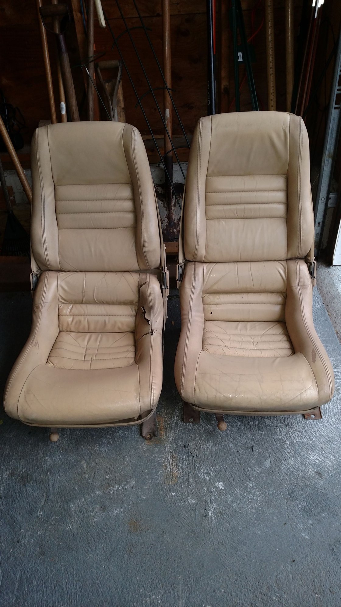

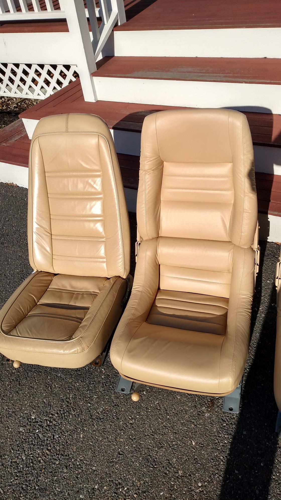

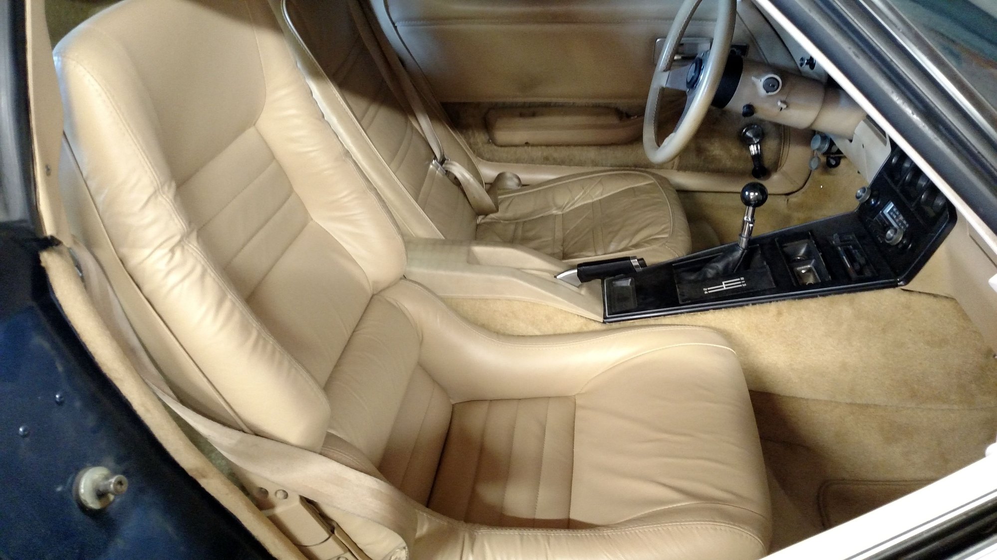

I bought 80 clam shell seats for my 78 L-82 for $200 for everything in the picture above including the seat rails. I installed the seats using the 80 seat rails ^^^^^^^
I bought the seat foams and 4 inch bolster with 100% real leather and these seats are SO MUCH more comfortable than the OEM 78 seats in the pictures above..OMG...should have done this upgrade years ago and "stole" the 80 seats locally for $200 complete......Total cost for the "new" seats with real 100% leather, correct OEM paint for the clam shells, painting the rails and my installation and removal of the old seats (which of course I have still own and are in excellent OEM condition) was $1,000....deal!
