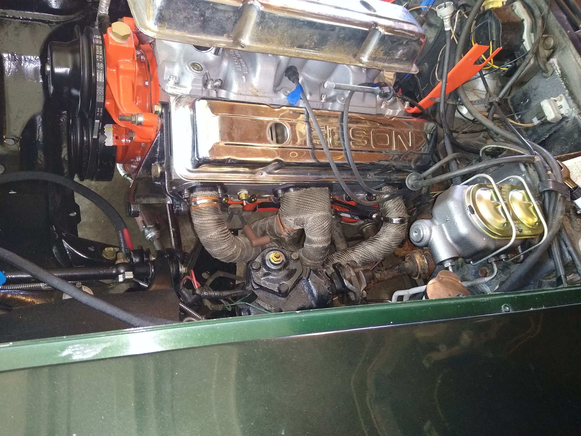

I just dropped my engine and trans in as a unit. If you are using the boomerangs and factory routing, put the spark plug wires under the motor mounts before installing engine/trans. I installed the right header from underneath, and raised the left side a few inches and put it in from the top.
Before you bolt down the right header, you will need to install the starter. I just let the header hang on the bolts untill the starter was in.
No that's not where the fan is going.
Nor am I using the fuel line.
Kind of a tight fit getting it in, and ounce the z bar for the clutch is in place, there is about 3/8" clearance between the header and z bar.

Originally Posted by jeffwebley
Unless you have high quality stainless steel header, header wrap will destroy the mild steel tubing. Under WOT and a load the pipes actually start to glow orange right off the heads. actually the more HP created "heat" can get them glowing clear down to the collector area. My headman headers just crumbled apart after wrapping them. I was so pissed at the new wrap product that they even came out with a package warning about only SS headers or don't start wrapping mild steel until 12 inches down the primary pipes.
But anyway! As a professional older vette motor installer I learned a few things about how to do the job in the least amount of time. Never take off the hood. Never install with the tranny unless you are dumb enough to not make a removable cross member. time wise it's faster to leave the hood on and later install the tranny to the block. Only BBC do you have to remove the radiator and cross mounts.
SBC headers one side goes in from the bottom and the other from the top. BBC tie off the headers to the wheel wells and install the engine. Water pump , flywheel/ C/PP with the bell housing or flex installed only. tall valve covers are problems.
Use a floor jack to support the rear of the motor after the front engine mount bolts are in and you can safely remove the engine hoist.
Generally I install the motor at #1 cyl at TDC with the damper pointer at "Initial advance number of degrees" That way you can just look down the dizzy hole for the oil pump slot with a flashlight and rotate it into where you need it to stab the dizzy in and as it rotates in get the rotor pointed to the caps #1 spark plug terminal leading edge. Where it would first jump the arc. That way when you have the timing light installed and everything ready to go. It will fire the first time and timing will be nearly right on.

From: Henry county ohio
Originally Posted by augiedoggy
if thats the case you might want to rethink that radiator fan setup.
The caption under the pic says no that's not where the fan is going.
I'll be using dual fans. Side by side. Sucking.
Like I said, headers are a consumable. If they last a couple years, I'll be happy.
