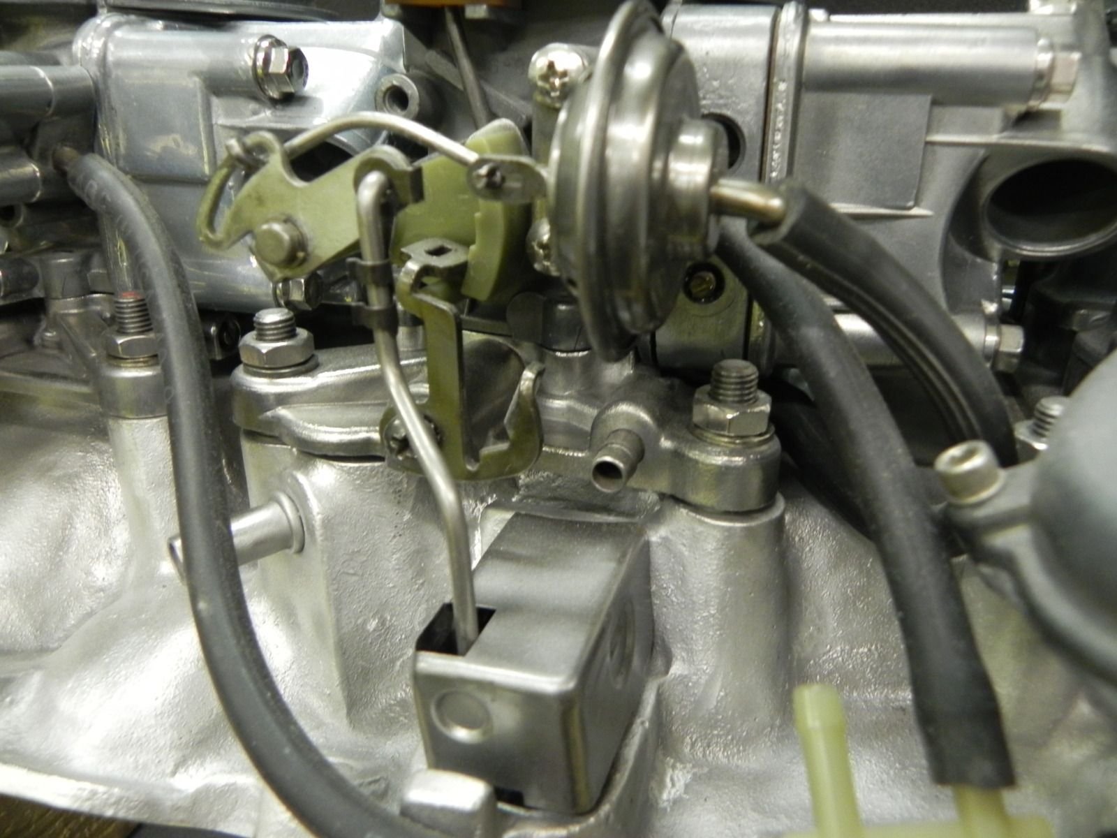

I'm pretty fresh off a rebuild of my 3 2 barrel carbs -- '69 427. It is running great with one exception. Before a cold start, I give it 3 pumps, then ignition. I typically do that a second time, and it will turn right over, perhaps with a small feathering of throttle. The issues is it settles down to idle RPM the without warming up. Suggestion?

You will have to bend your tang for the high idle choke cam to a higher setting
