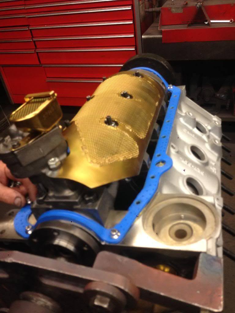

copy my build... 650hp 427 SBC gen1. 525RWHP
https://www.corvetteforum.com/forums...ort-block.html
NEW ENGINE SPECS 650HP
My 427 build from the bottom up:
Dart SHP block
Milodon 7qt road race oil pan
Milodon diamond stripper windage tray
Calis Dragon Slayer Crank
Skat H-beam's
Probe racing pistons 11:1 forged
AFR competition ported 220 heads w/titanium keepers and locks
AFR plastic single plain titan intake manifold
Sportsman EFI 2.0 fuel injection system..
MSD full ignition with crank trigger
Kooks 1 7/8 ceramic headers
3" duel mandrel bend exhaust with X-pipe custom made by D&C design... my son Danny:-)
Borla mufflers
march pulley system
22 lb steel billet flywheel
McCloud twin disk clutch
Fluidamper 6 1/4" HB
Custom Cold Air Intake by me:-) D&C design
Custom cam by Strub 611/592 244/248 109 Sep
Morel reto hydraulic lifters
Crain gold race RR's
TKO 600 transmission
SUPER 10 rear end built by trackdog2
18" custom built 2 piece centerline wheels
Willwood big brake system all around
hydroboost braking
rac-n-pinion steering
550 springs up front, 360 composite in back with all Bilstin sport shocks and front and rear sway bars
3" HD Dewitts radiator
DELTA PAG brushless fan w/D&C custom fan shroud
Dewitts 3" heavy duty radiator
