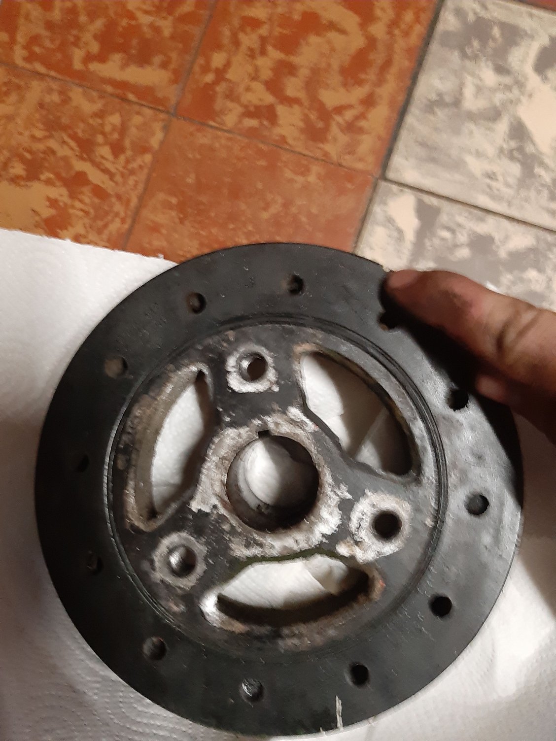

Old Sep 3, 2019 | 02:15 PM
Dusky's Avatar
Dusky
Joined: Nov 2017
Posts: 587
Likes: 49
From: Belgium
afaik, this is a slipped damper ,as it should align with the key way afaik?

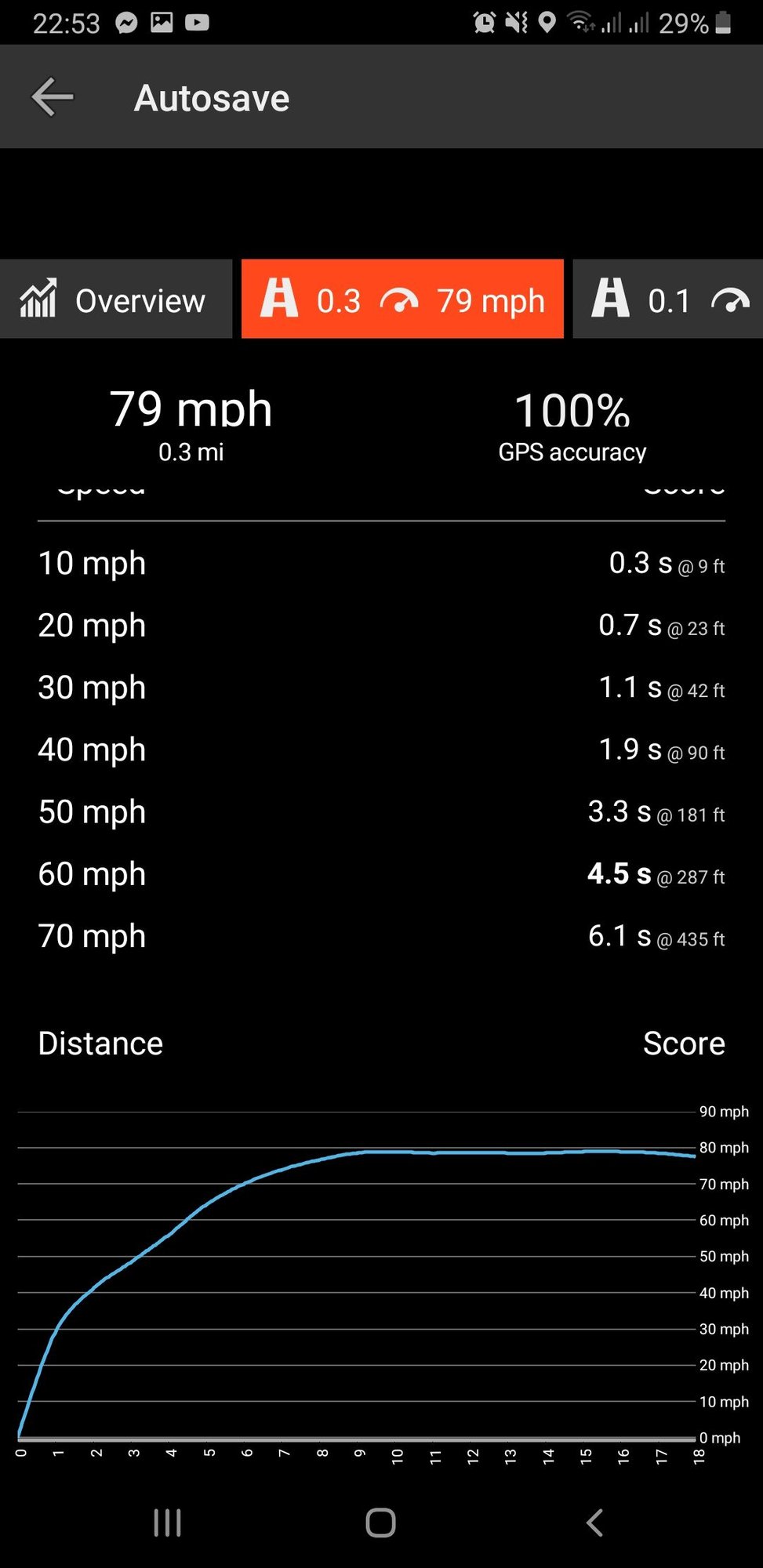

Old Sep 5, 2019 | 04:58 PM
Dusky's Avatar
Dusky
Joined: Nov 2017
Posts: 587
Likes: 49
From: Belgium
Fitted the new damper, reset the timing and went for a testrun. Needless to say it runs better. Just compare these 2 results 😅
