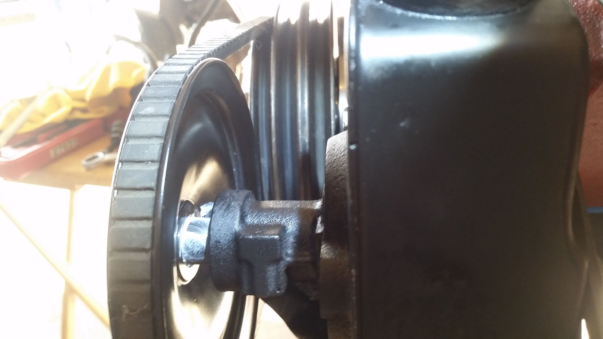

If anyone saw a previous post, I found that someone had installed the wrong 2 groove power steering pulley on my car. I was able to find an original (or so it was advertised that way) 80 corvette single groove pulley, and I picked up a pump locally. I pressed it on today and it doesn't seem like it pressed on far enough before it aligned with the crank pulley. I've attached a couple pics, but there is around 0.45" of shaft left behind the pulley. It seems like there is a pretty good gap on the front side, between the edge of the pulley and the pump shaft as well. Anyone know how much gap there should be? Any help would be appreciated. Thanks!

It's not on the shaft-- the snout on the pulley should be flush with the end of the shaft. The correct install tool threads into the shaft, has a big bearing and a nut. The bearing rides on the pulley snout and as you tighten the nut, it forces the pulley on.

Yep, I used the pulley install tool rented from Autozone to press it on. I had no problem as it pressed on, I could just tell that if I press it completely on to the shaft it won't even come close to lining up with the third pulley on the crank. Maybe the pump i got from NAPA isn't correct?

I thought the same thing, but the AIM definitely shows it on the third pulley. At this point I'm not sure if it would be a pulley or pump issue. I shimmed the pump out about another 1/8 inch, allowing me to further press the pulley on equivalently, but I can't shim the pump any further without it interfering with the alternator belt.

I'm trying to find the actual difference between my pulley and the 14023175, because they really look exactly the same in all the pics I can find. For me to make up 0.4" on the pump shaft, I would think the pulley would have to be shaped differently enough to notice. I'm confident my crank and water pump pulleys are stock. And they line up perfectly with the alternator, without needing any shims anywhere. I'm starting to wonder if my NAPA Auto power steering pump is wrong. I wonder if the front end of the housing should be slightly longer before the shaft starts. Which would take up that 0.4" distance between the pulley and the base of the shaft. It's too bad I can't just shim the pump further forward, but it's so close to the alternator belt that I think I'm out of luck with that as well.
