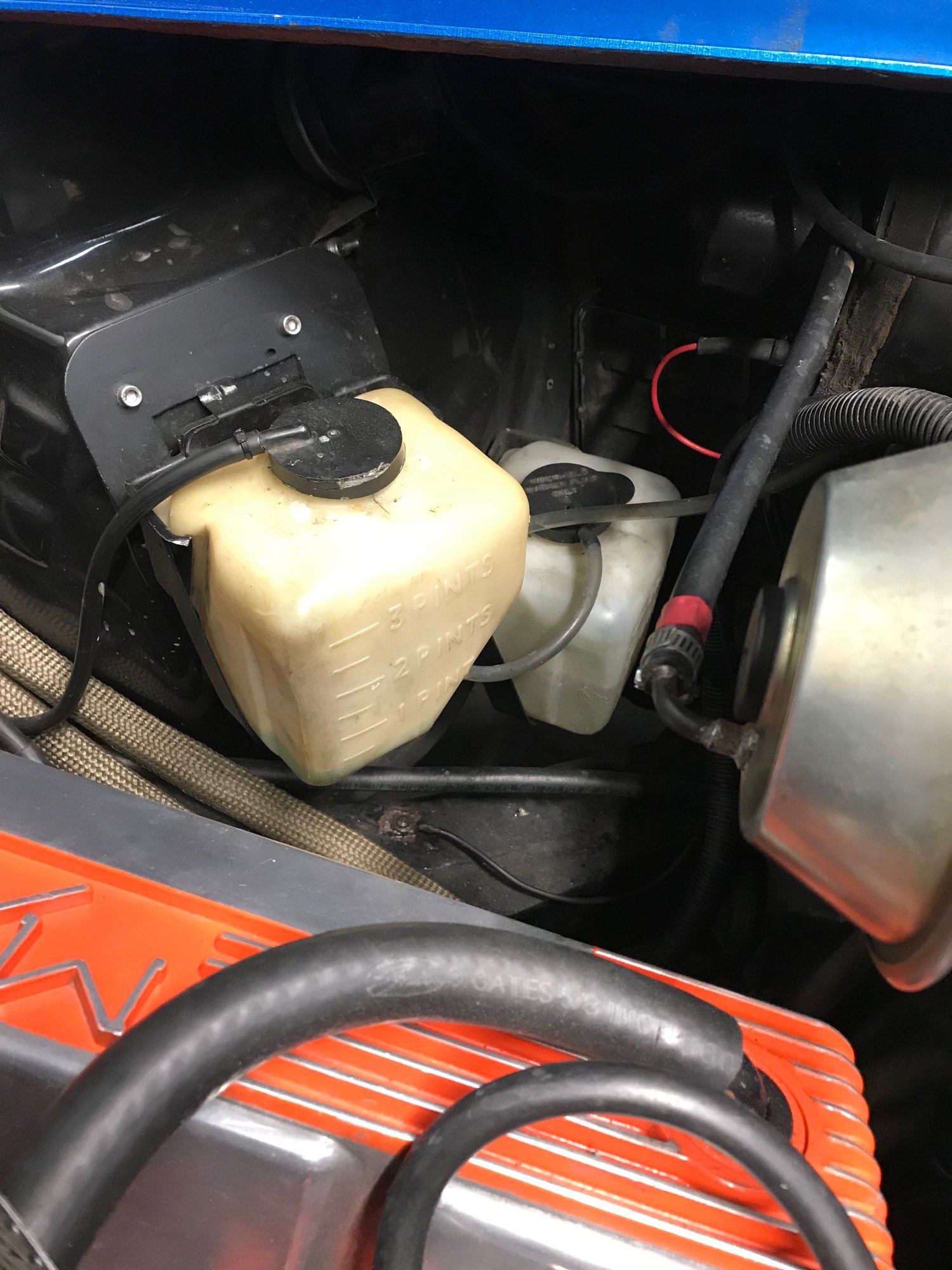

My '70 was the same setup when I got it. I added an overflow container, why? 1. if you happened to overfill the radiator a bit coolant would come out the hose when the engine was hot, the fan then blew this around the engine compartment making a mess. Make sure the hose is long enough to minimise this issue if you don't want to fit an overflow container. 2. Coolant with antifreeze is toxic but tastes sweet, so appeals to cats and dogs, I didn't want any spilt coolant being licked up by one of our pets. 3. I read somewhere that it is better to exclude as much oxygen from the coolant circuit as possible to help minimise corrosion within the engine, heater core etc.

Ray, I used a windscreen washer plastic container for the radiator overflow, $15 c/w bracket from a wrecker and its period correct lol. If you are not worried about complete originality there will be heaps of options available from a wrecker.

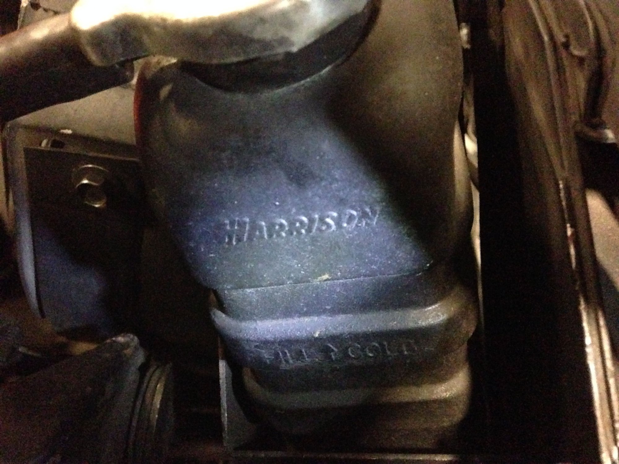

A 350/350 was a copper radiator with no expansion tank. If the radiator still has the original Harrison side tanks there is a fill cold line on the passenger side. The line is several inches below the top of the radiator. That is your built in expansion most people over fill this type of radiator.
