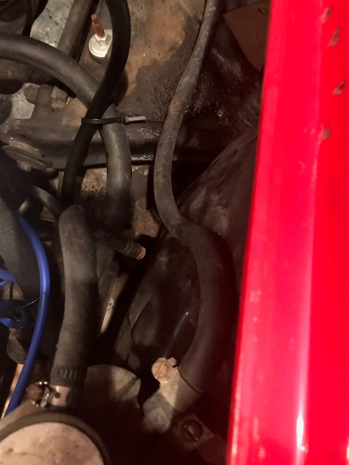

Well after all the help i got adjusting my valves I discovered another potential issue.
The engine runs quiet enough for me to notice a knocking sound coming from my water pump.
After cooling I opened the radiator cap and noticed it was low.
So I filled it up and ran the engine with the cap off until the thermostat opened and a began filling it as the level went down.
Ran it a few times at 190 degrees no overheating at all.
Looking into the overflow tank I noticed a bolt plugging the overflow hose.
Also notice the hose from the radiator to the overflow tank has fine cracks and weeps coolant after I took it for a run after filling it up.
Question #1 there does the overflow hose attach to?
Question #2 its the system simply finding its happy level and spewing the excess?
Coolant level is now a little lower, I can see 3 fins above the level of the coolant in the radiator.
Thanks for all the advice.

Well I replaced the radiator cap as well as the leaky hose from the radiator to overflow/expansion tank.
All is good no overheat-
no loss of fluid
no hose collapsing
knocking sound still there but faint
thanks.
