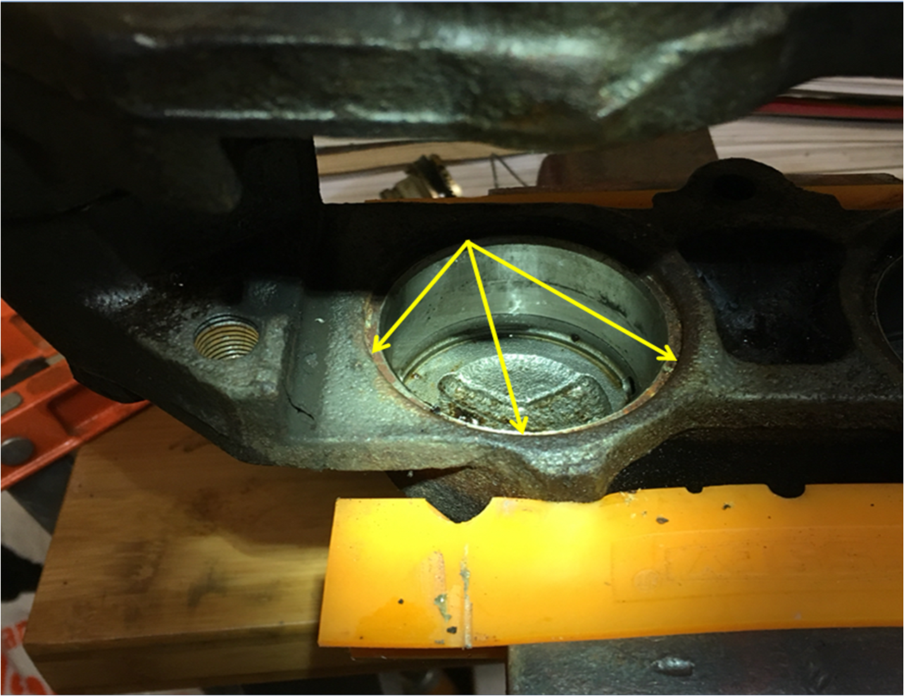

My first rodeo, but these look like stainless sleeves to me. Can anyone confirm?
If so, what rebuild kit is recommended?

Pete, the factory never made SS sleeved calipers, they were all made by the aftermarket by boring out the cast caliper bore and inserting a SS sleeve. If you can see a parting line between the caliper and sleeve (where the arrows are pointing), they are sleeved calipers. Frankly it would be highly unlikely that any C3 today would still have unsleeved calipers. Possible of course, but not probable...
I installed SS sleeved calipers on my (purchased new), 1977 Corvette, in 1980. I was not driving it much at all and one of the calipers began leaking on me. A company out of Florida was offering them so that's what I bought and installed.
Use any standard caliper rebuild kit for an original caliper. You can use the stock lip type seals or the also available 'O'-ring seals. I've used both without any problems with either. I would recommend that you also purchase new pistons if there is any evidence of corrosion on the pistons you have.
Good luck... GUSTO

The calipers looks to be stainless. I would clean the bores with lacquer thinner and finish up with denatured alcohol. If you are going to exchange them out for rebuilt units. make sure you are getting stainless steel sleeved calipers back and that they are Delco Moraine castings. Jerry
