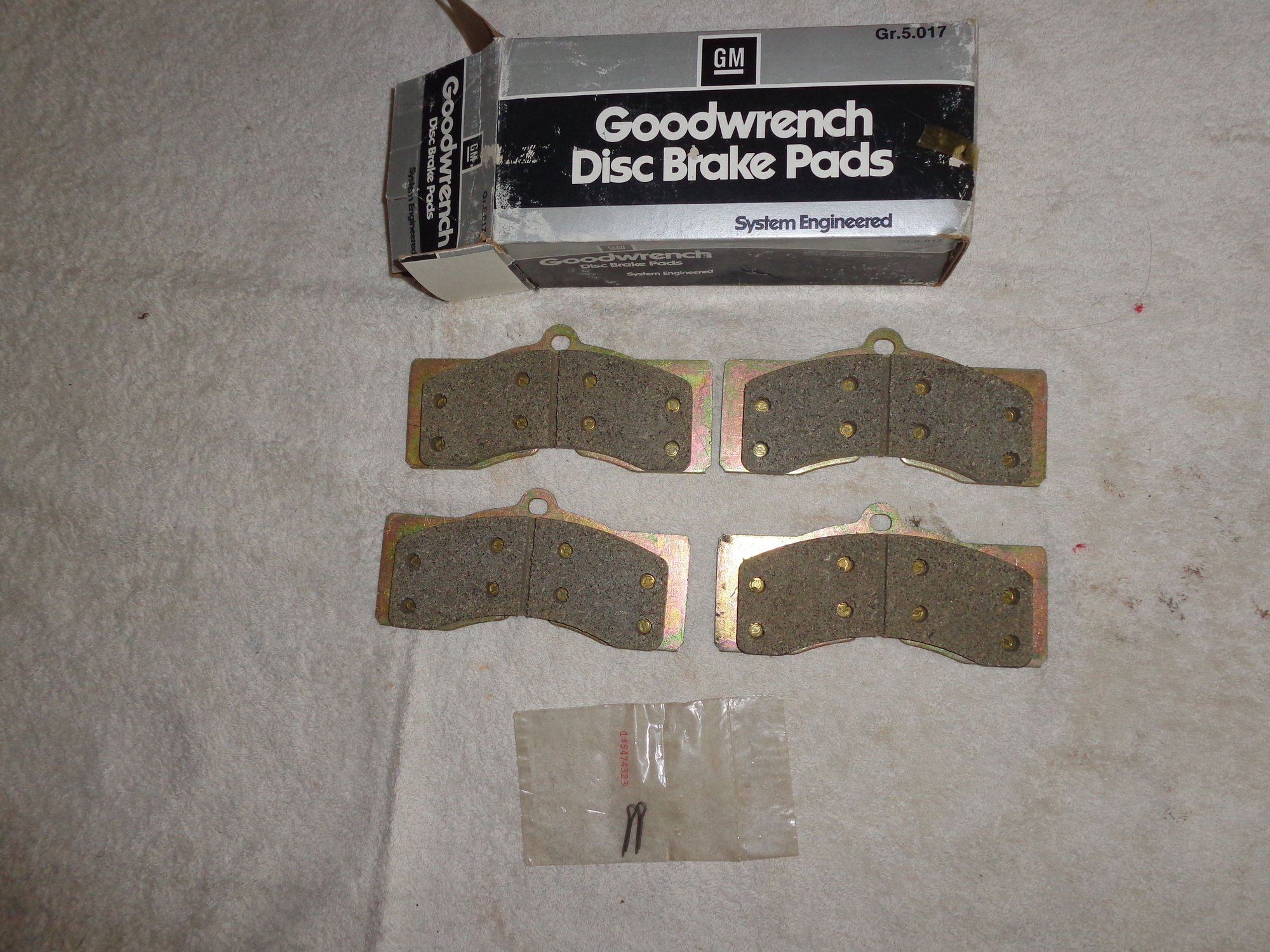

Old Mar 18, 2020 | 04:56 PM
ralphspears's Avatar
ralphspears
Banned Scam/Spammer
Joined: Nov 2011
Posts: 2,966
Likes: 991
From: MA
This is what I always used
