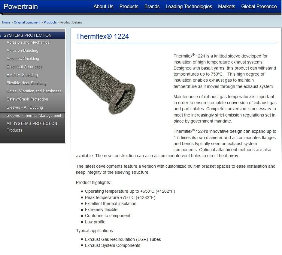

Here's what I am running- the big rigs run these around the pipe next to the turbos-
Federal Mogul Thermflex 1224 Knitted Exhaust Sleeve
Here's a link on EBay
https://www.ebay.com/itm/Federal-Mog...r/163049067238
Here's it is on my exhaust- used the SS zip ties from Summit Racing- they work great and are the least expensive.

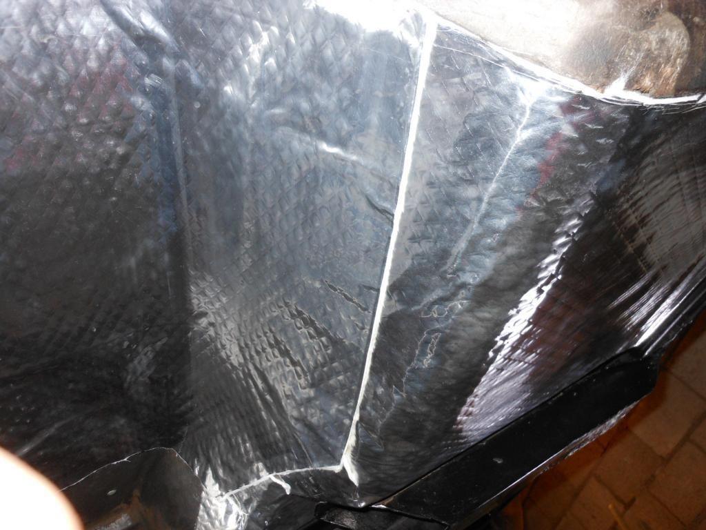

Hi Greg,That is exactly what I did..using Titanium wrap, I started wrapping about 10" below the stock manifolds and continued for 24",I also used heat shielding in the transmission tunnel with Heatshield Product 'HP Sticky Shield'
photo attached ..but not great... sorry
