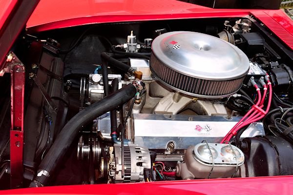

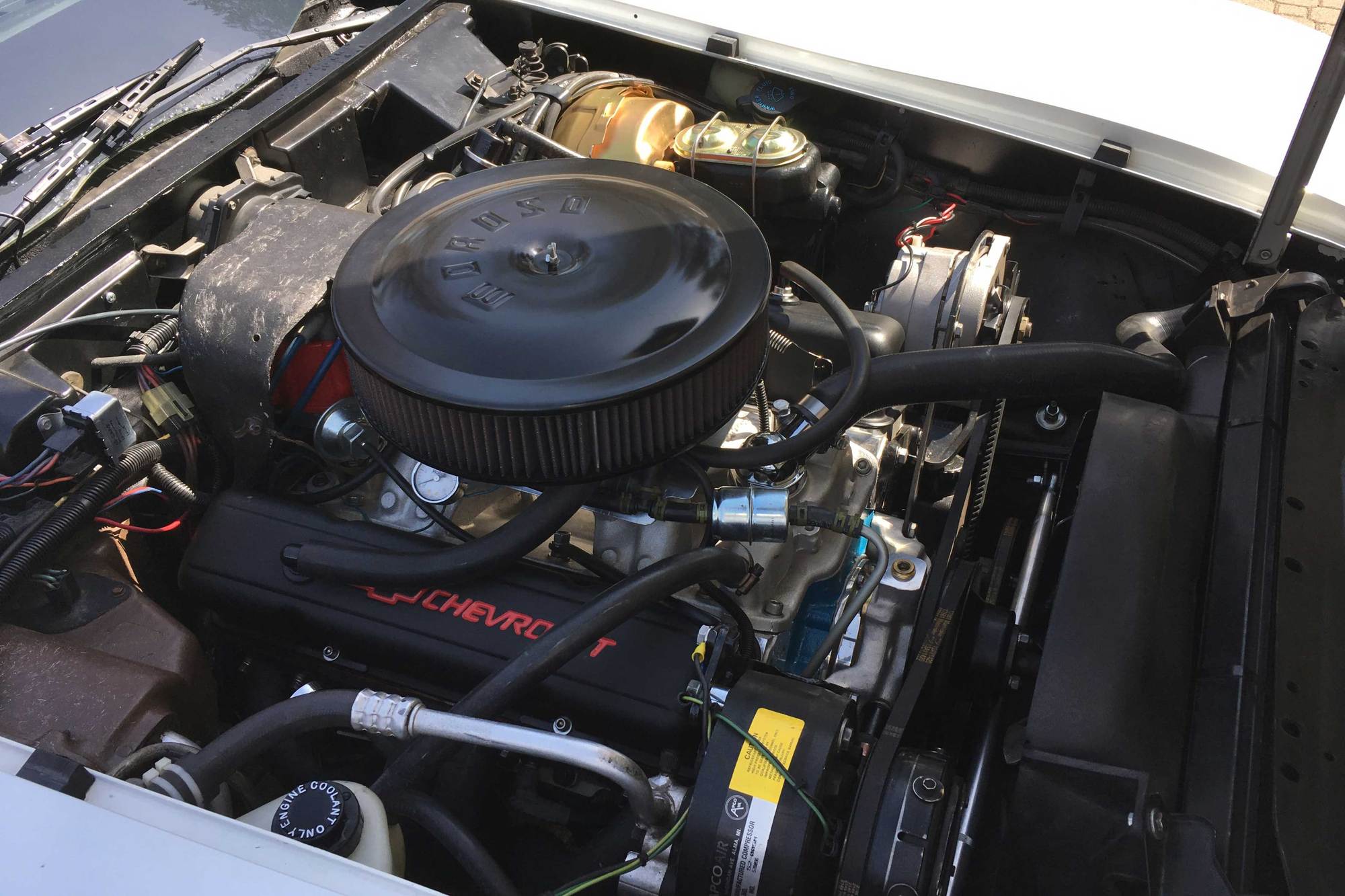

on my 350 w/ rollers rockers / tips i used the oem vette covers with a 1" spacer i believe i bought from jeggs... perfect

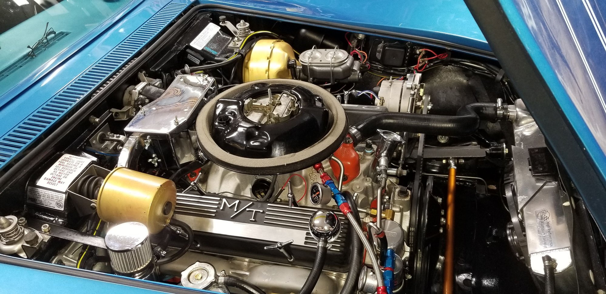

I dont know the length difference from 1.5 to 1.6 but I have harland sharp 1.5 rollers under M/T black wrinkle valve covers with stud girdles. I used .25 inch thick gaskets to get additional height. They also make aluminum spacers to get you more height for stock covers but the oil baffle could be an issue

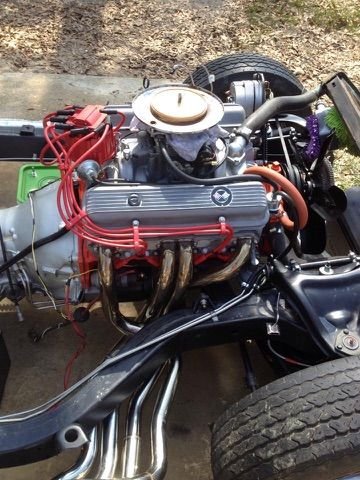

Generally speaking, tall valve covers exist to clear roller rockers. With that said, there are probably combinations of roller rockers and tall valve covers that do not work well together. I have Crane roller rockers and Pro-Form tall valve covers on my small block and everything clears nicely.

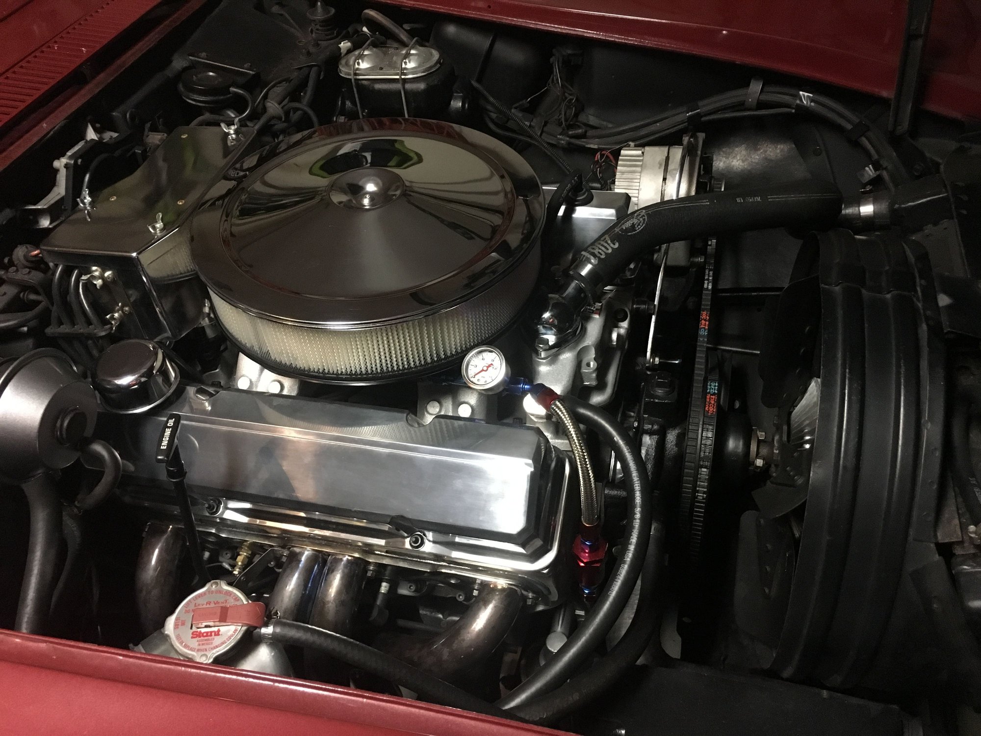

You just need the tall studs or long bolts. Those T handle things just suck. You can also find these aluminum cover in all colors. Orange motors are kinda boring. One of my motors is metal flake blue. You have break out of the sheep mode! :LOL

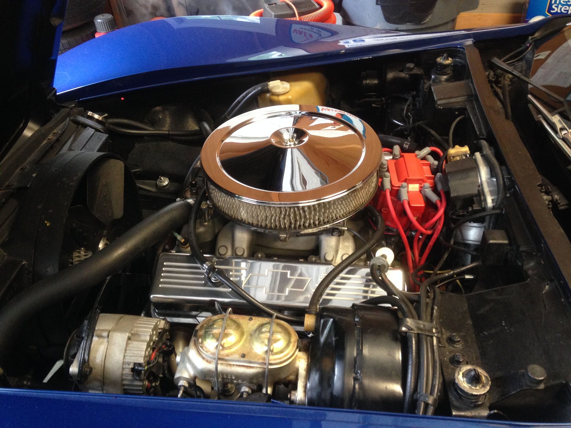

I used these Billet Specialties covers with stud kit to cover my scorpions. Excellent fit and easy to keep clean.
