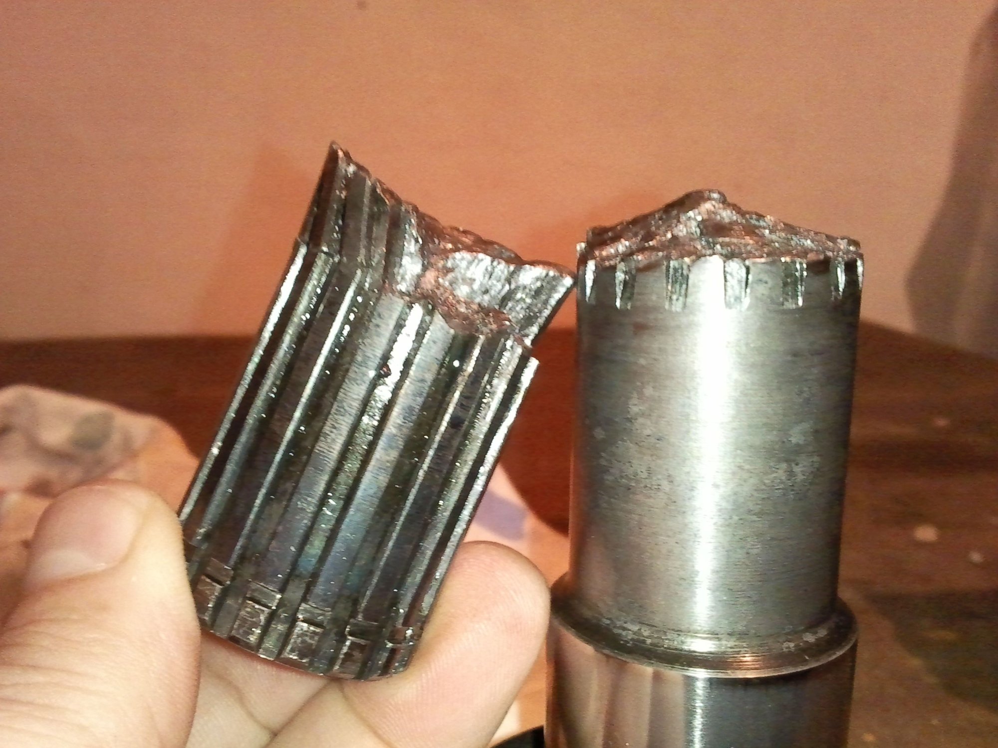

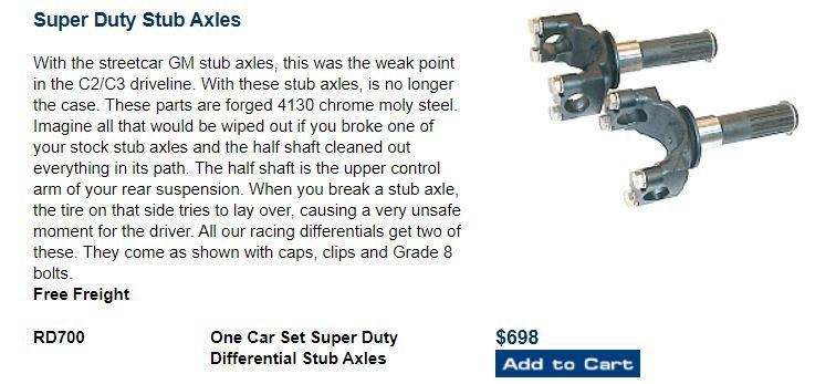

What are your thoughts on Duntov's Super Duty Stub Axles? A few years ago (3K miles ago) I purchased and installed Duntov's HD threaded Stub axles and guess what they're both worn. 1/4 to 1/2 inch end play.
My originals broke, off whom can I buy some decent Stub Axles?
Thanks

Default My Original Stub Axles, now paper weights
My
