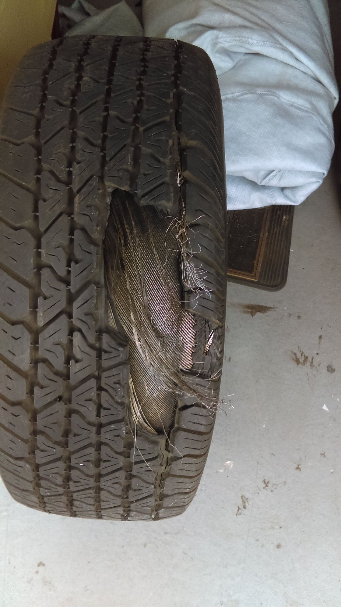

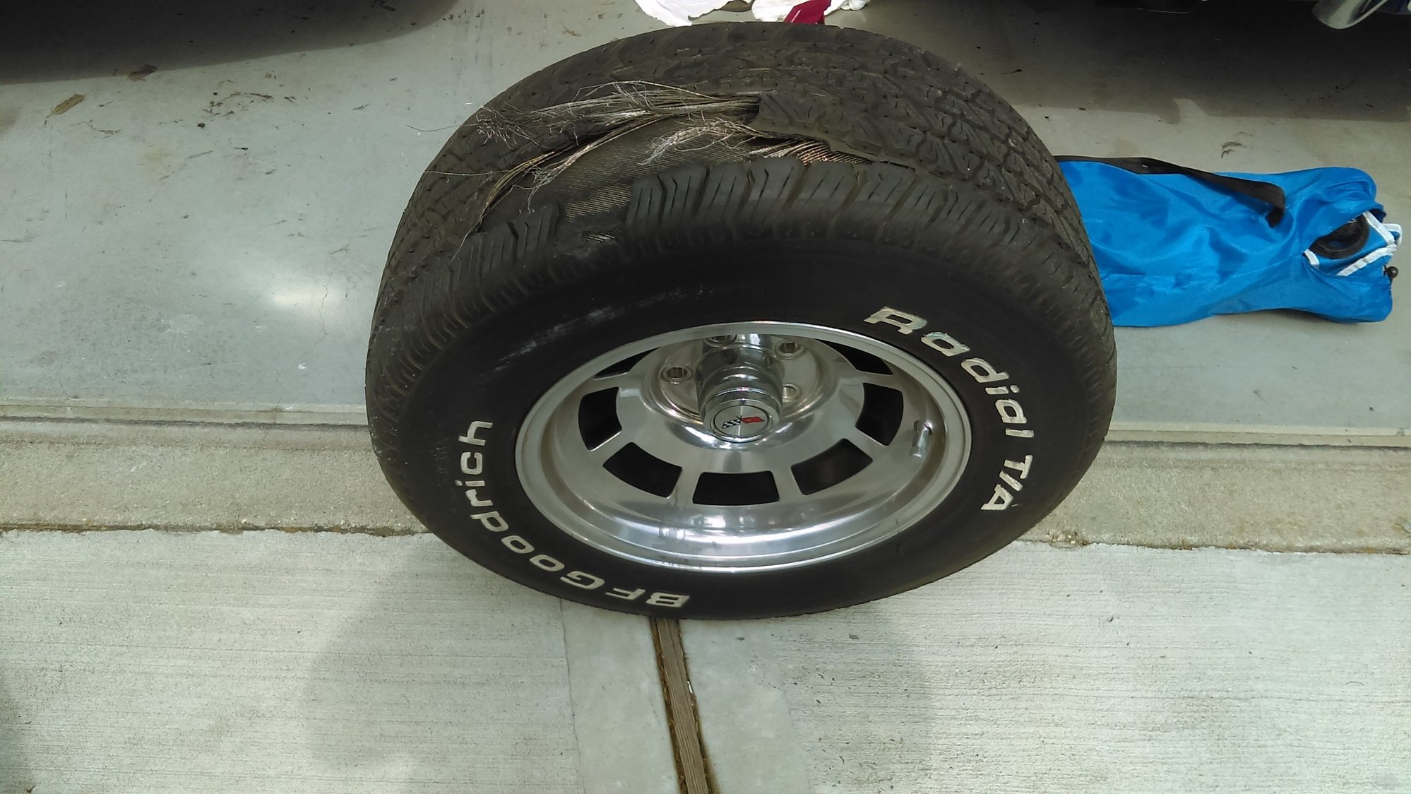

this is what happens
the steel wires do a great job on the fenders. my friends car, tire blew on the highway, luckey he never goes over 60 mph, lots of damage

Thank you everyone for the details and the quick response. My son and I have had this on-going (mostly from his Dad) discussion about replacing the tires just from the fact that we have had the car 10-years and we had no idea how old the tires were when we bought the car in 2009. Based on the decode information from BLUE1972, I'm pretty confident now that these are 23 Week (early June) of 1991. 28-years old!!! Holy Cow, has to be some kind of record and way past dangerous to drive. Agree with bradleyb66 that damage in fiberglass repair will be much worse than the cost of new tires.... and the pictures from BLUE1972 shows it all. Hard to argue with pictures.

My friends 81 has approximately $8k damage from the tire blowing. If you look at the tires that failed, there is most likely less than 3k miles on them, they are like new. He thinks he got them in 2001.
Also be aware that most tire companies are saying 8 to 10 years max on tires and Michelin is saying replace at 8 years.
Use a reputable shop, a club member just got tires from a "wholesale" tire outlet and they are already 2.5 years old. For most of us it a time thing not a mileage thing for replacing tires.
