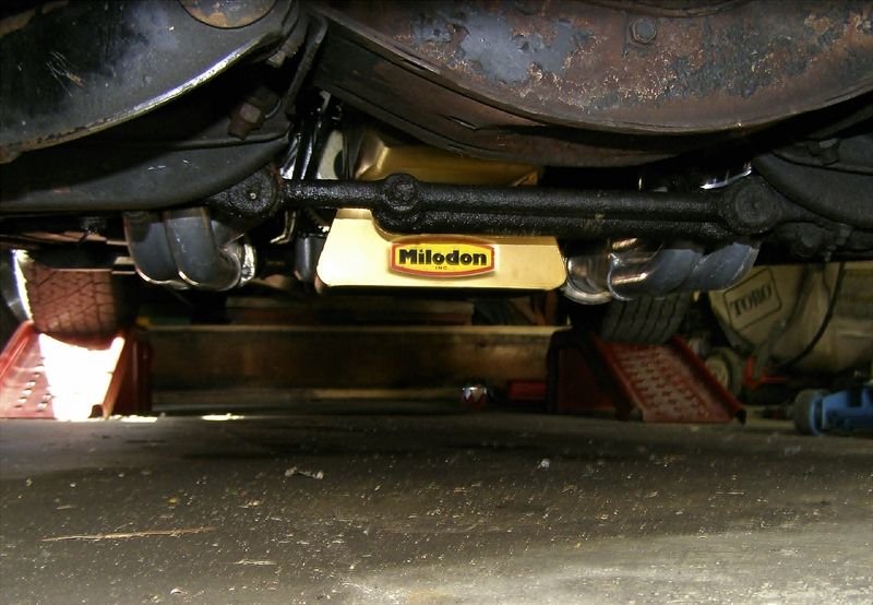

This is to everyone wanting to build big inch stroker SBC's. If you flip a stock 2-4 bolt block over you will see that the pan rails narrow towards the front. So when you are clearancing the pan rails for a 3,75 - 4 inch crank, (Yes you can make 408 ci stock blocks with a 4.030 bore.) You only have to actually clearance the most on the front cylinders and a lesser amount on the next 2 or 3 cylinders and mainly only on one side of the block because of the way the rods swing around on the crank. The type of block determines which high capacity aftermarket pans. Just ensure you get the correct for your dip stick (driver side or passenger)
I'm just going to say this and it is just my personal experience. People that build using bowtie blocks have a 40 year old mindset and are foolish. They are against learning anything new. They have several problems. the greatest is the max bore of 4.155. So in you case your 434 ci is at the max bore. So you are kinda screwed as the bore wares out because you can't over bore it. The other problem is that even with the splayed main caps it is only rated at something like 700 hp. the casting is weak compared to the more robust and 35 pound heavier Motown and higher end Dart blocks (not SHP) . which is kinda limited to 3.750/3.875 Which function very well in 1200 hp twin turbo motors. You are not saving any money buying a crap bowtie block and it has no future rebuilds unless you sleeve the block. I think that my Motown has a max bore of 4.200.
Dart and Motown blocks have straight pan rails. so you have to get pans specific to those blocks. I ordered my Motown racing with an 8 quart deep pan made for Vettes with a shallow front for up to 4.125 stroker cranks. On my stock block 396 I have a Morroso 8 quart drag and road racing pan made for up to 4 inch stroke but I had to mod the front to clear the cross steering arm. I've also seen another person here on the forum that ground away the top of the steering arm for the same Morroso racing pan.
I don't know much about bowtie blocks because nobody in the know would even use one. But someone like the tech guys at Summit racing could point you in the right direction in a racing side pan Canton or Morroso. You really want to have volume along with baffles and windage. Then you have to get pan specific oil pump pickups. I try to stay within about a 1/4 inch of the bottom for the pickup screen

Originally Posted by platinummaker
GKULL
Not meaning to hi-jack OP’s thread, but I have a Bow Tie block 434 waiting in the wings to go into the 72. What oil pan do you use in your 434 that allows crank clearance and fits in the Vette?
Thanks much
My former 427 abc used a Bow Tie block. The pan I used was a Milodon Stroker Low Profile, # 30908. 6 qt. capacity, and fit perfectly in my '69. https://www.summitracing.com/parts/mil-30908
Pics.....427 pan.....
My current 440 sbc (Dart block) uses a Milodon # 31505 low profile 7 qt. pan.
This one.....https://www.jegs.com/i/Milodon/697/31505/10002/-1
Either pan will accomodate a 4" stroke and fit in your Vette.
