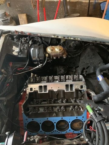

my apologies, I have no idea what spark plugs are in there now. I never bothered to look until recently when I changed the heads. I have a picture of the plugs when they were removed during the head install if that helps at all? Otherwise I will take a look when I get home and see if I can read any number on them.

I think that may have happened. I assumed he'd change them along with the heads and I completely forgot to ask but now I'm wondering maybe he didn't because of the sluggish acceleration, black exhaust pipes, difficulty starting sometimes and just the fact that it doesn't feel as fast as it should with all the mods done to it.

from that pic I posted they look like accel 576 plugs, that's my best guess but i'll confirm once im home. The 3294 is brodix recommended for pump gas and they aren't super expensive. I'll just get a set and eliminate that potential cause of the hesitation problem.
