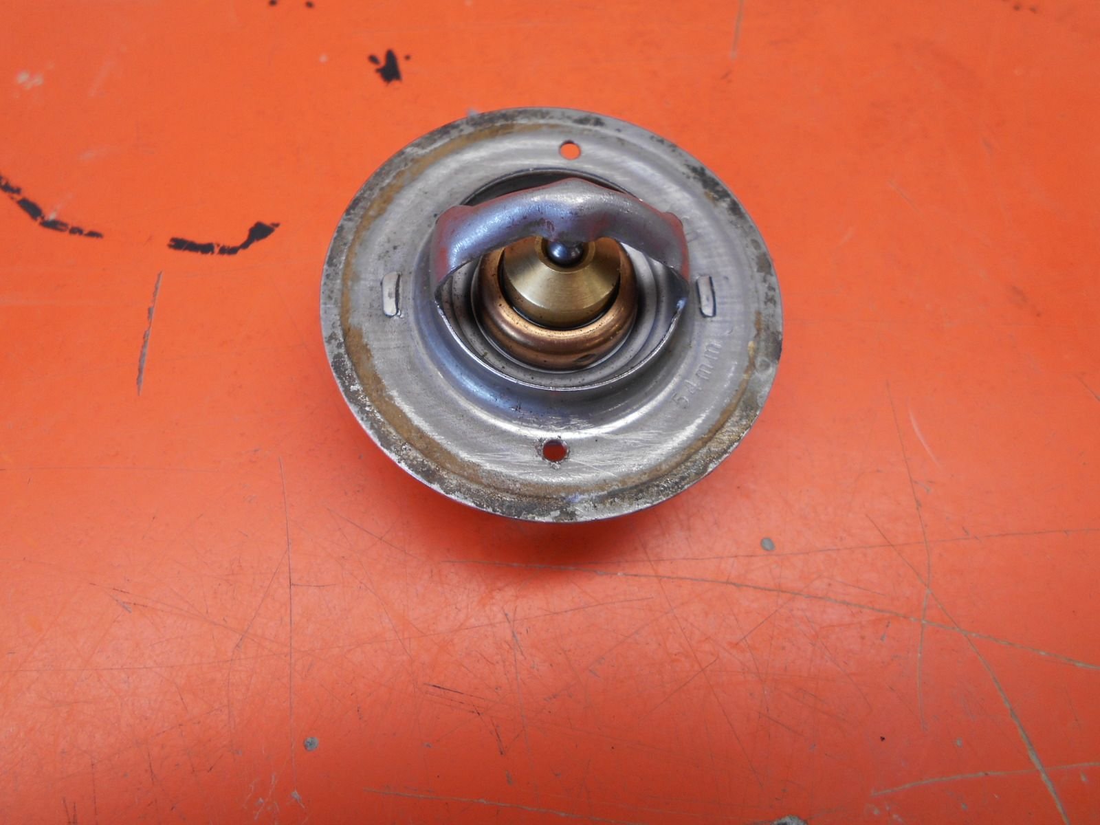

A couple 1/8" holes drilled in the T-Stat flange eliminates the need to remove the Rad Hose, Waterneck, T-Stat, apply new gasket, wait for the RTV to dry, put everything back together, etc.

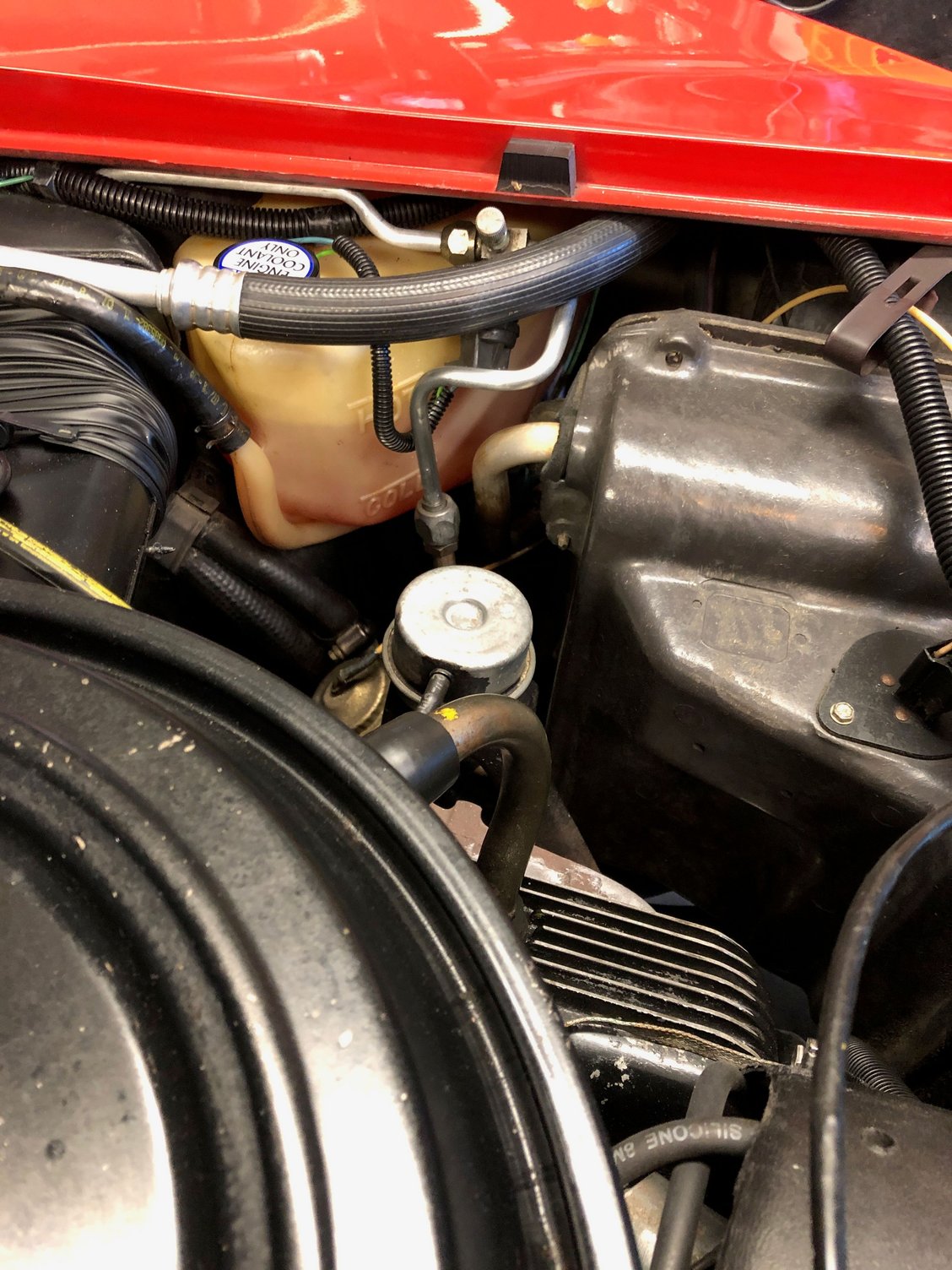

Coolant, being denser than air, will push air out of the block into the top of the rad. I did the following with my new rad. Filled rad up and then started cold engine with cap off. The coolant level had dropped. Topped up the coolant and replaced cap. Went for a cruise. Next morning, removed cap, started engine and checked coolant level in rad. It was down again. Topped up again. Replaced cap. Went for a drive. Third morning. Removed cap. Started engine. Replaced cap. Went for a drive. Air has been displaced by the coolant and gone. Overflow tank will keep rad topped up from here on in.

Two small holes drilled helps with the filling.

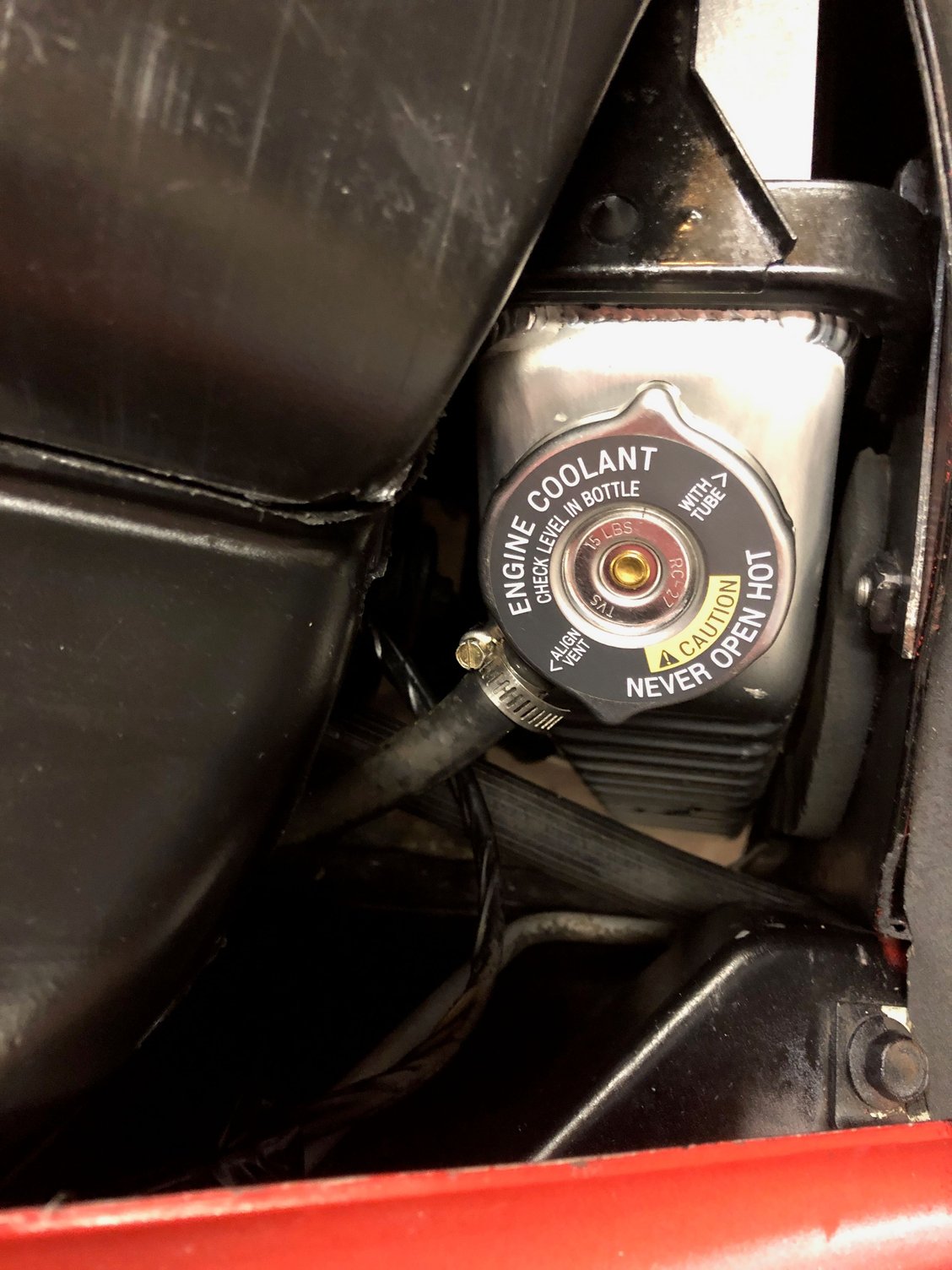

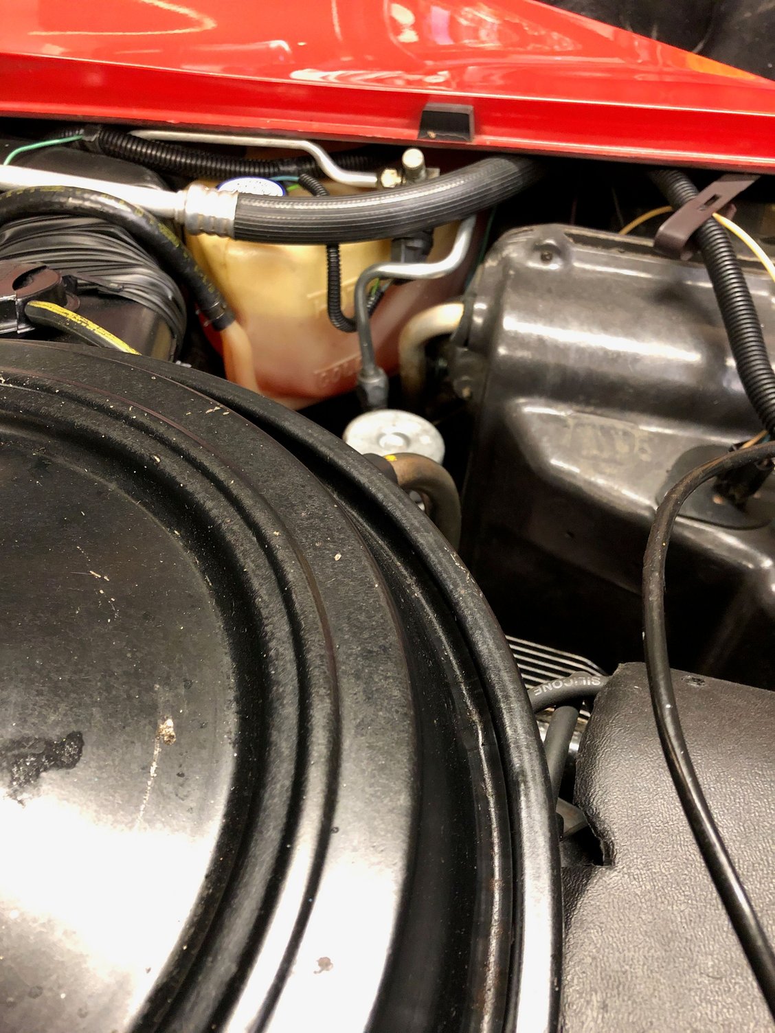

Thanks all, i did the front up fill when replacing radiator.. maybe it took a lot from before because i ran heater...i hope so...small whitish smoke at start up has me worried..
pics hot cold hot so far..working on timing now neve checked with harbor freight taiwan light..just need to figure a way to check rpm accurately as my tach is not accurate low.
Hot
Cold overnight
Hot today

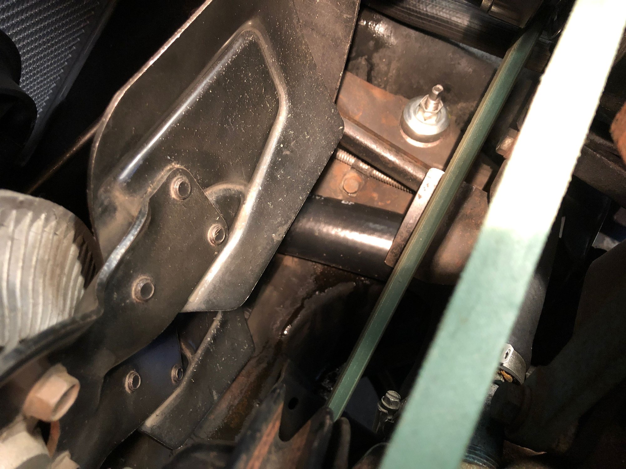

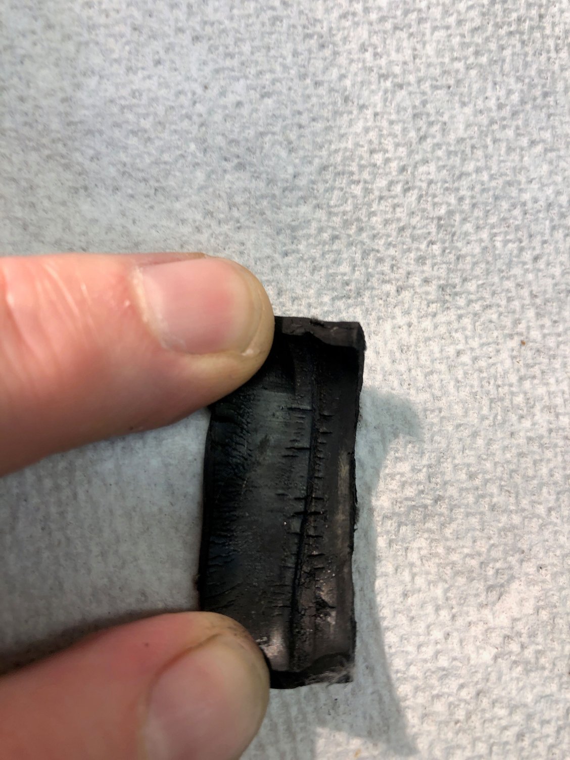

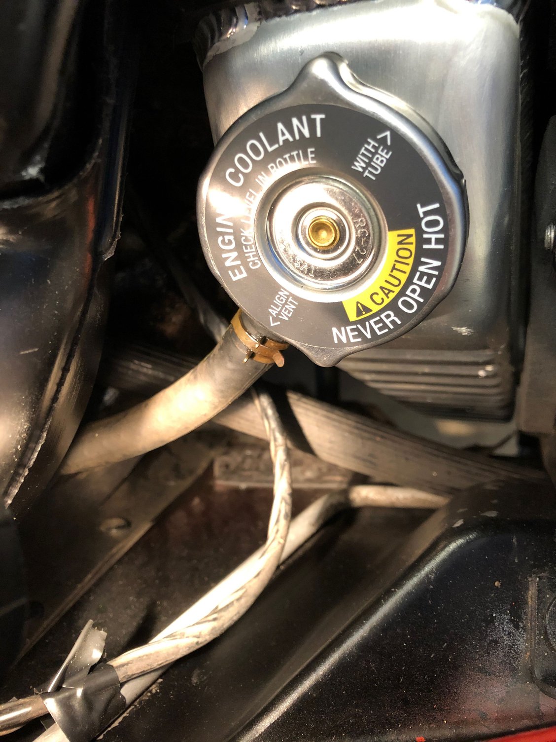

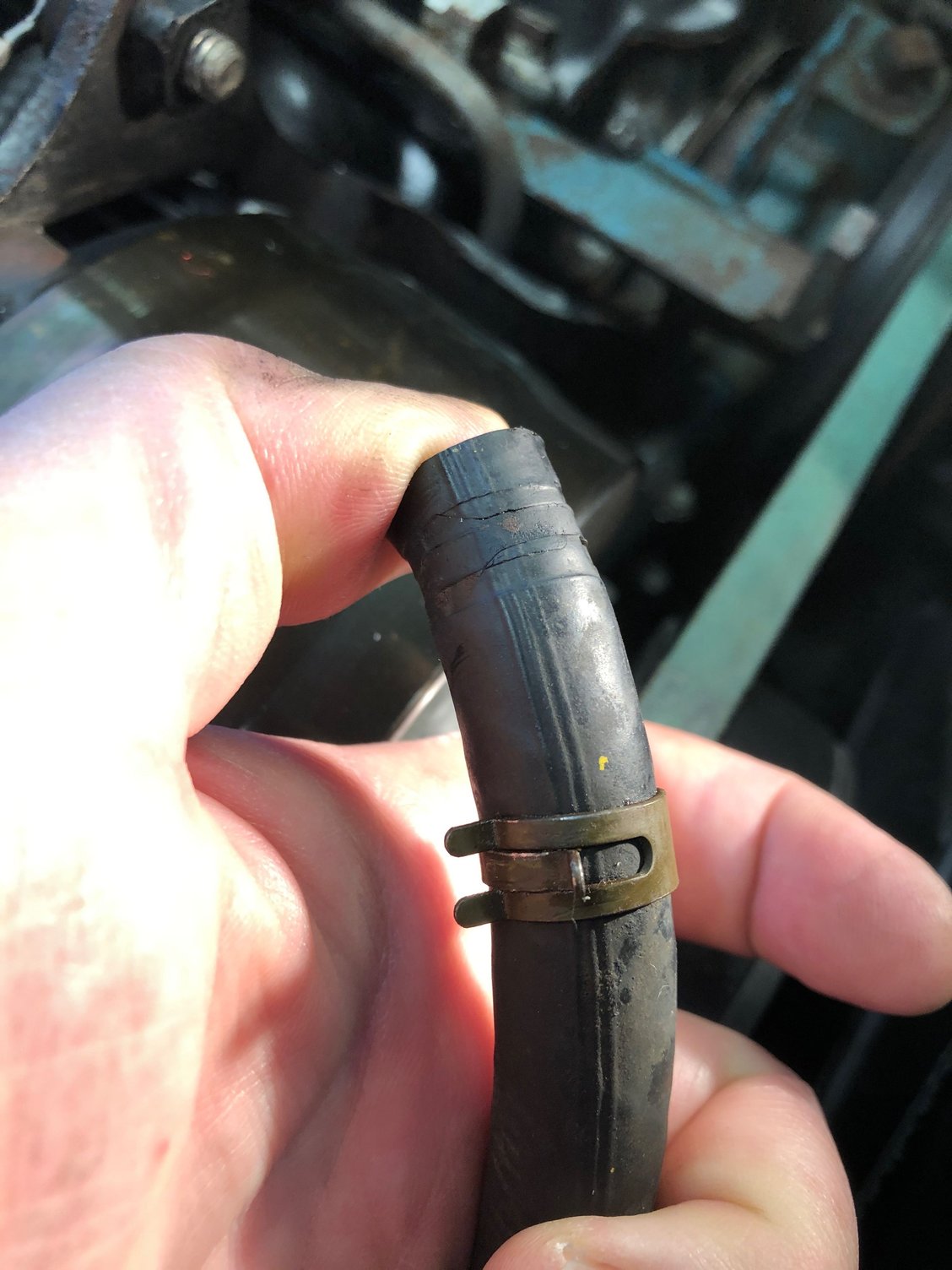

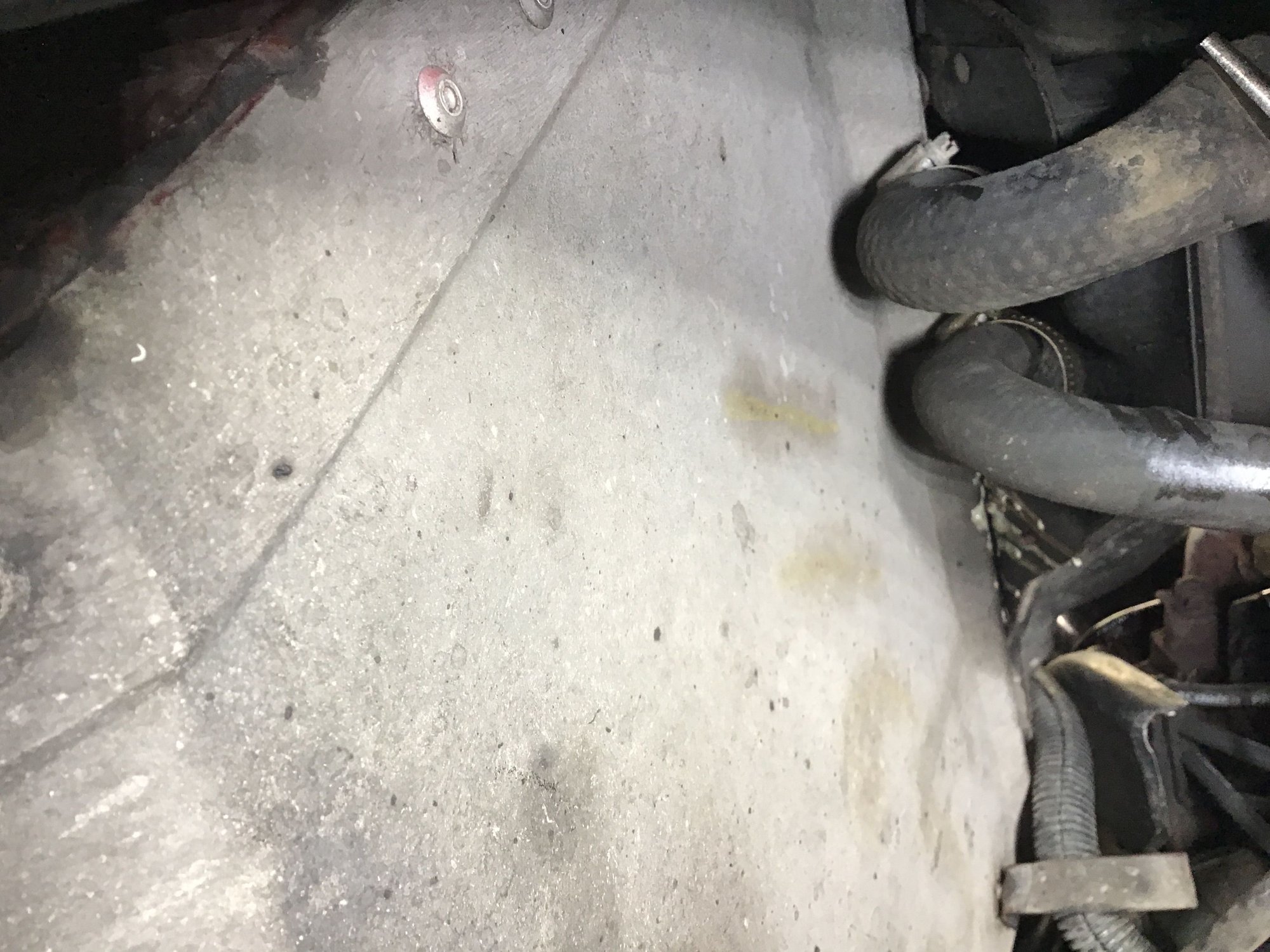

while checking timing noticed liquid bottom fan shroud, traced to overflow bottle hose..yes original..thought slit but think it was just cracking and 40 years of that groove from old radiator..cut off inch and replaced, will see.
thanks for help..hoping this was issue but will see
Traced to hose
Wet but nothing obvious and radiator welds look ok
Thought cracked through but not
Appears no cuts through but groove permanent and some fractures

Oem clamp still leaked, worm clamp on. I assume they get weak when older? I will try to find new one as i hate the look of that clamp...
so far dry..my God what a great day to drive...loving the excuse to test drive

got new hose and clamps 3/8 inch from a sponsor. Fixed leaks at both ends of overflow as the old hose was just too worn out to seal and diameter larger even with worm clamp tight..lesson learned.

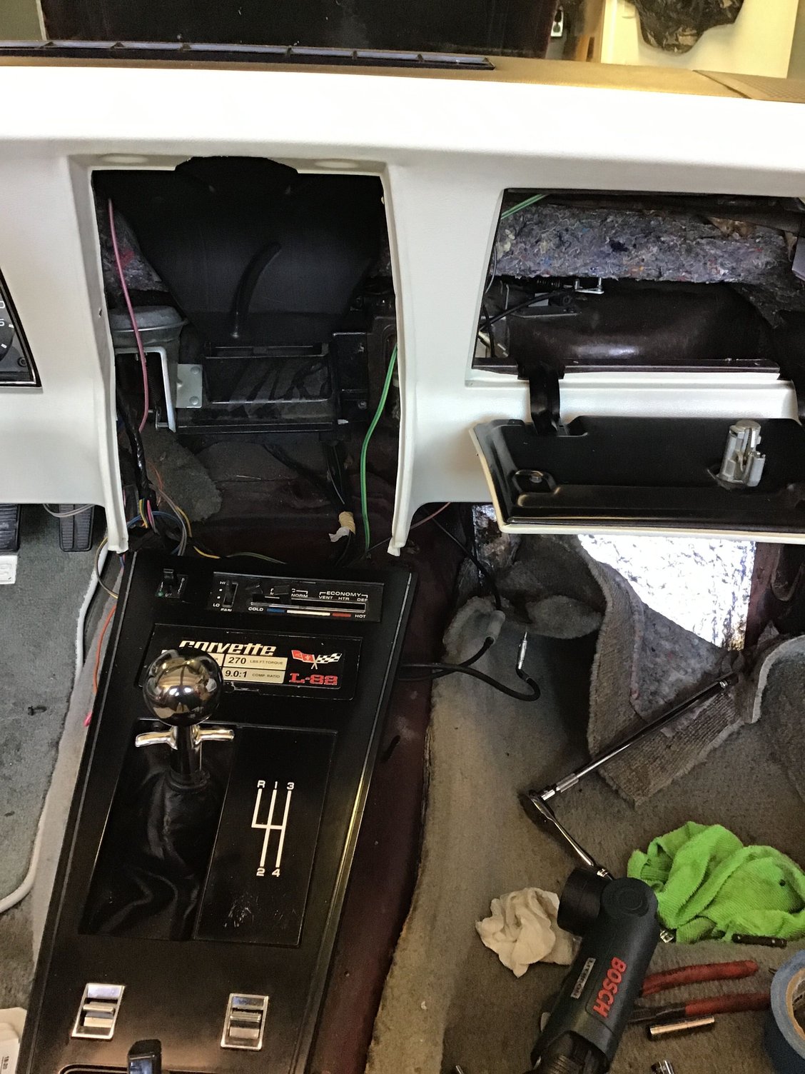

i also found another major coolant leak, cold fall driving day heater on windows down....smell of antifreeze...defrost fogs windows..ugh....on a plus side the vacuum hot water shut off works..no heat no coolant loss when set to cold! Nomanual valve needed for me.
open for 79 ac heater core tips tricks references..iwill buy core from partner with seal kit..debating doing what some threads say to have leak checked and resolder?

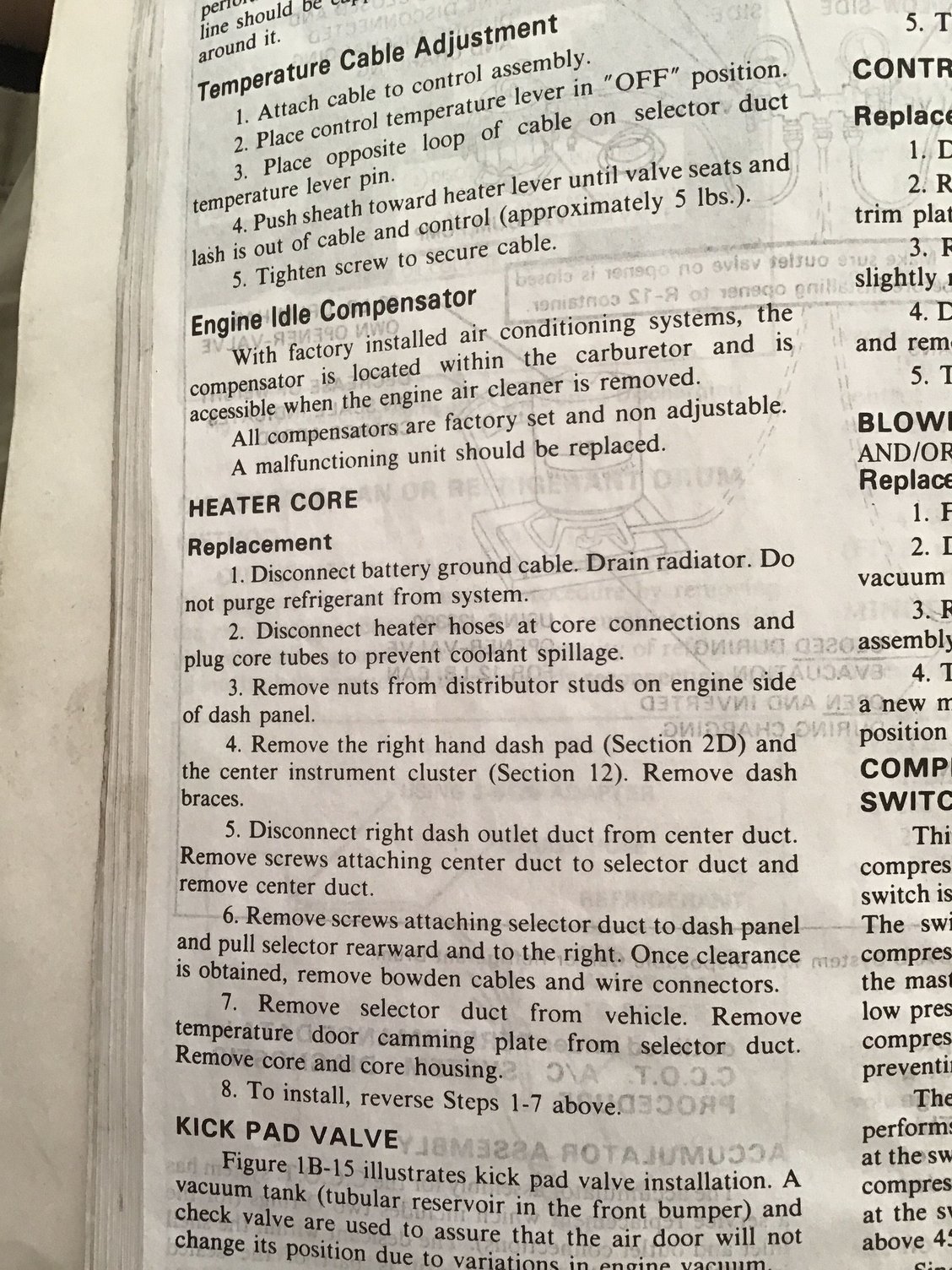

lol love the service manual..only 8 steps lolol..and i dont see a seperate right left dash pad..
Easy!

Unless you're a spritely contortionist; when working under a vette dash, it's often much easier to first remove seat(s).
Old Oct 13, 2019 | 02:22 PM
interpon's Avatar
interpon
Joined: Jun 2019
Posts: 7,653
Likes: 2,468
From: Indiana
good advice..nope 6/3
ha c3 sunday..ordered paragon hoses core and seals...hoses not off yet but so far the usual pita..some poor previous duct work..

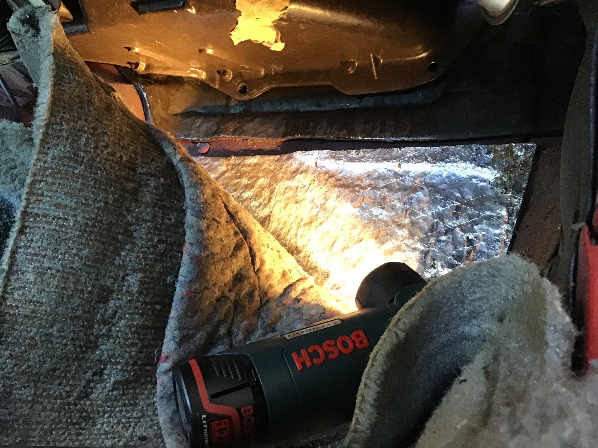

Have not broke anything yet..new radio time? Fix clock???
Carpet soaked

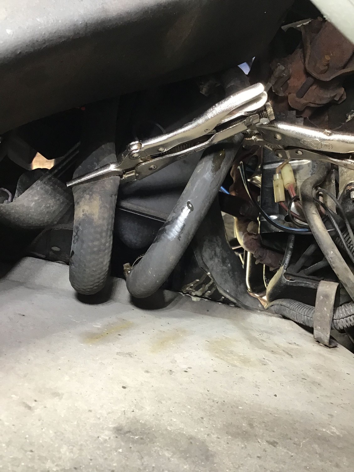

Are these original clamps..wtf put these on before evaporator?
Im not draining coolant
Here comes the cutters
