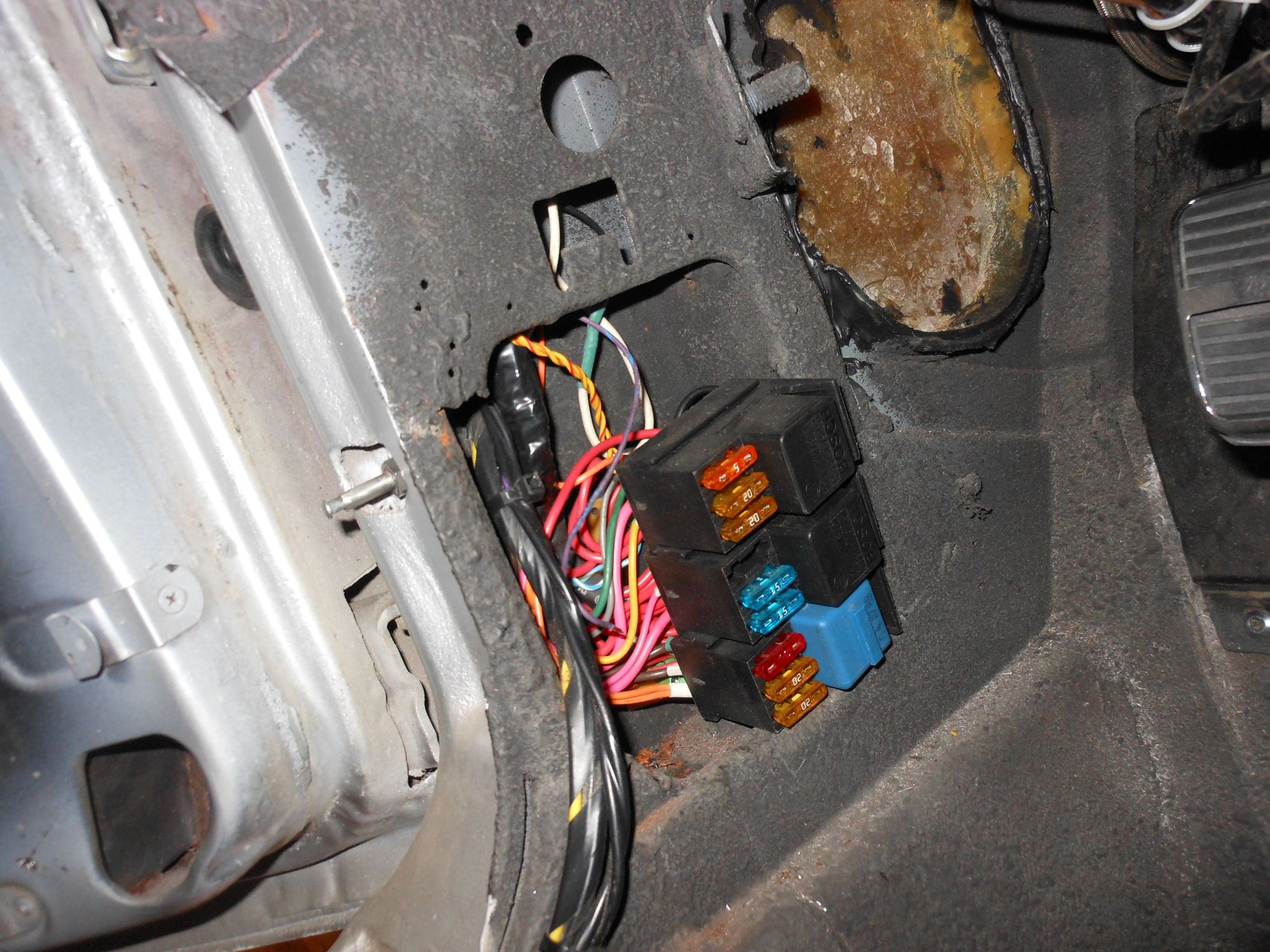

Where are the relays?
I made up the harness for the door locks and the electric exhaust cut- outs- I'll be putting then in the pass side dash . I already have the console area full up with power window relays /vintage air controls/heated seat controls and the piece de resistance - heated and cooled cup holder from a Cadillac Escalade!!!

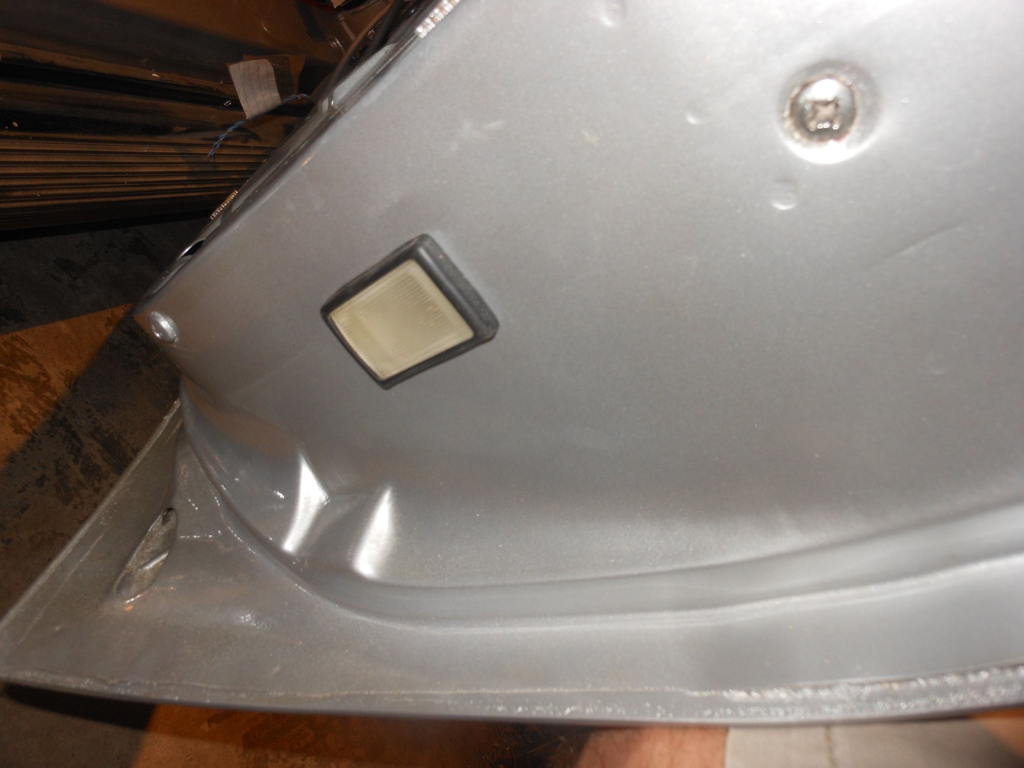

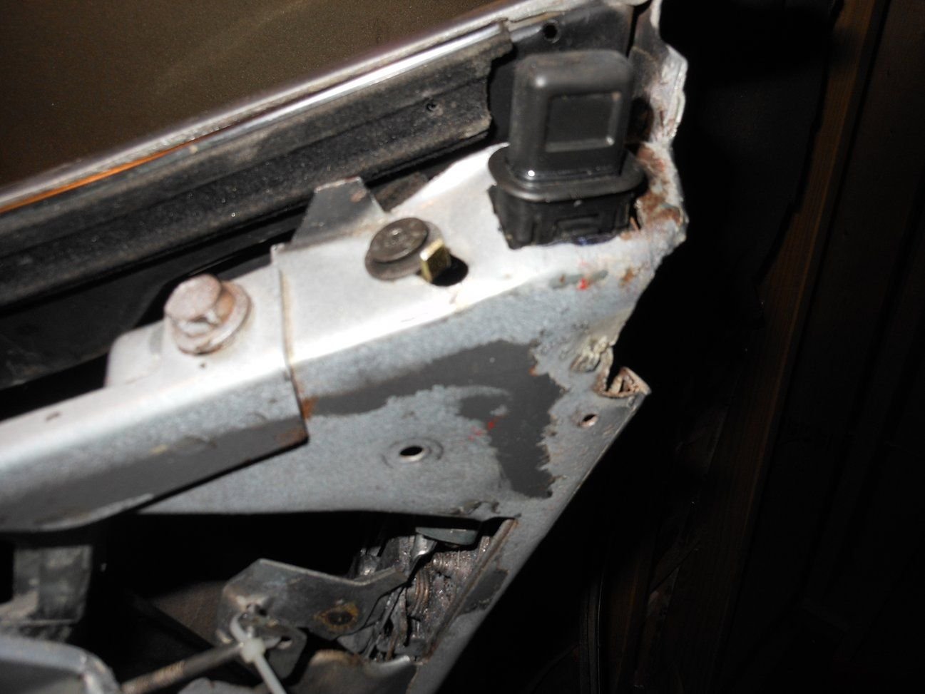

I'm also redoing the door panels and have moved the door lock altogether- used some buttons off a M-B 500sec -
Oh- I added a a courtesy light ( thanks to my BMW parts car) on the side of the door-

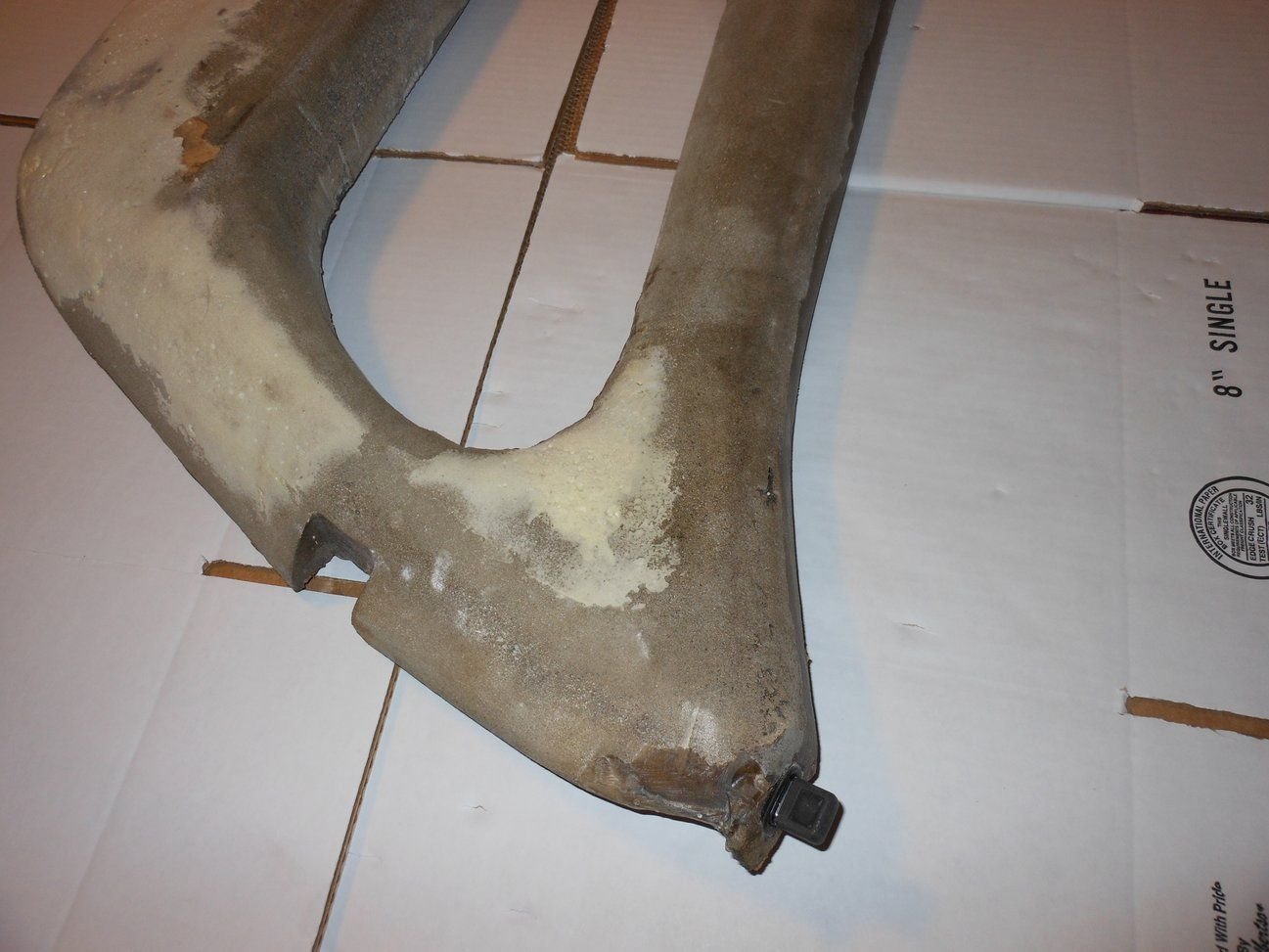

And the last piece to add -is the side mirrors- added some turn signals to them-

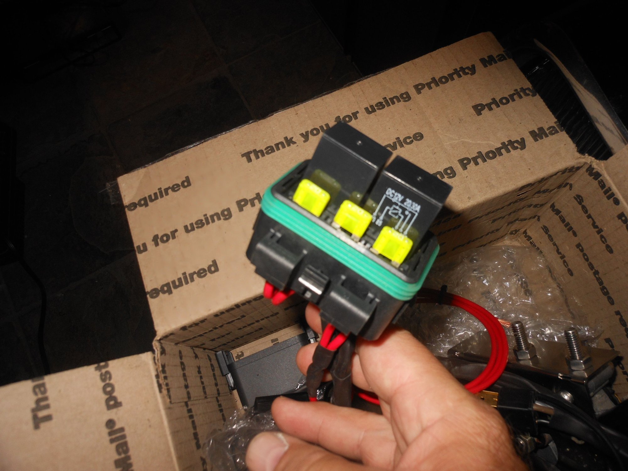

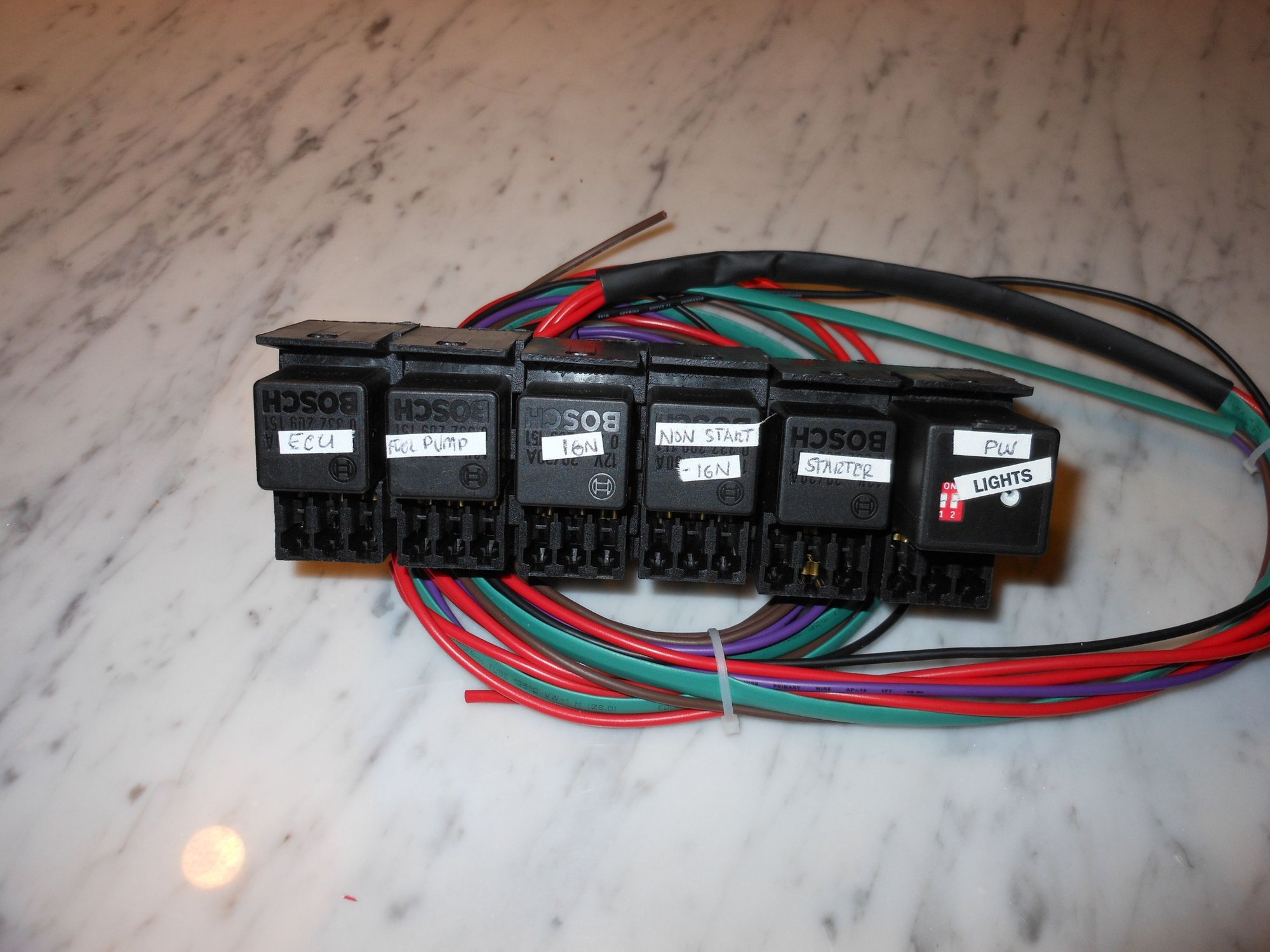

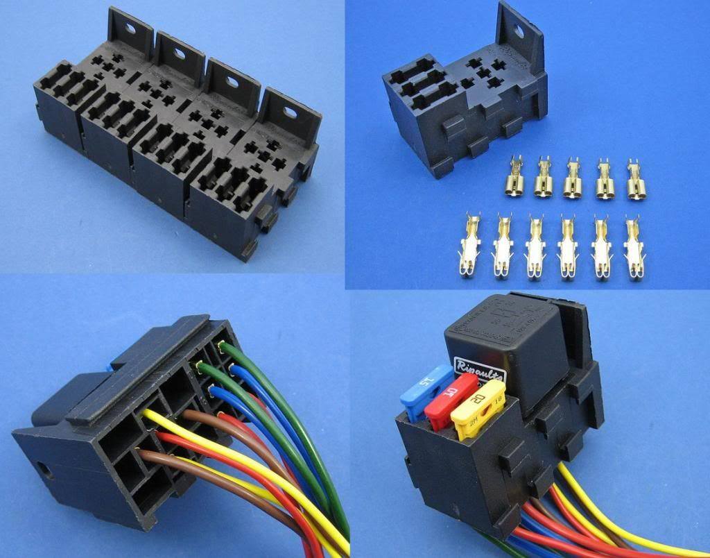

I have looked at those-

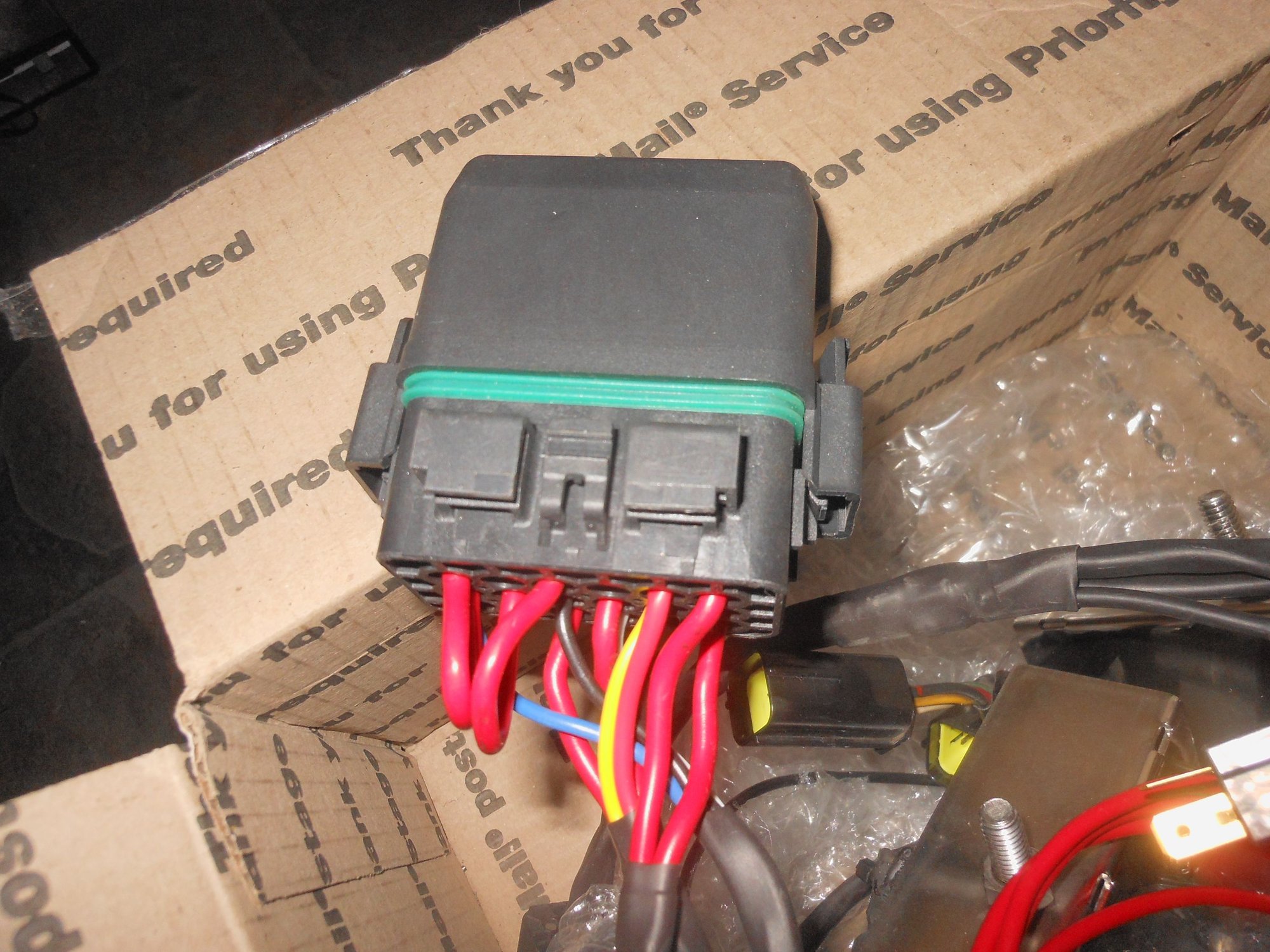

Right now inside the car I am running the modular ones with three fuses- fully configurable..
For outside the cabin - I found the littlefuse 280 micro relays- they have several different sizes - are super small- fully configurable and waterproof.
I used three of them to replace the fusebox- and while I was at it- moved it so it was a little easier to get too!!!
