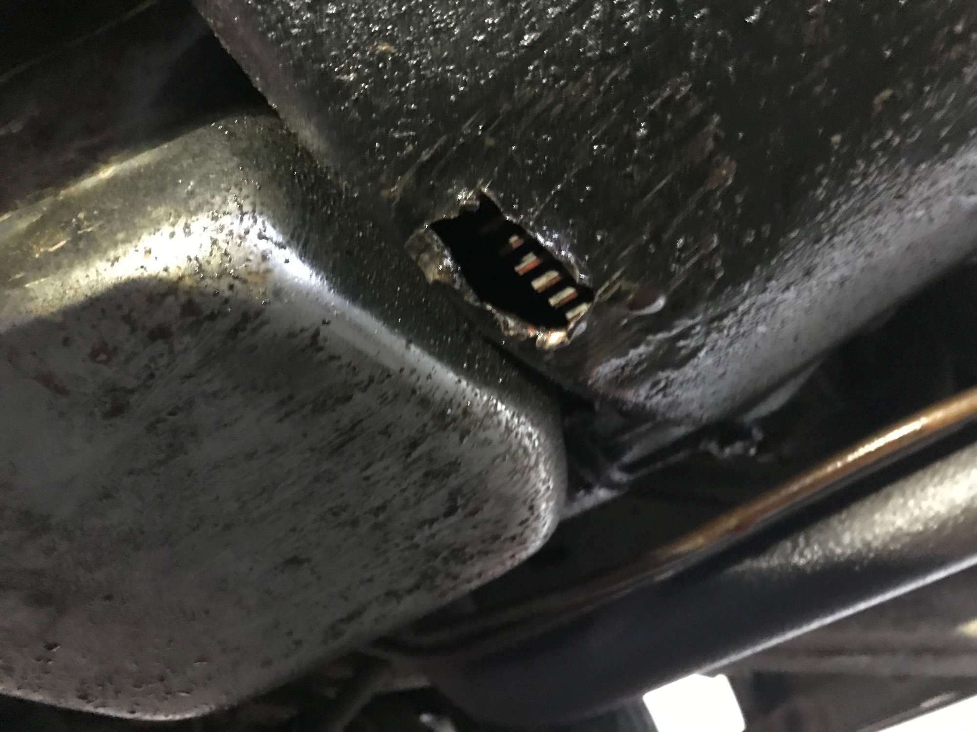

Thank you. I also found a puncture in what I believe is the transmission transmission inspection cover from what I see. You have to forgive my ignorance with this. I am far from a mechanic. I’m assuming the leak came from hose leak and this hole combined. I’ll look tomorrow at the hose. Here is the pic of the hole.

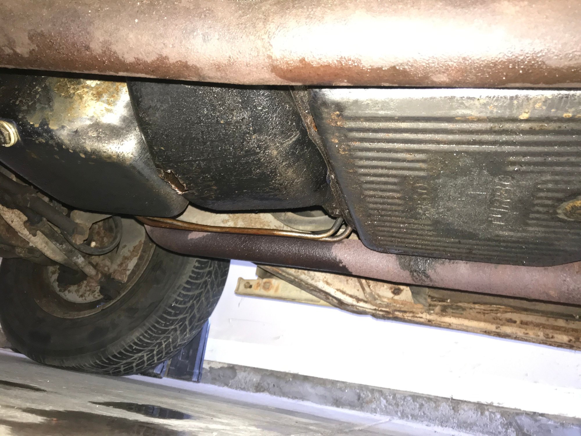

Looking at the one photo, appears to be a lot of gritty material on oil pan. Does not appear to be normal road grit but rather a shiny metallic look to it. Don't know what that's about.
Hole in dust cover does not match flywheel perfectly but close. I suspect somebody did not install the cover correctly and was damaged or somebody took some tin snips to it to get access to the flywheel.
Exhaust pipe passenger side really damp where trans line is. Like said before, leak must be at the Rad and runs back, burns off. Trans pan itself appears to be somewhat dry. That's good.

Pull the dust cover and see What's Up With THAT.

So that pan is supposed to have a hole there where you can see the fly wheel?

Yes. Maybe a 3/8" drain hole.

ok. So should I replace that dust cover or do you honk it’s ok? I’m thinking change it since it’s only $20-$30. However, it looks like I’d have to remove the transmission pan to do that.
No, on the tranny pan in the way. The dust cover / stone shield will fit, four bolts, just have to play with it a bit.
