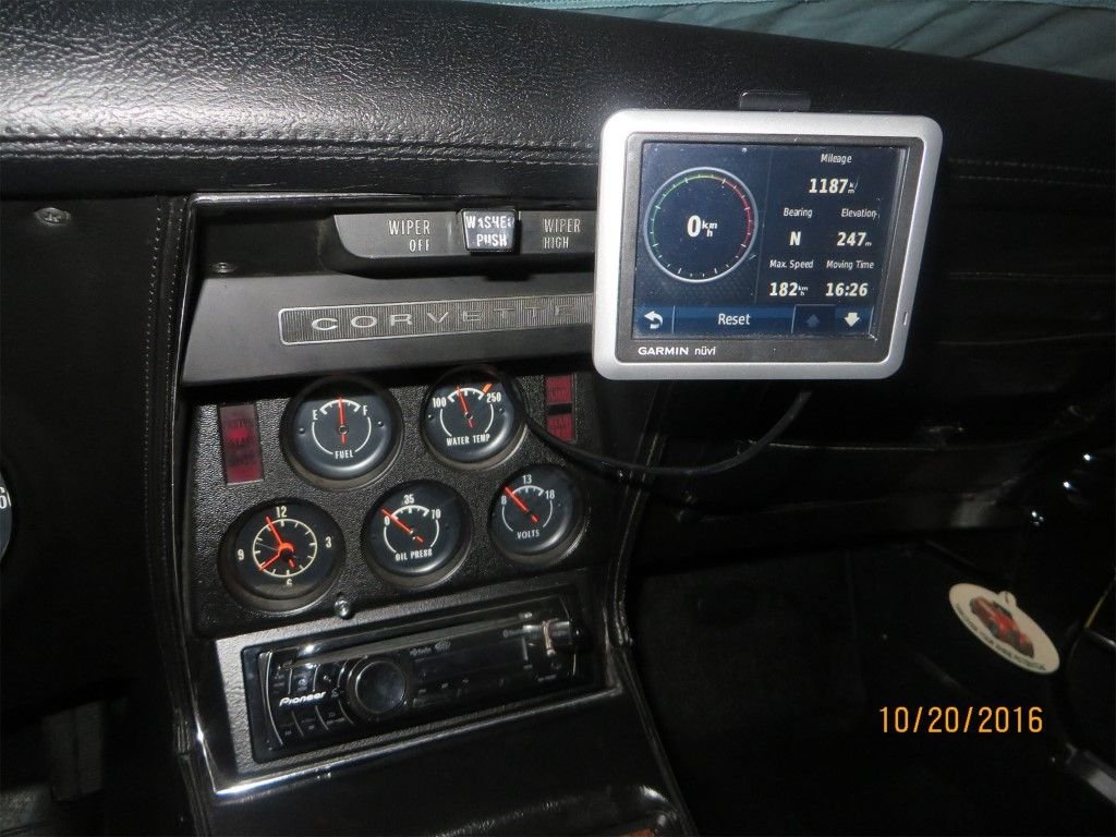

I just us a small GPS set to speed for a reference but multiply 6 x the speed limit to get to MPH is pretty quick

I use a gps also. You don't need to recalibrate the speedo. Just change the faceplate.
