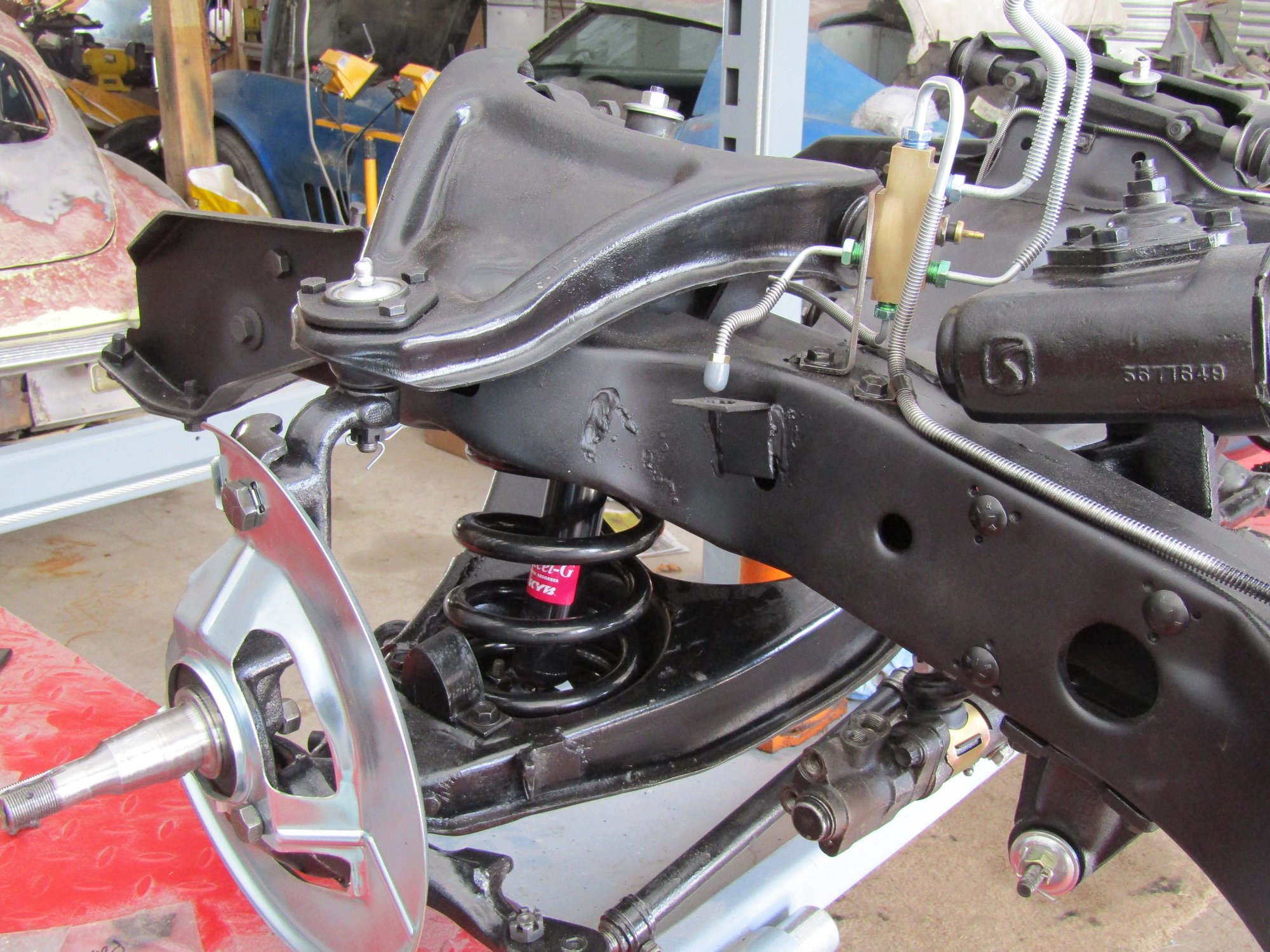

I have the steering wheel off and that seat is out. I was putting the car back together after a frame off restoration. I thought i was going to keep the brakes manual but i wanted to know how hard it would be to go with power brakes.

Old Oct 21, 2019 | 11:23 AM

Originally Posted by colo69
what do you mean eek?
If you are referring to me... that’s awesomely stunning work you gone and done there !
it was more of a WOW ! actually
