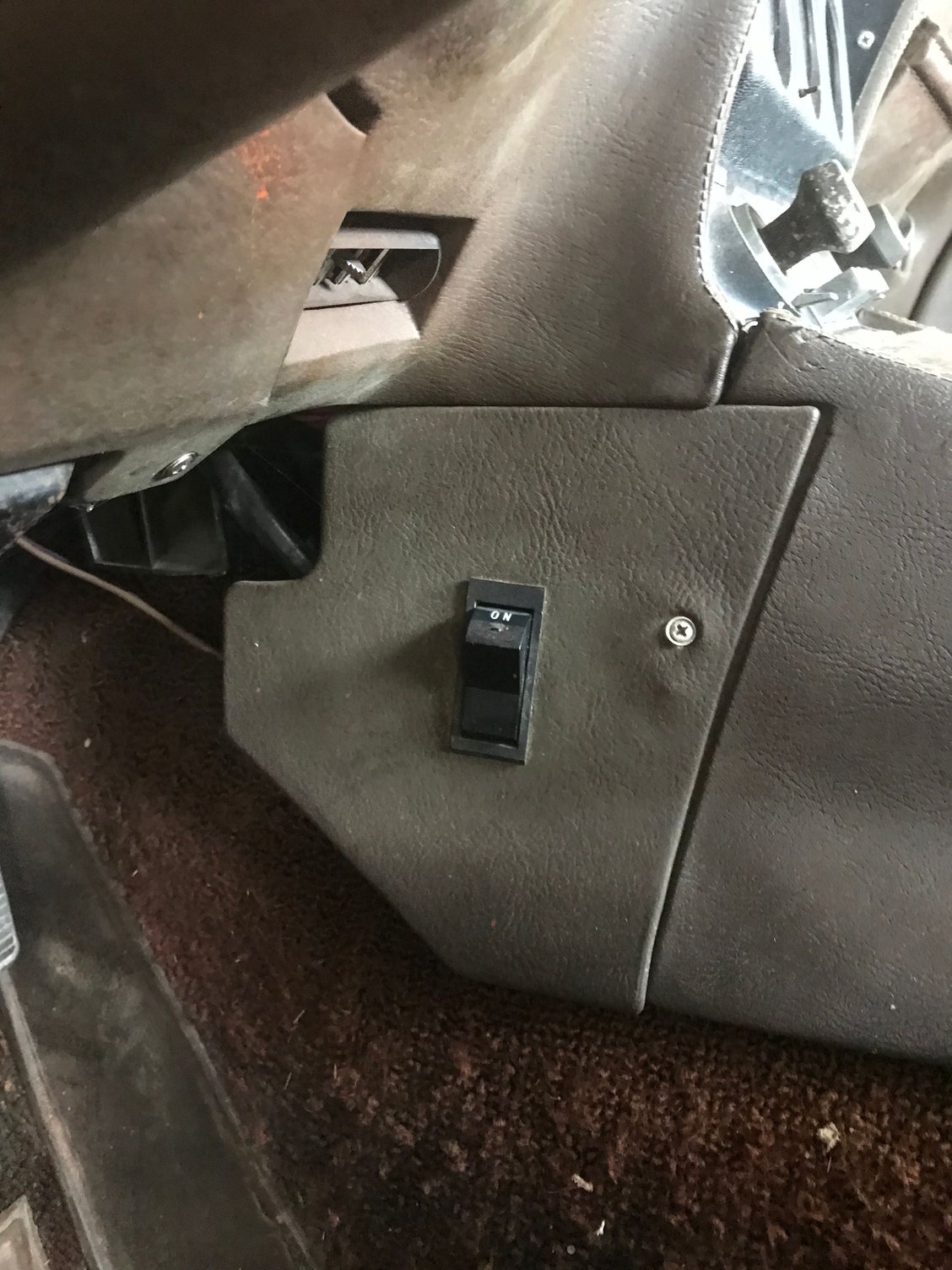

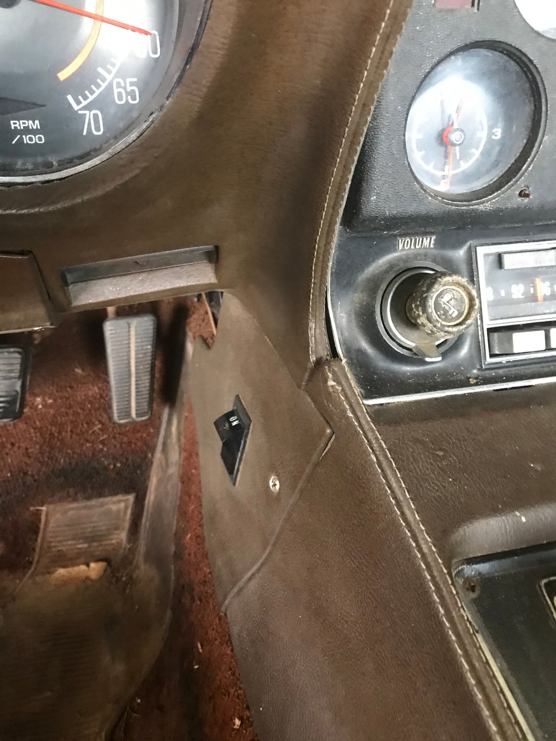

Does anyone know what this switch is for?

On the C-2 Corvettes, that was the spot for the electric antenna. It used a different switch though. Jerry

Rear defroster switch

What year is it? I think the later C3's had a rear defogger switch mounted there??????

my 75 has that same switch, it's for the rear window defogger
