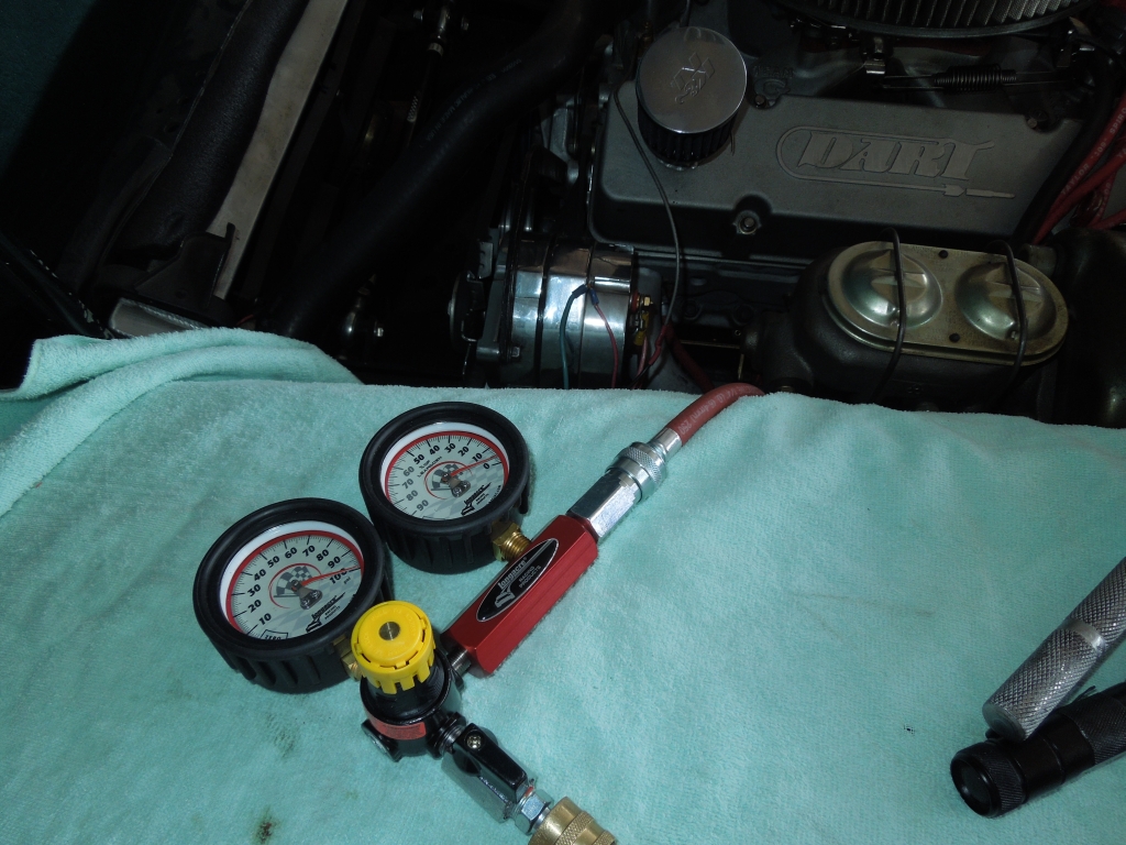

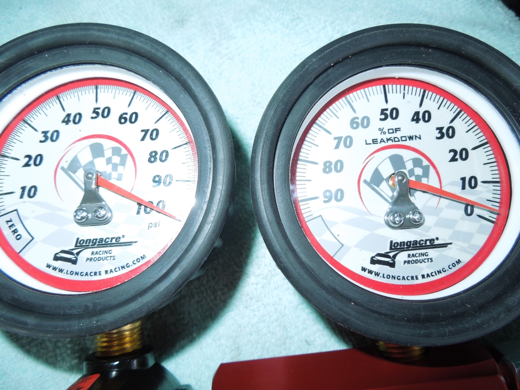

Leak down testing is given as a percentage. 10% is a pretty worn out motor. Was it rings or the valves leaking.
New quality rebuilds are less than 3%

This was last year on my 396 stroker motor. leak down was perfect , actually amazing for an older motor. But I had visible blue smoke from the valve guides leaking oil around the stems under high vacuum. Like between gear shifts.
