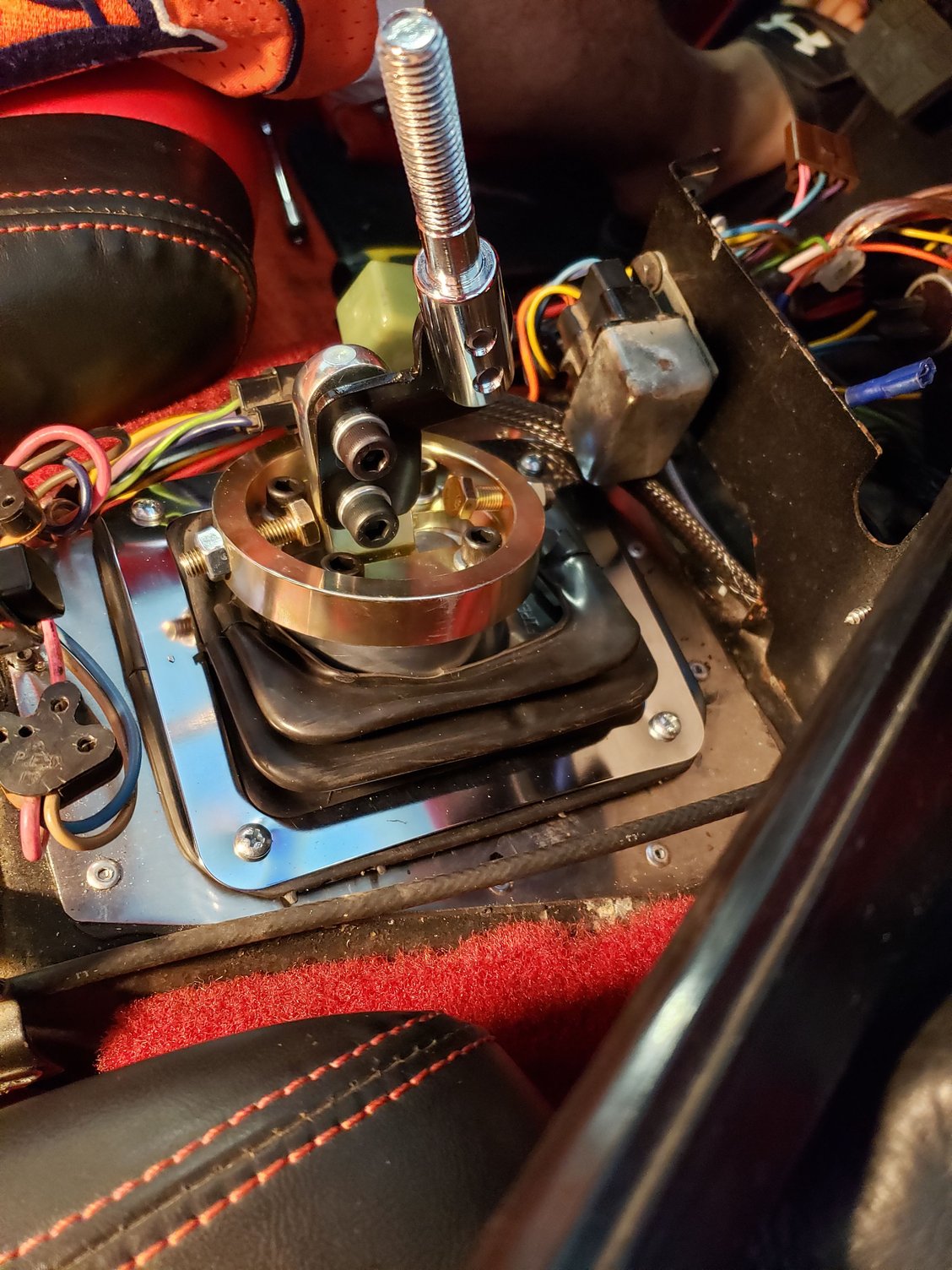

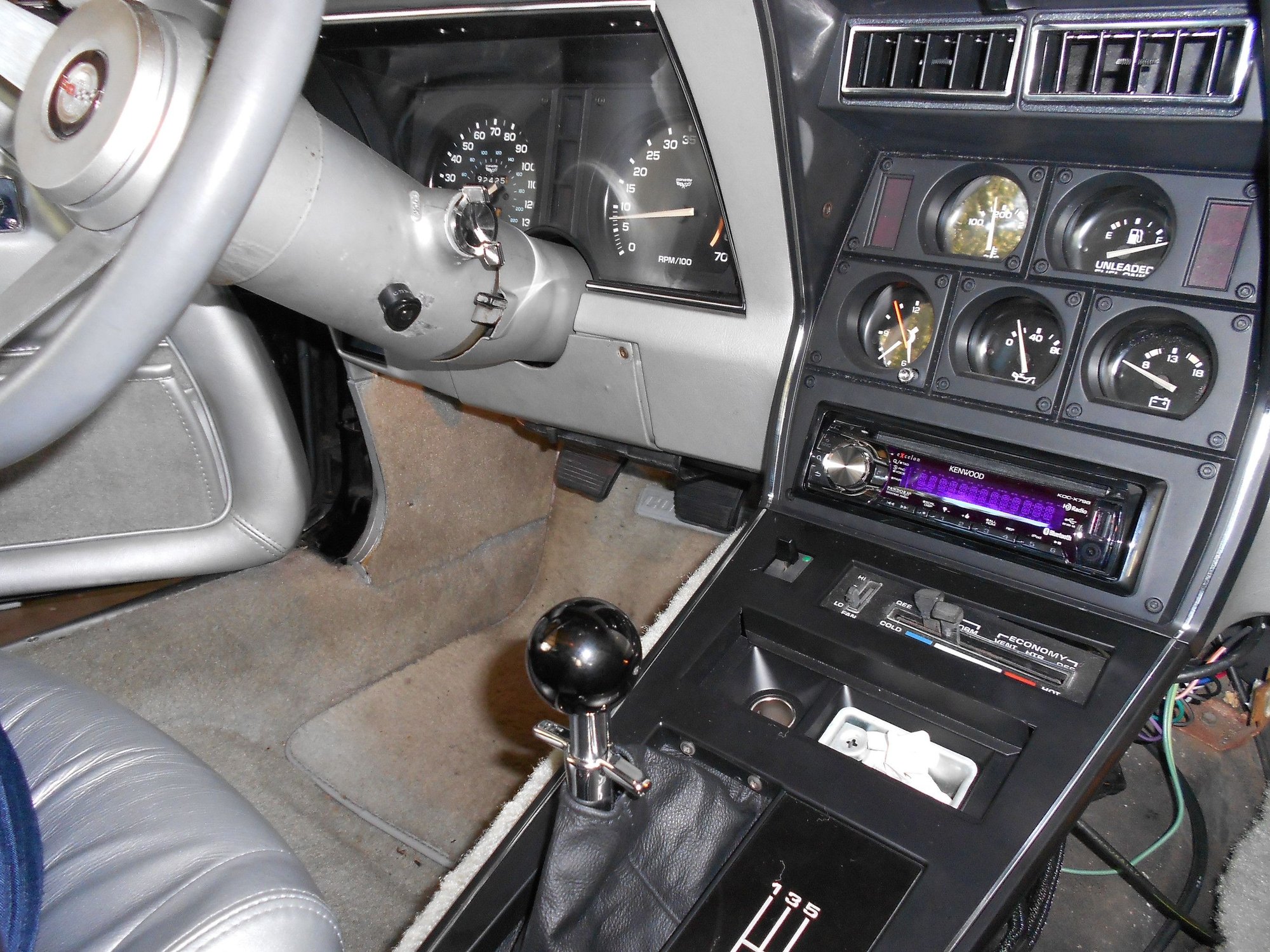

I just swapped a T5 in my '80 earlier this year. Tried to save some money using the stock camaro shifter that came with the tranny, but it was terrible. Felt like mush. Paid the money for Pro 5.0 and it a world a difference. Much more of a crisp feeling and the throw is much shorter which is nice. I have absolutely no regrets.I think it feel great.
IMO, overdrive alone is worth swap for me. So if you're on the about swapping, I don't think the feel of a shifter should dictate whether you swap for overdrive.

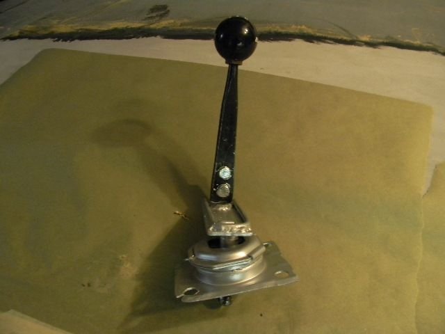

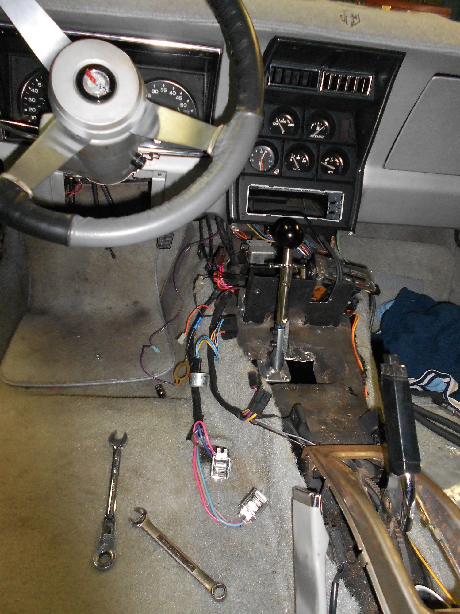

Nope, it don't come up through the gate in the stock location unfortunately. It's to far to the right, but with some work a dummy vette stick or hurst
stick can be modified to look correct, like others have done. Plenty of pics here on the forum.
On my 2nd and current T5 conversion in my 77, I made my own. Old pic, it now has the stock vette stick bolted to it.
Not nearly as nice as the hurst but that's ok, no complaints. Good luck, you will love the OD in your vette.

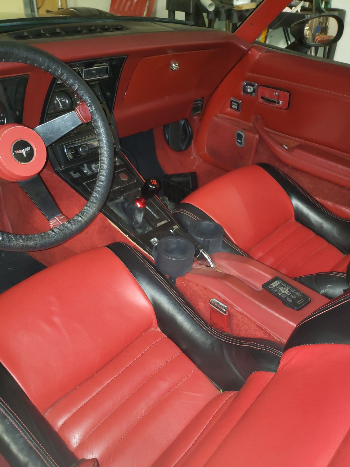

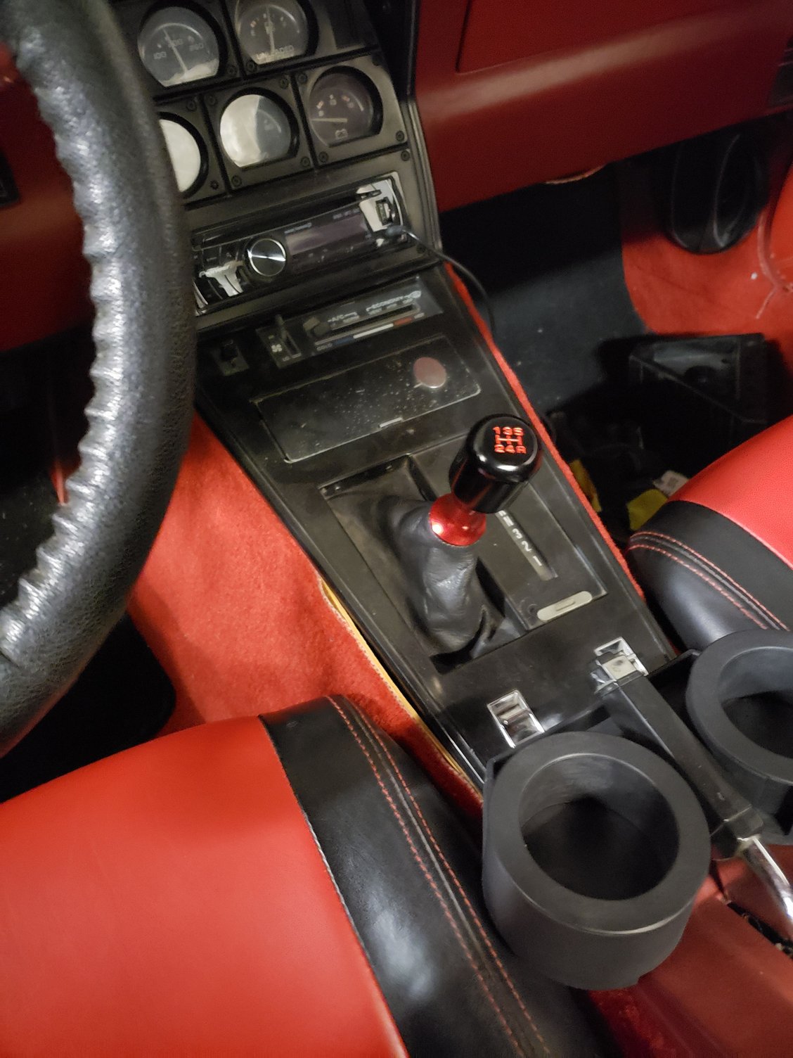

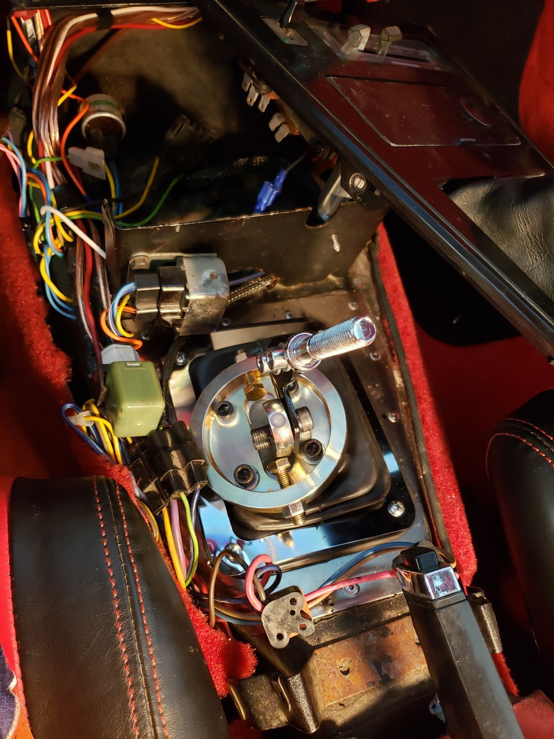

Sorry been working on a vortec swap! I used the original rotated bell which actually helped put the shifter closer to the stock position. The really nice thing about the pro 5.0 shifter is it has a stub that the shift handle bolts to. So I was easily about to make a simple bracket to compensate for the rotated bell and bring the shifter up the correct location. Then I used the upper part of shifter of the handle of a cheap must shifter which worked out great. Also gave me a lot more options for shift *****.
Here are some pics. Unfortunately , I lost most of them when my phones sd card corrupted last week so I don't really have any good ones. I'll snap a picture of the shifter now with it all put back together. If have any questions, just let me know!
WOW !!!! That looks bad@ss !!!!!
That boot is... well, where did you get that from? How is it mounted ?
THANKS

Boot is just a generic Mr. Gasket. It either came from Summit or AutoZone. Not sure which! After I cut the dip in the tunnel from the auto shifter, I fabricated and aluminum plate to cover the whole. I used seam sealer and riveted it in place. Then I cut a rectangle in the aluminum plate just big enough for the shifter to fit through. Then cut the gasket to fit the base of Pro 5.0 shifter. The gasket flange is thin enough to bend and shape around the side of the tunnel. Then used sheet metal screws to fasten down the gasket flange. Took some pictures of the final product.
