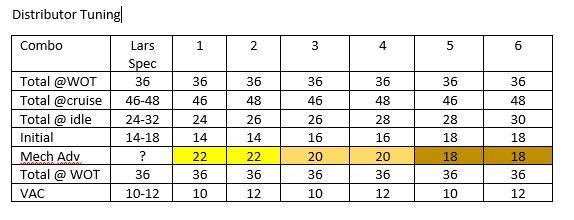

I am currently tuning my distributor for my LS6 clone.
Thanks to the great advice from this forum, Lars and others in this prior thread:
https://www.corvetteforum.com/forums...requested.html
I came up with my combo as a starting point as I have no running engine to pre-test it in.
I thought I would share this ""tuning chart" in case it is helpful to others.
BTW my BB has a 230/240 degree solid roller, but should idle like a L71, L72 or LS6,
Your preferred "spec" may need to vary if your engine combo is different.
My "530" distributor cam in my Vette tach drive distributor has too much mechanical advance (the 30 means 30 degrees)
Larrywalk identified for me that a "722" cam from a 1965 L76 327/365, has a much preferred mech advance of 22 degrees.
And believe it or not I found one on E-Bay!
So after going thru Lars papers, and buying a few parts, this is what I came up with.
  • 722 distributor cam for 22 degrees mechanical advance
  • B26 vac cam for 16 degrees vac advance all-in at 12 inches.
  • LARS VAC limiter to limit that vac advance to 10 or 12 degrees.
At that point the vac can should be all-in at around 10 inches and hopefully my engine idles at 12-14 inches Vac.
If not, further adjustments will be required.
Here is a chart with the range of possibilities for tuning with the above parts.
I'll start with combo #1 or 2 for Dyno day, because it is the mildest and requires the least parts modification.
Other combos require further welding or modifying of the distributor cam and I'll wait until I actually drive the car to do that level of tuning.
BTW we just scheduled DYNO DAY for Nov 7th or 8th. It should roar soon!
On Dyno day I'd like to dial in carb jetting, total and initial timing and maybe idle or cruise timing.

Nice guide for iron heads. You may want to include 20* initial in your chart for analysis.

what combination of springs are you using in that chart? You typically have 3 choices silver, black and gold, and combinations of the three. That adds a whole new dimension to your test matrix.

Lars recommends mechanical advance all-in by 2800-3000.
So I'll start with the Gold Mr Gasket springs and see if that works.
If not I'll have spares with me on dyno day.

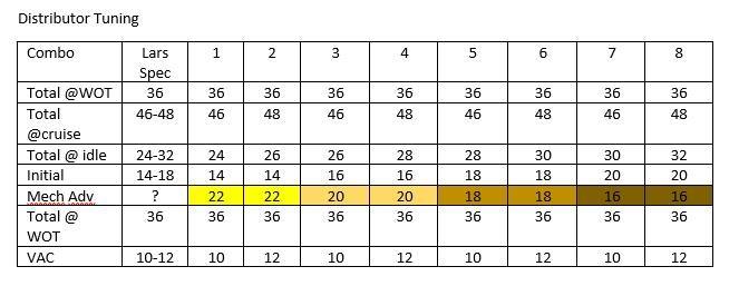

Good idea!
But that is a lot of initial.
Does anyone really run this much initial?

You are tuning for what the engine wants. It may not want 20* initial but may want 22* or 17* for best vacuum/idling which relates to peak cylinder pressure. Something to look for on dyno day. Have fun!
