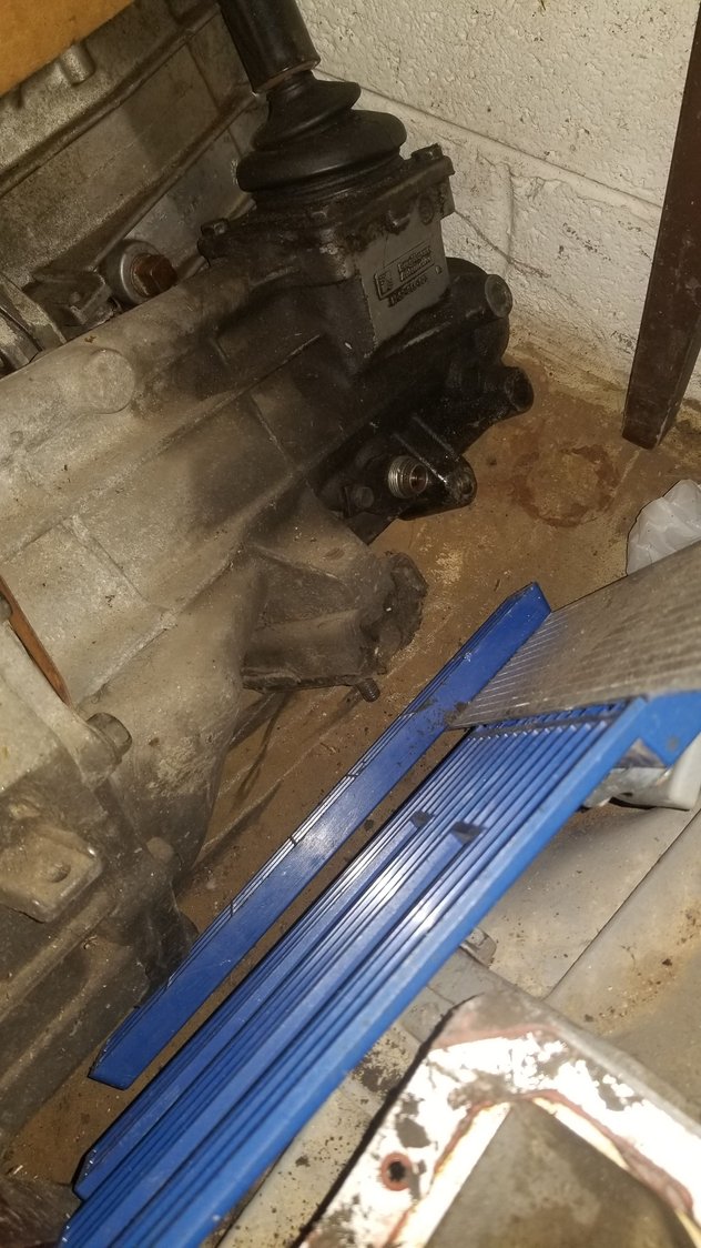

The rear mount bracket.
On my workbench, I measured the rear mount pad of the T5 when it is level. The pad is off horizontal by 18 degrees. I have seen members in other threads that fabricated a canted bracket for the rear... that seems pretty easy as well.
However... and I THINK, if I am reading correctly, that some members are saying the T5 will not immediately fit and the corvette cross member needs to be made removable to get the T5 in ?!?!? Is that correct ?

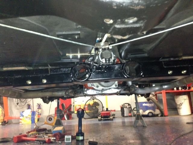

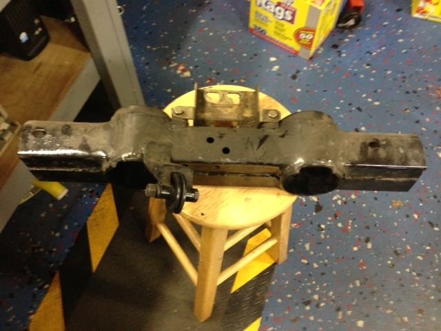

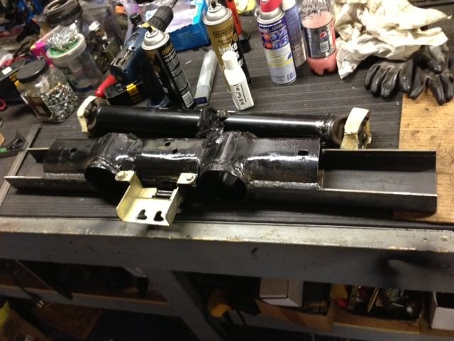

After extensive reading, it seems like the job can be done with a lot of twisting turning and lifting and colorful metaphors in exchange for not modifying the crossmember to be removable.

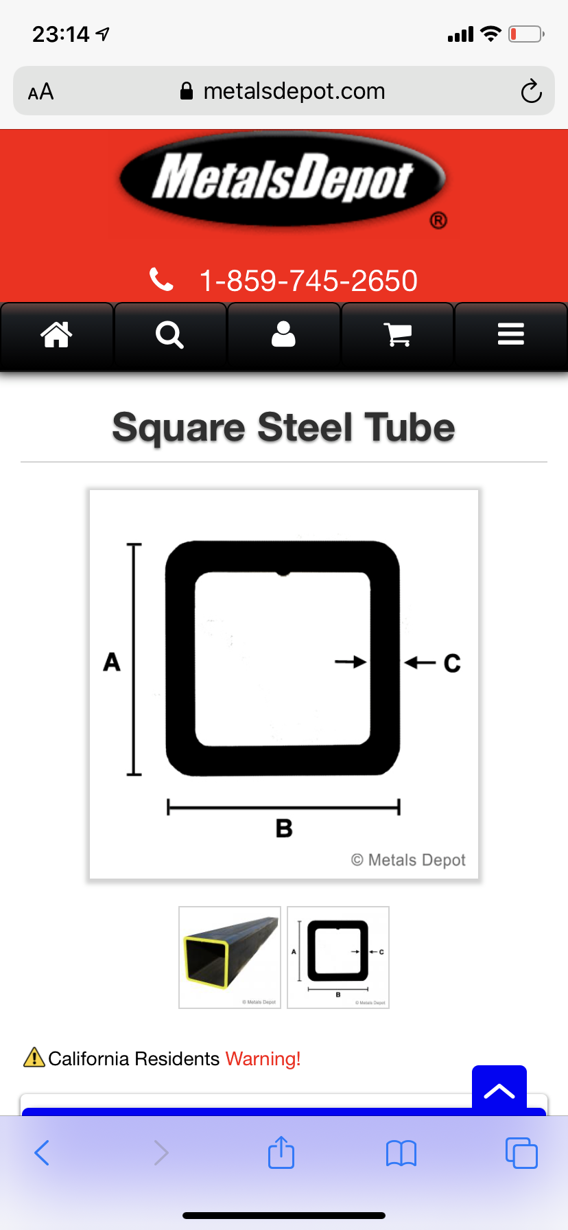

On the other hand, some square steel tubing looks like an easy thing to do.
Grateful to the fellow who came up with this solution

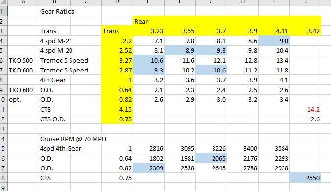

Here's a chart I made up to help find the sweet spot with an overdrive trans. My goal was 9:1 or 10:1 in 1st, and 2000-2300 rpm at 70 mph cruise. A couple of combos work. I like the 2500 rpm cruise of my CTS stick, and that rpm could be a little less with V8 torque. I don't think I'd want a carb V8 much lower than 2300, but it might be fine with modern fuel injection and/or a milder cam. Mine's not that mild. I know, the new vettes cruise way lower than that, but I don't have a new vette, mines a half century old

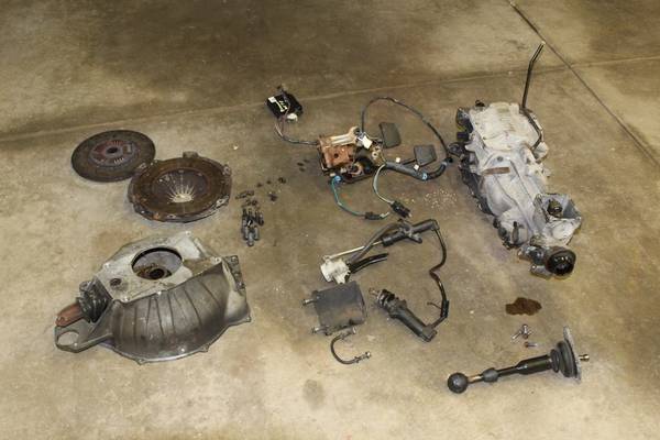

I got a bead on another T5 from a 1991 RS Camaro. It is a 1352-196 with 90K on it. it should have a 2.95 first and a 0.63 fifth.
It comes with a floor pan cutout with boot and all this:
I am thinking I should be able to use the bellhousing and hydraulics. Worth a try ?
The clutch disc is smaller than mine but, AFAIK, that is not a problem. I think it will work with my 168 flywheel and pressure plate.
The pedal assembly might have some brackets and bits I can re-use. I wonder if I can get the trans mount + brackets...
Any additional thoughts ? The speedo will need adressing because electric.
It should be a straightforward install, no ?
I think I am reading that I will need his pressure plate to fit under this bellhousing. I think his flywheel is a dual pattern 168 tooth. Hmmm.

is that your crossmember? or pics of someone else's? if doing it that way, cut out the tops of the exhaust holes. with a full beam across the bottom you will have plenty of strength and no longer have to remove exhaust every time you get underneath. what rear do you currently have? and how much more is it to buy a US trans and get it shipped over to you? here is the adapter for S10 trans to our bell. https://www.ebay.com/itm/S-10-T5-ada...oAAOxyfSpSTqmX the input shaft cover is diff size on mustang trans but i am pretty sure you could use your V6 cover on the Mustang trans. or this may be the adapter/ https://www.ebay.com/itm/Bellhousing...sAAOSwfu9dfLr3
or you could put your trans into this correct case. https://www.ebay.com/itm/T5-WC-Trans...UAAOSw241YZu5-
That is someone else's solution with the cross member.

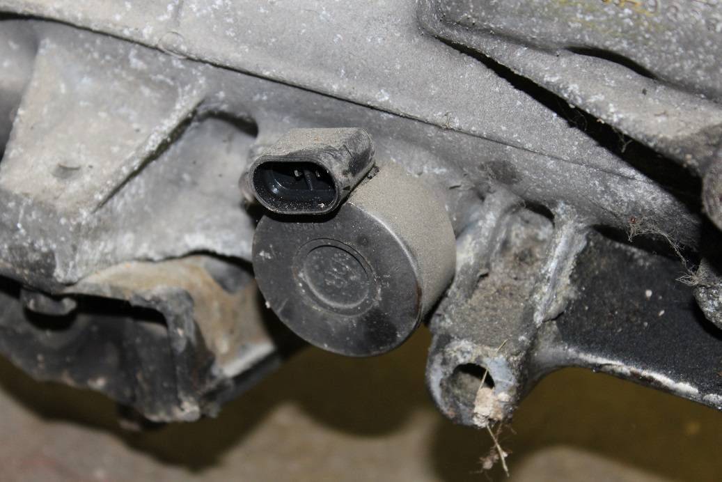

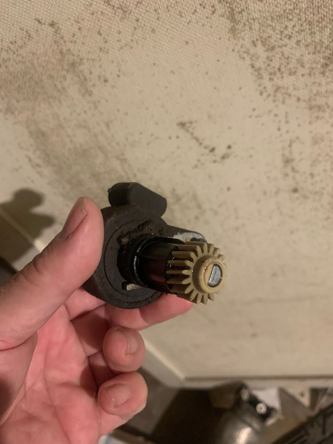

This is the speedo out. Not correct for a 196 ?

that looks like a cable speedo setup with an electric speedo conversion. i could be wrong. i was SURE ll 88-92 camarobirds used cable. my 88 trans 176 code does. is your v6 trans electric speedo? My 176 code speedo output.

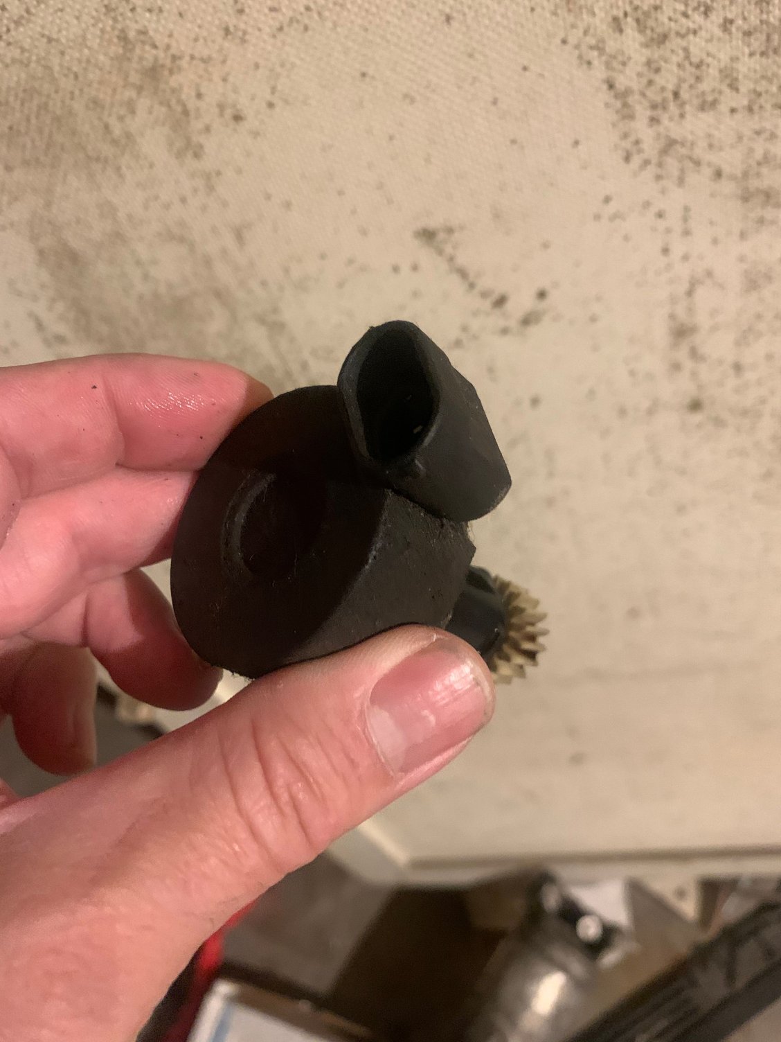

This is what was on my 1991 Cambird () V6 T5
