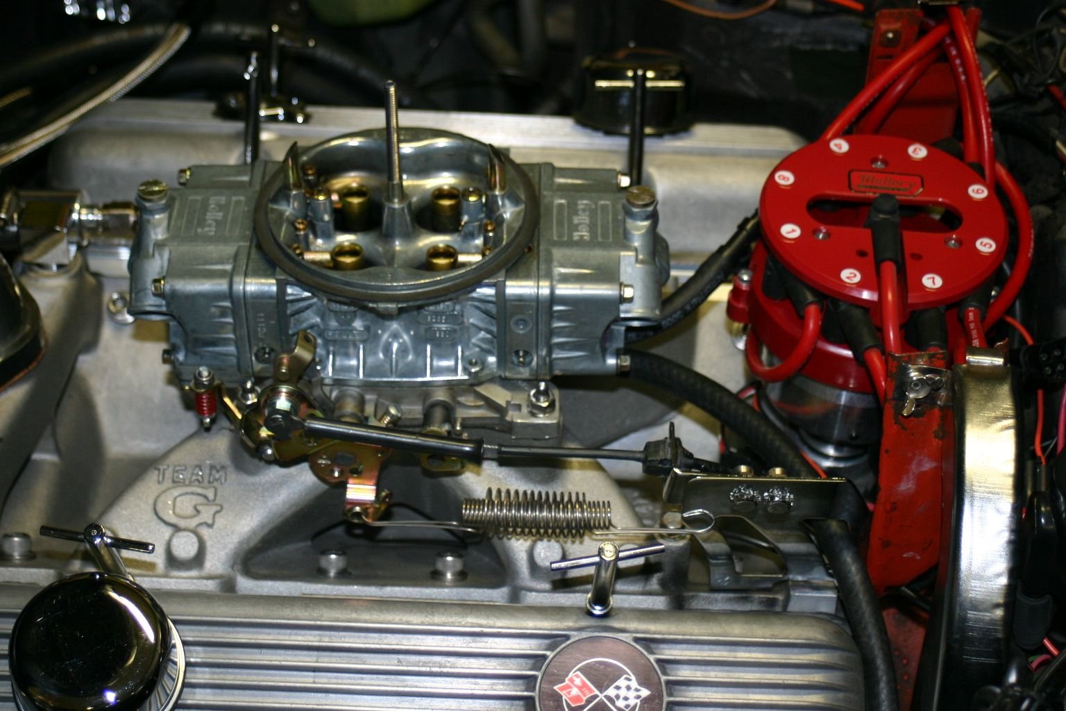

Weiand Team G 7530. It has a low 4" pad height. It will work for your setup.
And with a 4" tall filter that fits under the stock '76 hood.

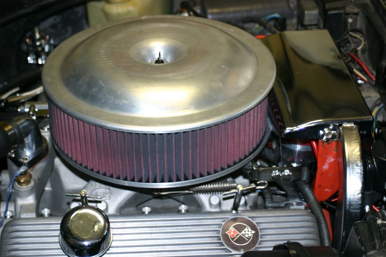

For example my original Cowl Induction Air Cleaner 2-Snorkel Drop Base has a dropped distance of about -13/16” from the carburetor neck flange to the flat of the filter area.
The 14” Chrome Drop Base Air Cleaner that I currently have has a dropped distance of -1-7/32” from the carburetor neck flange to the flat of the filter area.
This sits 13/32” (almost 1/2") lower than the Cowl Induction Air Cleaner base.
So there is something gained by searching around for different air cleaner bases.

Your OE GM intake PN 12496822 is an "Air-Gap" type design ... also like super victor
Your OE fast-burn heads should have a dual-pattern intake mounts, so Either conventional or vortec pattern intakes should bolt up.
above-suggested Weiand 7530 is 4.1" and could do well for you, as well as two more you might also consider.
If 7530 fits your fast-burn port openings, that would be my pick as well.
https://www.summitracing.com/parts/w...0wnd/overview/
edelbrock victor Junior PN 2975 is about an inch shorter at 4.58" ... still has single plane (better for EFI) but still has an air-gap.
https://www.summitracing.com/parts/edl-2975/overview/
edelbrock Torker 2 PN 5001 is about another 1/2" shorter at 4.08" ... and is single plane ... BUT ...
... BUT ... it has smaller port openings, so it may Not properly cover fast-burn heads' intake ports .
https://www.summitracing.com/parts/edl-5001/overview/

I have no idea. The drop base I'm using is an Allstar unit with a 1-3/4" drop.
