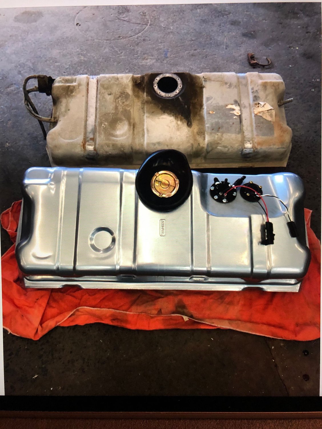

Originally Posted by Runningwild
new in tank high pressure fuel pump. We used the original fuel neck.
Can you please post a photo of the pump installed?
So, do you mean that the tank is filled thru the pump body?

High pressure fuel pump was installed in the fuel tank
