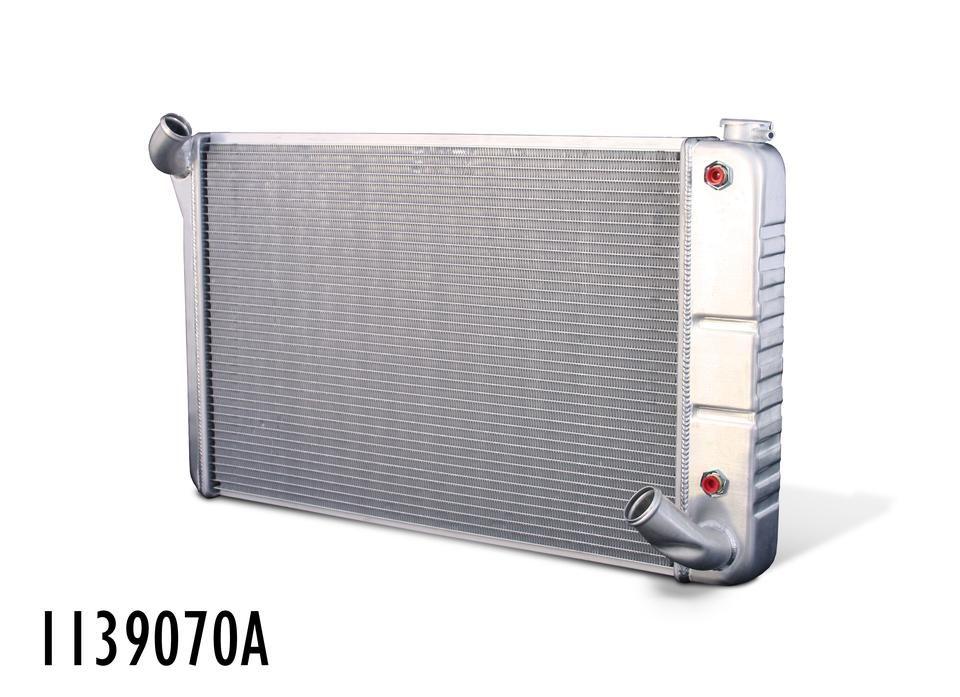

I just finished the install my 427 into my original small block 72. My question is about the radiator. My car was a no ac manual car so I have a dewitts aluminum radiator with their fan combo. I drove the car today and the temps were around 210. Now it was a cool day with temps in the 60’s. Just curious if this will work or not in the summer.

I'd like to know which model SB radiator you are using. I see the surge tank, so is this the smaller 22.5 wide? What are you running for coolant? Ratio? Someone already asked, but are are you sure 210 is 210?

I am using your 4239063M fan combo. I am using 50/50 Peak antifreeze. I am going to using my temp gun to make sure it is correct. I know the gauge is and it was right on with the small block. Will your 4239026M work with my pins in my current small block support and also cool better then what I currently have?

The 26M would fit and cool better but I'm not convinced you need to go there yet. A couple more questions....When you say 210 on a 60 degree day, what speeds are you driving. What I would like to know is idle and under 30 mph versus highway speed. I do not believe in the theory that big engines or big HP for that matter mean that the motor has to run hot. I have a 2016 Z06 (650 HP) that runs the same temperature no matter what the outside temperature is. Why? Because I never pull 650 HP and neither are you just driving around town.
If you used a different temperature sending unit when you switched engines, the gauge may not provide the same reading as before. Replacement switches are notorious for reading high if they exceed 180. Either re-check this new one or put the old one back in. High temperature at idle is usually the engine timing and ignition mapping. High speed problems are usually radiator deficiency.

I have the Dewitts small block (with ac) radiator in my 71' with a 700hp iron head big block and it never runs over 195*, in the middle of a 95* day with the AC on full blast. On average, I run 185* at cruise or at idle with the AC on, on a humid, 95* day. My point is the Dewitts SB radiator that fits the 71-72' core support is plenty. (27" core). If its running 210* on a 60* day, going down the road, then you have something else going on. I run a 160* thermostat, and on a 60* day it will sit right on the thermostat at cruise...160* all day long.
I'd be looking closely at the timing, thermostat, water pump, and even the fan clutch.. etc etc.... Your combo with the 180* stat should be running no more then 190* at cruise, especially on a 60* day.
I'd go in this order:
1) Verify the temp with IR gun or a good mechanical gauge
2) Verify the thermostat is opening at the correct temp and opening fully.
3) Verify timing and vacuum advance operation. Definitely run at least 15* of initial timing...more if you can squeeze it and still keep your total timing at 36* or so.
4) Check water pump, lower radiator hose, core support seals, lower air damn, fan clutch
5) Also, if you are running stock manifolds with the heat riser, make sure the riser is functioning properly and not stuck partially closed.

Your SB radiator is different than the OP. You have the 26" core, SB air radiator
and he has the no option SB manual 18"
Plus the 16" fan.
